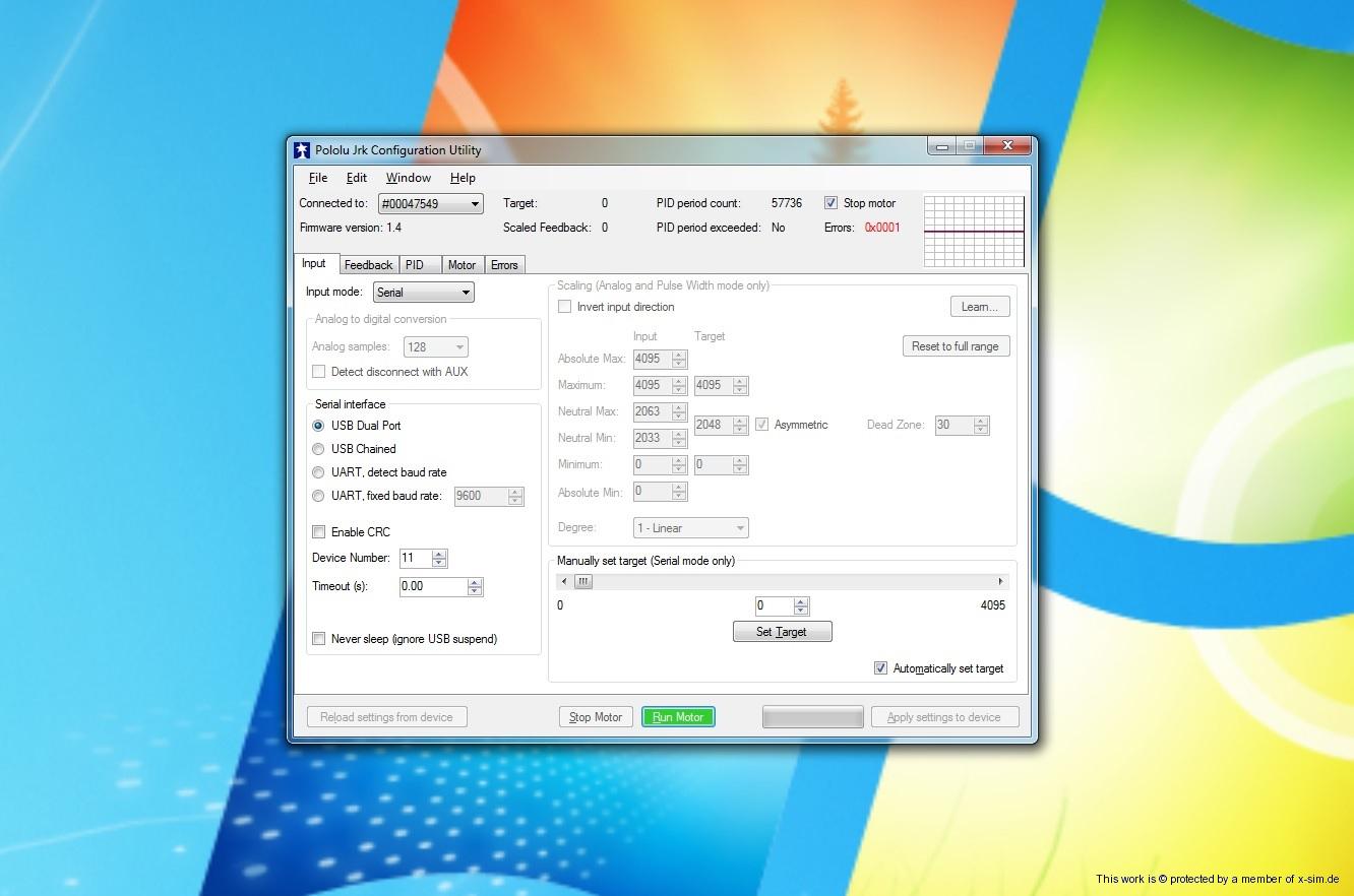

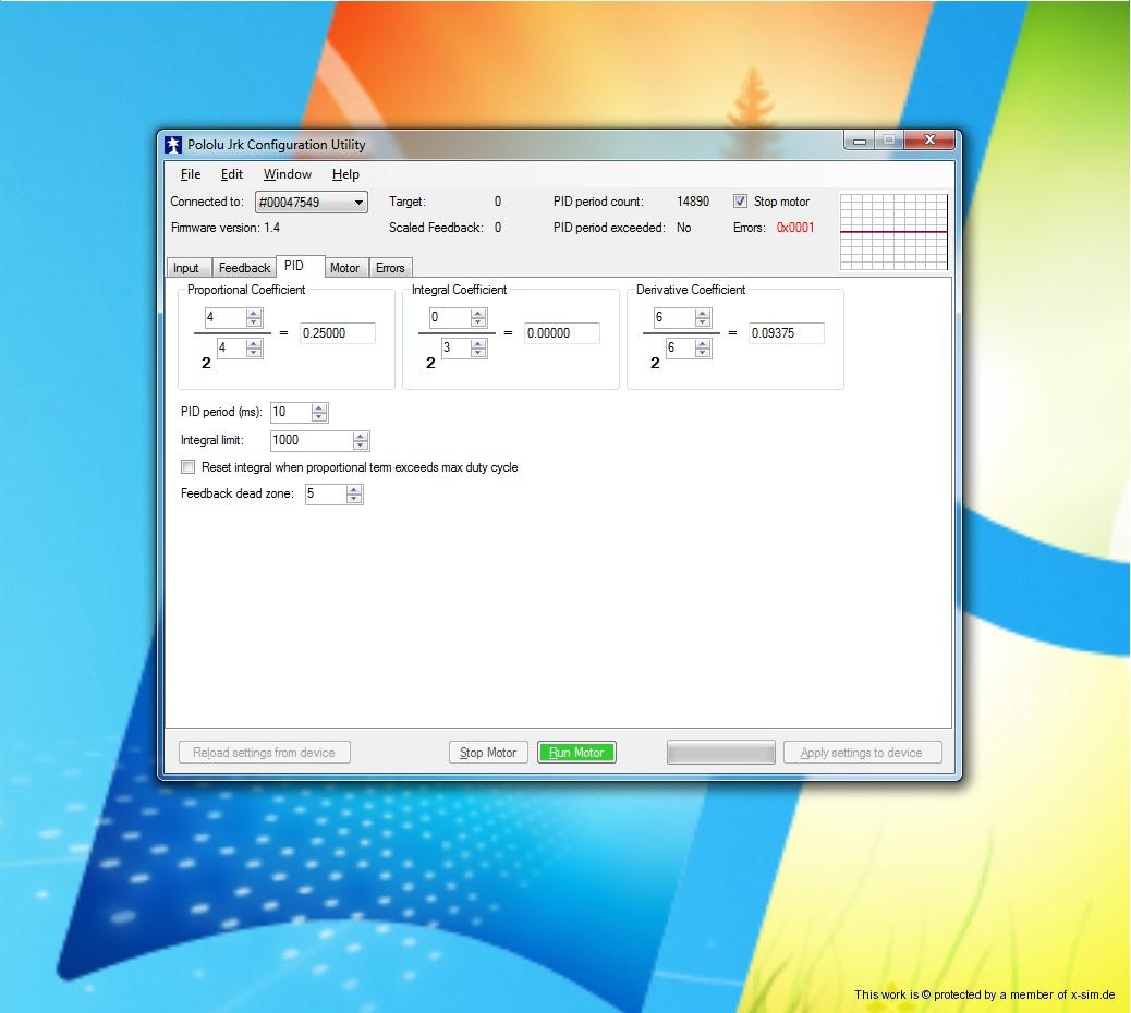

Ok so I made up some new cables to the pots with shielded wiring. I soldered the ground wire and braided shield together on the jrk side of the wire. The feedback is better now but still shaky and not what it should be. Here is a video and some pics of what I have going on with the JRK utility and motor feedback. Whats the best way to set the feedback Max and Min on the JRK utility? Maybe I'm doing something wrong there and loosing my feedback range. 2179217821772176

Check the "Feed back" and "Target" plot in the JRK utility. Both should be reasonably smooth. Look at the "Target" The plot should not show big steps.
If it does you may have a resolution problem and the JRK is trying to jump between Target steps. what happens then is the motion control tries to chase itself as it jumps between "Target"steps.
These problems are so variable between all the sims that we make so it can take some individual experimentation to get things right. What works for one may not work as well for another.
Lowering the Motor Acceleration will help smooth things also.

On screenshots everything looks OK..
Have you check in JRK Utility if you're receiving some errors? feedback error or motor driver error?
In the graph monitor where red and blue lines are, are they moving simultaneous together when motors are working?

If my PID settings are low then that's when I'll get a motor driver error. But there are no errors the way I've been using it. I'm going to try different computer tonight just to see if that has anything to do with it. The motors and feedback are all over the place and it shows in the graphs. The blue line is steady but the red line is all around it trying to find it. Everything should be smooth when I'm sitting in the seat. I've had the motors running nice and smooth but It's never both at the same time. Only one side works great and the other one shakes the hell out of you.
