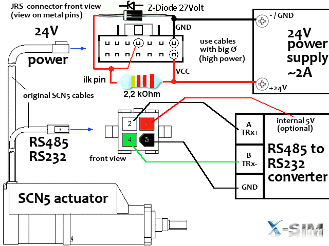

we tried to build our own SCN5 based simulator. We have connected everything according to this scheme, only without Z-Diode and resistor, and we made our own SCN5 cables:
In Windows 7, we got only one COM port detected on the RS485 device:
After doing hardware rescan in X-Sim, we got either no found outputs at all, or in about 20% of rescans, we got found one of actuators:
However, after opening settings, we can't change any of options:
What do you think we have done wrong? Is the Z-Diode and resisor really needed for normal operation, or is it just for safety reasons?

As told you in the SCN threads: what do the debug mode tell you?
