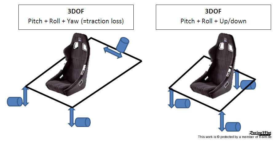

hello !
What kind of design are you thinking about ? what DOFs would you select ?
1557
1920
RacingMat
Posts: 456
Images: 147
Location: Marseille - FRANCE
Been thanked: 130 times
Re: my 3dof setup
Postby RacingMat » Thu 25. Jul 2013, 18:11
3 DOF = Pitch and Roll and Yaw (yaw = traction loss)
- like Yokoyoko http://www.x-sim.de/forum/viewtopic.php?t=289
3 wiper motors + polulu 12v12
finished !
- like PiezSim : photo gallery http://s1066.photobucket.com/user/PiezSim/library/Traction%20Loss%20Upgrade?sort=2&page=1
3 electrical actuators
- like Faro06 : photo gallery http://s536.photobucket.com/user/faro06/library/Motion%20Sim?sort=3&page=1
- like Hmaia concept http://www.x-sim.de/forum/viewtopic.php?f=12&t=684#p4914
in progress...
- like vittobrambi with "free" 360° rotation http://www.x-sim.de/forum/viewtopic.php?f=38&t=270#p1568
http://www.youtube.com/watch?v=MGFHFq1Swpw&feature=plcp
3 DOF = Pitch and Roll and Elevation
- like stephaned61 http://vos-playseat-stephaned61.xooit.fr/t124-Simulateur-3DOF-de-stephaned61.htm
3 Wiper motors + Vellerman140 + Sabertooth
moving only the seat
in progress...
- like SimTxus with his tri-pod ... in progress http://www.x-sim.de/forum/viewtopic.php?f=37&t=252
- commercial : like 301 force dynamics http://www.force-dynamics.com/301/ or like Riton http://www.x-sim.de/forum/viewtopic.php?f=37&t=610&start=50#p8021 (in riton's project, there will even be a 4th DOF with yaw)
