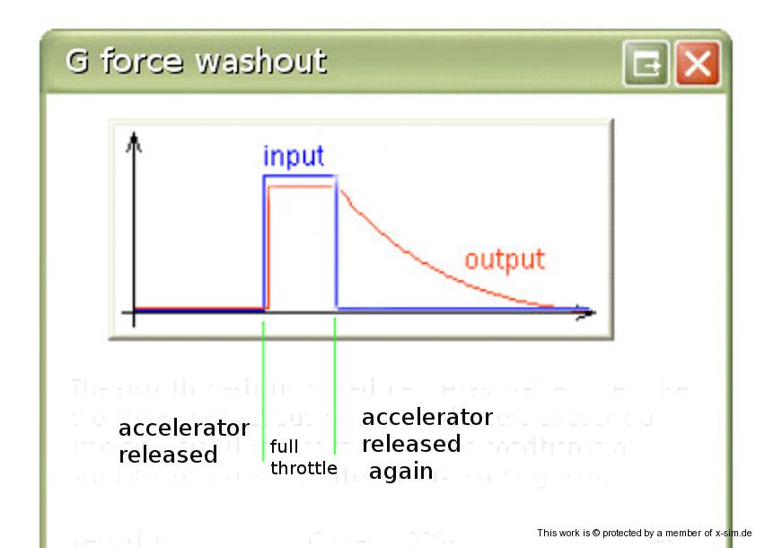

Hello,
I have this request for any c++ programmer. Please write a new math or edit smooth washout plugin (if possible)
3774
The above image I edited the "smooth washout math plugin" (left) tho show what I need (right).
link to the math plugin writing tutorial:
http://www.x-sim.de/manual/math_plugin.html
Please help!!! seriously :o
It (if possible) will take no time I just do not know C++ at all.
My regards!

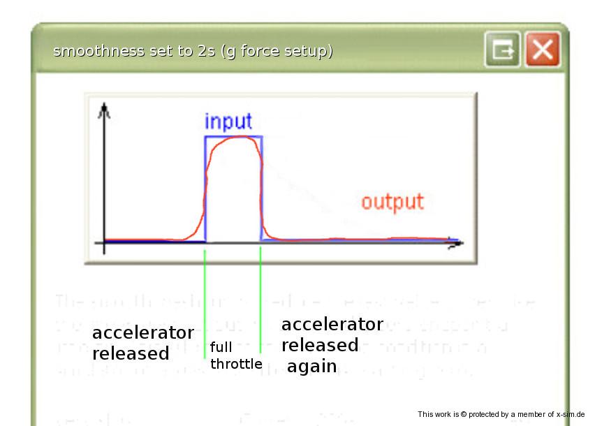

Postby RafBR » Tue 26. May 2015, 02:00
Another example:
3775
And below the workaround I am using, but it does not work in the right way for what I need:
3776

Postby sirnoname » Wed 27. May 2015, 22:38
Hmm, you must multiply after the washout your result, it get cutted and you get such a full throttle area. Use scaler plugin and enter manually 200%. Or add another G-Force and select as input the last math line followed by any of the multiply option. Maybe a 1:1 path through will also work with multiply.
A sine washout is also availabel.
Re: G force washout math plugin request
Postby RafBR » Thu 28. May 2015, 05:30
Thank you very much again,
I will spend some time trying to figure out what you said.
But In the meanwhile, be sure you understand (probably you already did :D ) the 1st picture I posted, that one showing the difference between the available plugin and that one I need.
The need is to make motors smooth move (curve) to zero position allways after forces stop being applied.
I will try it and then back the results here
My regards!
