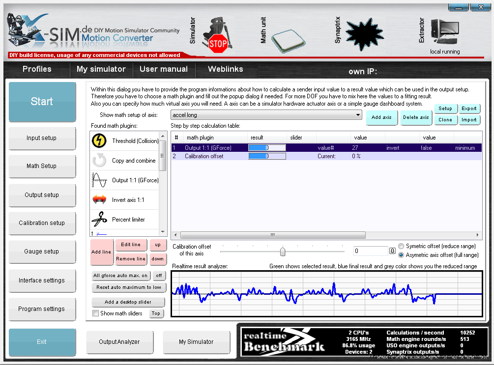

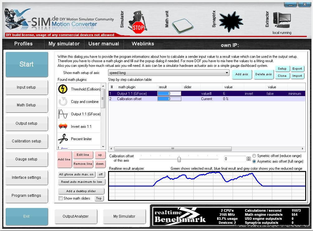

I have tried some more and I may be on to something: I found command buffer 21 (out of 23), position with Y height and look dir Y up.
Filter strength 25, value 1, speed delayed median and accel delayed square. All these while racing from the cockpit view, of course.
The converter math plugin shows this for speed 2413 and this for accel 2412 which are similar to what we find in the Motion Driver Guide but the output doesn't feel as expected. I get some movement but it is not inline with what's expected. Accel and brake don't match at all and lateral movement seems arbitrary. I started with auto-adjustment set-up for forces and went from there.

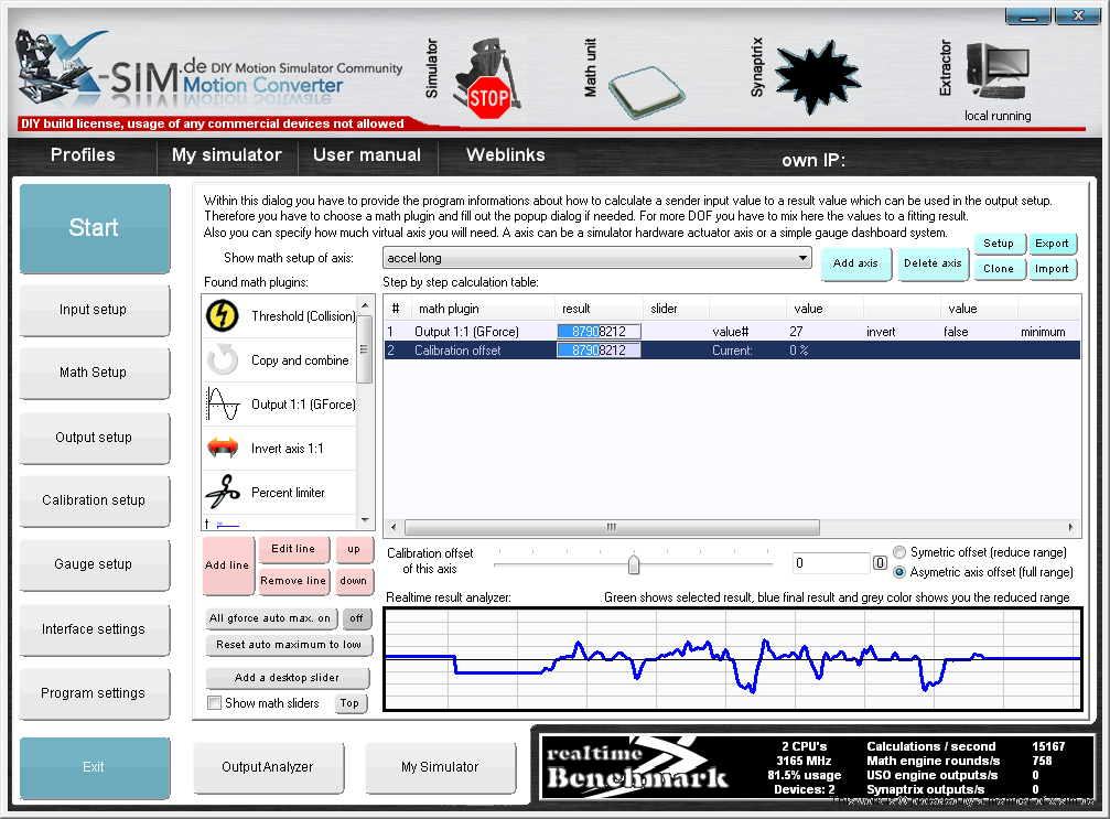

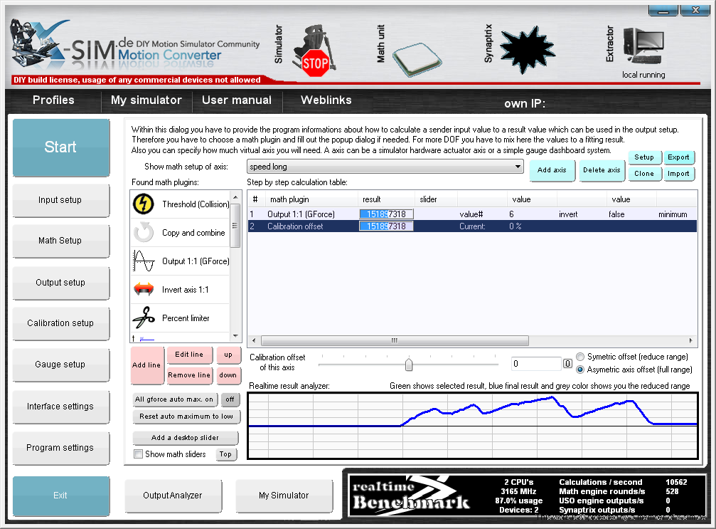

Tried a new buffer (23) with 'reverse search' enabled and this gives me more stable values and also jitter is alot less present and filter strength is 30.
I must say, even if the car is not moving, there are some low value changes reported on position XYZ but I guess that's normal as the car still slides very little (not completely still).
Now I get these for speed 2418 and these for accel 2417
Feeling of the motion is close to what's expected but feels somewhat delayed. Also, due to jitter, I sometimes get some extra shakes from the sim.
