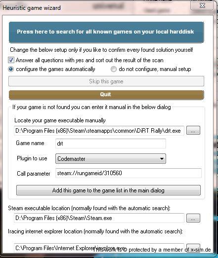

- Start extractor with Admin rights
- Add the game, the auto search doesnt Work for Dirt Rally so i have to manuall add it:
- drt.exe
- as Plugin i took "Codemaster"
- Callparameter: steam://rungameid/310560
Then i Click on right side on Drt.exe and a popup asks me:
"Codemaster, There is a official game plugin detected for this game executable.Do you like to activate/change this Plugin in the motion driver dialog?"
-> YES
Automatically Setup?
-> YES
as input i use my G25, than i create a Profile.

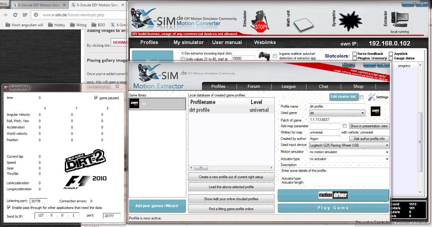

Now we are Ready for a first Start, in the Extractor i Hit "Play Game" and a woman says "Game detected"
When i drive i change to Converter and start, and look at the inputs, but the values for speed/gear arent changing.
the window "outsimDirt2" is always "Game Paused" and the values are all zero.
the Window Says: Send to IP: 127.0.0.1 port: 20777
and Listening Port: 20778
I dont know where i have to search my error. What Means Listening port? Do i have the Right Plugin? A lot of Codemaster Games use LiveforSpeed, but with this Plugin it also failed. (also changed the ports). Do i have the Plugin manually?

After 8 Hours sleep and look from the distance i got it working.
Solution for all Dirt Rally Player: You have to change the Port in the XML File to 20778.
