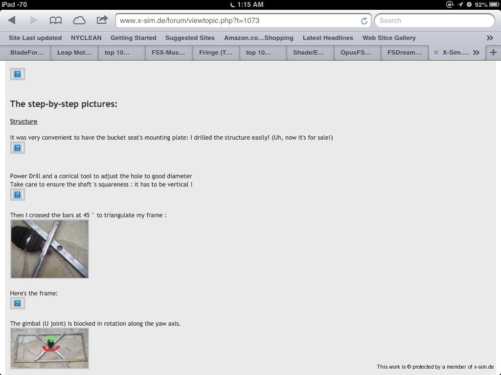

Postby Hesynergy » Fri 28. Jun 2013, 07:34
RacingMat wrote:Hi Chas ! Thanks :-)
What do you mean by missing ? Sometimes on xsim forum, you need to click on "numbers" in order to make the images appearing ?!
This is what I see on my iPad
1709
Just thought you Would like to *.. By the way what is the load limit/payload/maximum weight for your Motion base?
Thanks,
Chas
Hesynergy
Posts: 3
Joined: Wed 13. Jun 2012, 07:26
Postby RacingMat » Fri 28. Jun 2013, 09:48
I'm 75kg and the playseat has worked well even with a 85kg pilot ! no problem
if the load was to be heavier, you should just reduce the lever arm length : -10mm for example
(for the pictures, it's a functionality of the forum : you should contact by PM an administrator)
