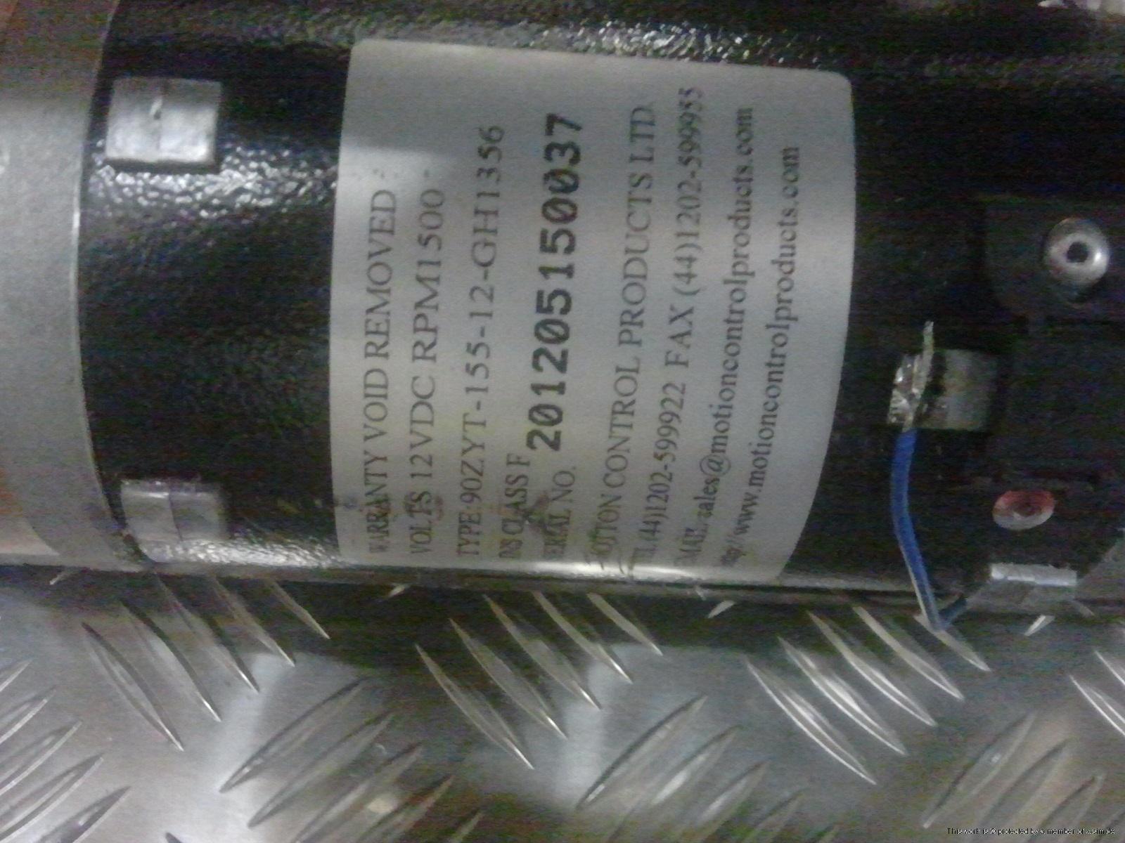

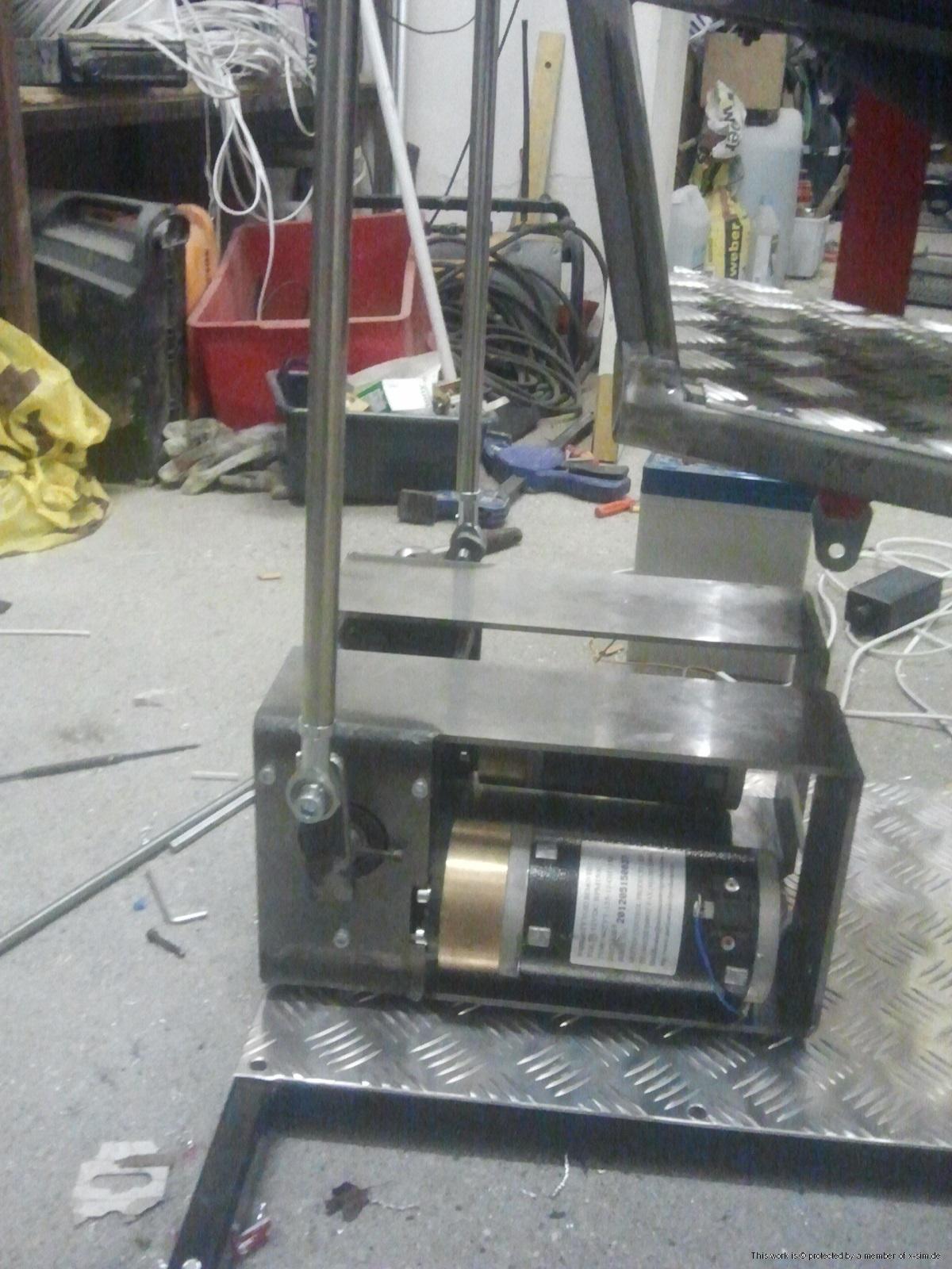

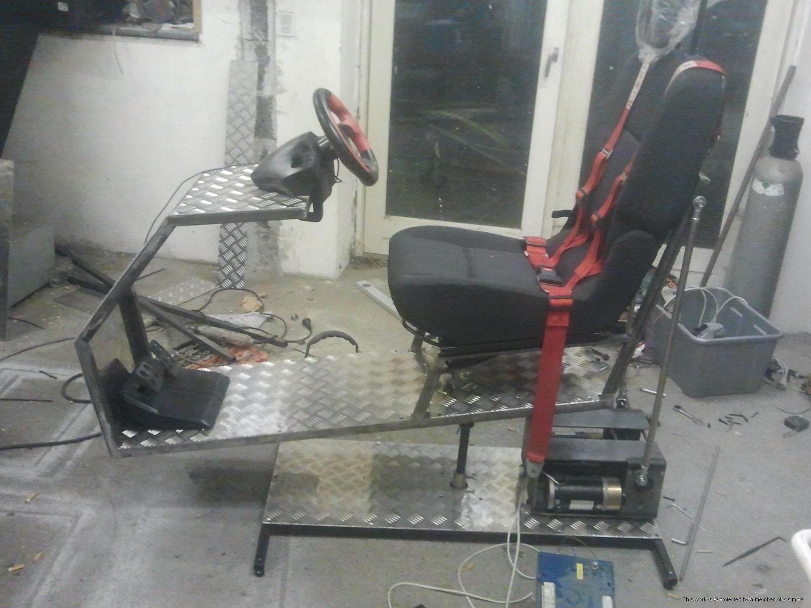

Postby postsol » Mon 30. Dec 2013, 22:33
help iyour great ardurino gods
I started to build this marvel of a sim
2395
2397
but I instead of a window wiper, I have purchased and installed the motor
90ZYT-155-12-GH1356 with 1 to25 gear
2396
I also bought DBK-HT motor driver. but they blew up :-(
but I'm considering buying RoboClaw 2x60A Dual Motor Controller
but I do not know if they can hold it.
it's many many times up and down as it should withstand
plus I also do not know what pins I should use on ardurino to control pwm signal
on externally equipment.
ardurino? = in1_L
ardurino? = in2_L
ardurino? = in3_R
ardurino? = in4_R
ardurino? = en_L
ardurino? = en_R
pls help a novice in this big world :-)

Postby RacingMat » Tue 31. Dec 2013, 13:21
Hello Postsol!
You're in now! Congrats, nice weldings!
If you want some help, you will have to give us the specs of your driver: how is it awaiting PWM and Direction information?
and on how many pins? 1 or 2...
