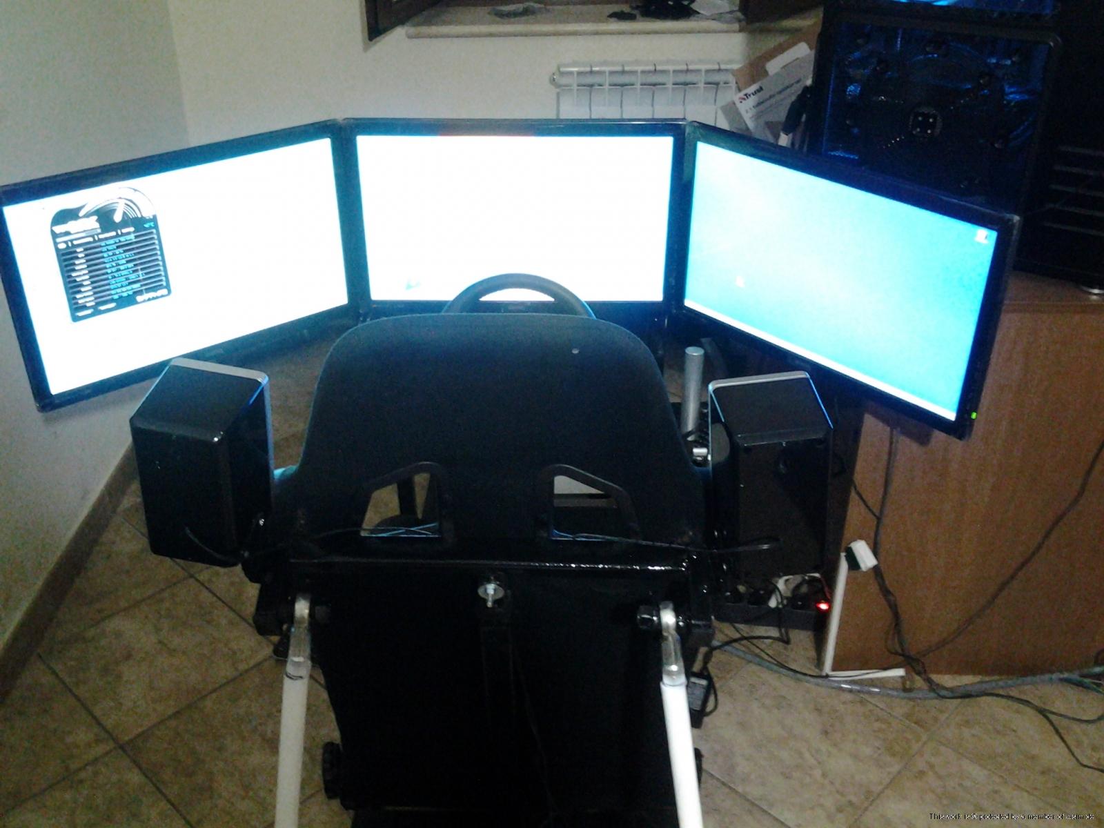

Re: K8055+Saber 2x12a gaevulk motion sim 2 dof
Postby kevin123 » Sat 7. Sep 2013, 13:25

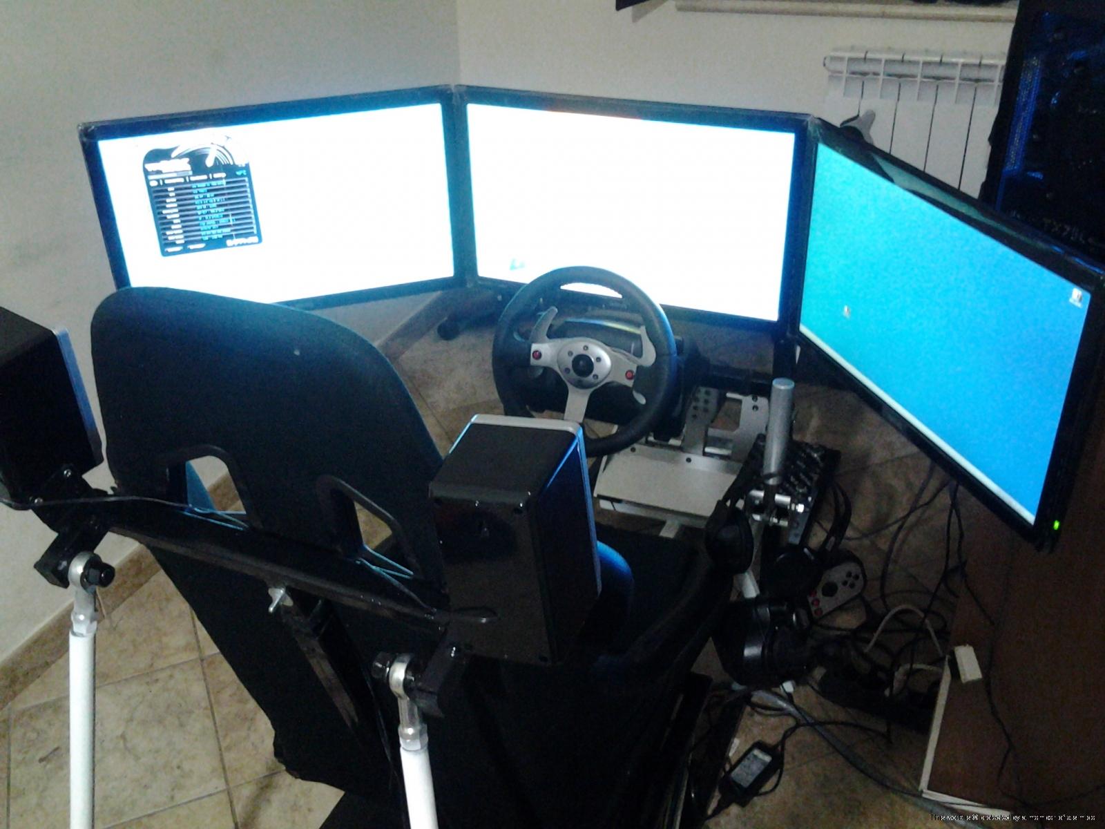

Ciao gaevulk
Man mano che vai avanti vedo che stai facendo un bel lavoro complimenti ;)
Volevo chiederti i 3 monitor che hai messo quanti pollici sono?e quanto li hai pagati se è possibile
Ps: Lo schema elettrico che hai messo mi sembra di averlo già visto da qualche parte :mrgreen:
Hello gaevulk
As we go forward I see you're doing a good job congratulations ;)
I wanted to ask that you put the 3 monitors how many inches are? Them and how much you get paid if you can
Ps: The wiring diagram that you put it seems to have already seen somewhere :mrgreen:
Postby gaevulk » Sat 7. Sep 2013, 13:40
hello kevin, the monitors are the benq GL2250M in Italy costing 159 Euros, 109 Euros on amazon.de, they are 22 inches, yes yes, the schematic and 'just what your
thanks for the compliments ;)
Postby kevin123 » Sun 8. Sep 2013, 12:47
gaevulk wrote:hello kevin, the monitors are the benq GL2250M in Italy costing 159 Euros, 109 Euros on amazon.de, they are 22 inches, yes yes, the schematic and 'just what your
So they would pay 330 euro on amazon and would also be a good price
Since I am not yet convinced of the triple monitor because I wanted to put a 42-inch wanted to ask you how you are? the lines in the middle between the three monitor does not bother you?
Postby gaevulk » Sun 8. Sep 2013, 13:33
absolutely not, no problem, do you think I come from a Asus VG236H 3D Vision kit and gaming and this' just another planet

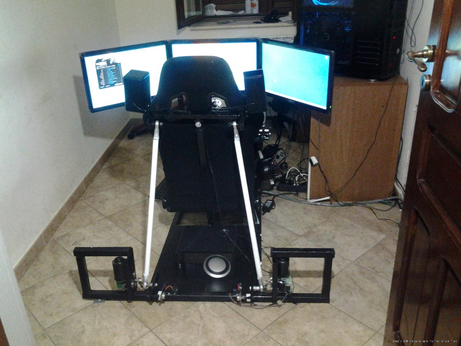

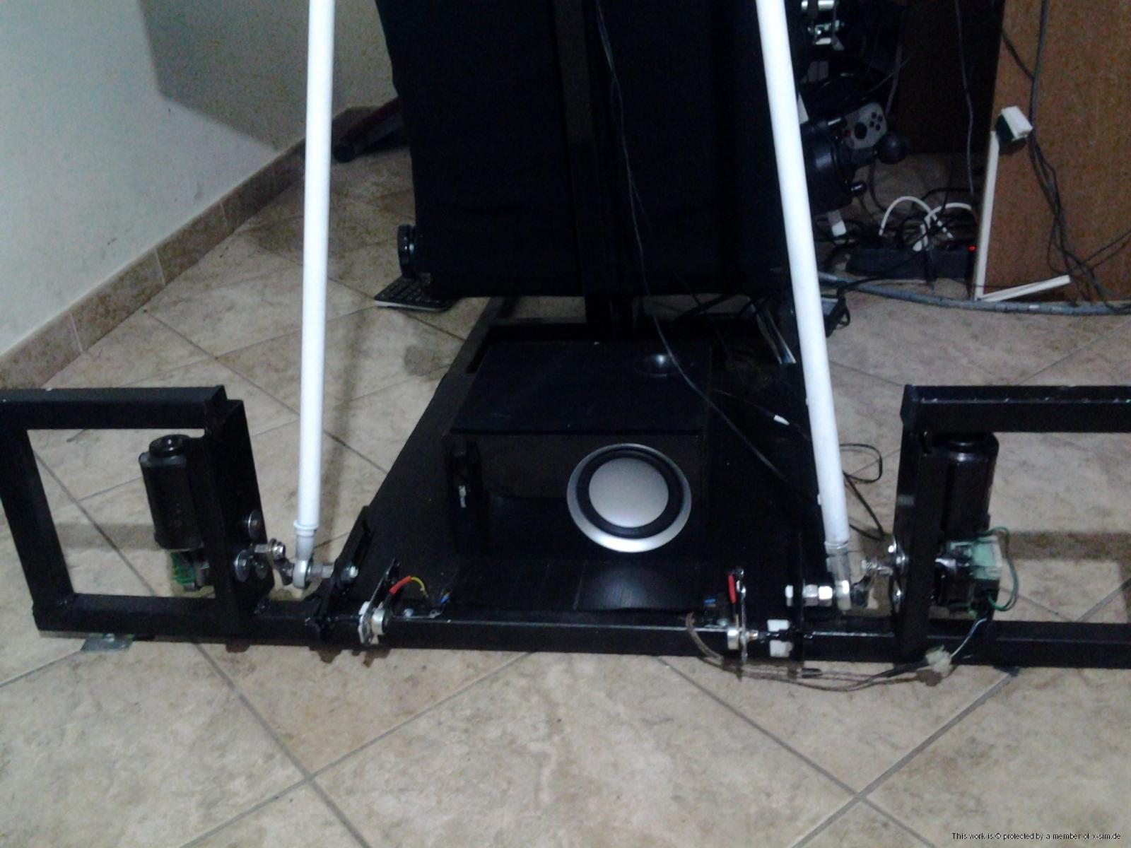

Postby gaevulk » Sun 15. Sep 2013, 16:50
I have a problem and I wanted to ask for a hand
I have these settings in the speed value, the speed is in the screen '85% but usually I use 90%, but now' with this setting engines emit vibrations even when stationary, without opening any game just start x -sim, lowering the various parameters vibrations disappear but the engines become unresponsive
I can not understand if it depends on the saber/k8055 or engines are now worn out, I do not know, you say that I could overcome with some changes in the settings?
Unfortunately, these vibrations are beautiful annoying

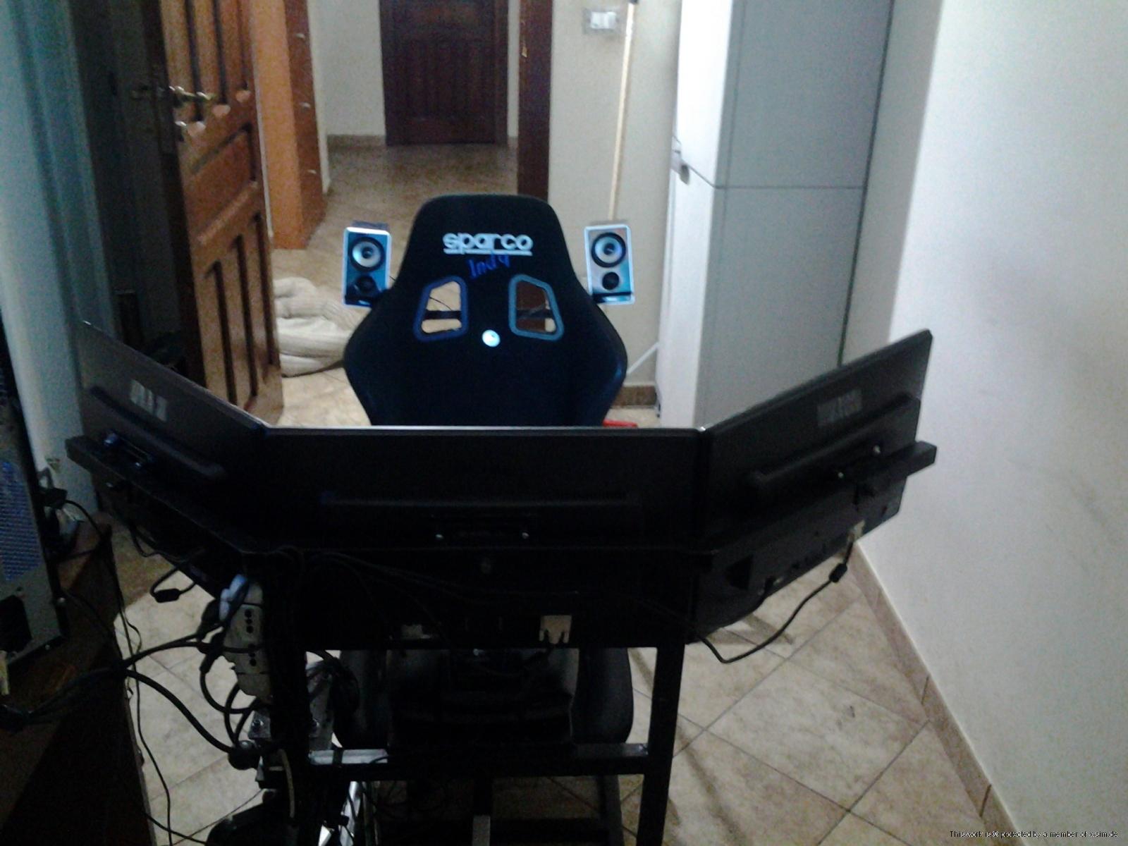

Postby kevin123 » Mon 16. Sep 2013, 19:57
Quindi ti trovi bene con la visione dei tre monitor...io ho un televisore 3d 55 pollici ma e fisso ovviamente e quindi avevo pensato di creare una staffa con i tre monitor che si muovono con il simulatore...dovrebbe essere più realistico ;) l'unica cosa che mi bloccava e l'unione dei tre monitor le due righe nere per intenderci.
Grazie
So you feel comfortable with the vision of the three monitors ... I have a 55-inch 3D TV but obviously fixed and so I decided to create a bracket with the three monitors that move with the simulator ... should be more realistic; ) the only thing that stops me and the union of three monitors the two black lines so to speak.
Ti rispondo anche qui per il tuo problema
Ciao gaevulk
Queste vibrazioni ai motori le senti anche con altri profili?
Io lo speed dinamic lo uso al 100% e non fà alcun tipo di vibrazione solo quando parte il gioco vibrano però quello e normale simula che l'auto e in moto. Può essere che dipenda dai potenziometri io ho messo quelli di precisione... quelli che avevo prima mi davano problemi erano troppo sensibili.
Prova ad abbassare anche Pid control e parti da 1 a salire e vedi che reazione hanno i motori non sò a che serve (non ho mai letto il manuale di x-sim :oops: ) sò che se aumento i motori hanno reazioni più violente
Hello gaevulk
These vibrations to the engine feel even more profiles?
I use it dinamic speed to 100% and does not make any kind of vibration only when part of the game, however, that vibrate and normal simulates the car and motorbike. Maybe that is I put those potentiometers, precision ... the ones I had before gave me problems were too sensitive.
Try lowering Pid control and also parts 1 to go up and see what reaction they have the engines do not know what good (I never read the manual of X-SIM :oops:) I know that if I increase the engines have most violent reactions
kevin123
Posts: 196
Images: 132
Location: Italy
Has thanked: 15 times
Been thanked: 11 times
Postby gaevulk » Mon 16. Sep 2013, 22:44
ciao kevin ,penso il problema sia uno dei motori,premetto che ho provato il motore "sospettato" nel connettore del motore buono e fa la stessa vibrazione,la voce che io setto per diminuire queste vibrazioni e' proprio il pid,se imposto "use proportional term kp" su 3 le vibrazioni si annullano quasi del tutto ma i motori diventano lenti,impostando questa voce a 4 diventano molto reattivi ma spuntano le vibrazioni ,un altra cosa che ho notato e' che il motore che vibra si scalda tantissimo,inizialmente anche io pensavo ai potenziometri,attualmente ho messo quelli della pedaliera del g 25,dovrebbero essere abbastanza buoni,provero' comunque con quelli di precisione,potresti inviarmi un tuo profilo rfactor/iracing da testare?
hello kevin, I think the problem is one of the engines, I state that I tried the engine "suspect" in the connector of the engine good and does the same vibration, the voice that I septum to reduce these vibrations and 'just the pid, if I set "use proportional term kp "3 of vibrations vanish almost completely but the engines become slow, setting this entry to 4 become very reactive but springing vibration, another thing I noticed 'that the vibrating engine heats up a lot, initially I also thought of the potentiometers, currently I put the pedal those of 25 g, should be good enough, I'll try ', however, with those of precision, you may send your profile rfactor / iRacing to be tested?
per quanto riguarda i 3 monitor,io ce li ho fissi ,la riga nera dopo un po' non la si nota per nulla,ed i miei monitor non hanno la cornice sottile,ho provato molte soluzioni fra cui quella con volante e cambio in movimento insieme la struttura ma,preferisco quella con i monitor fissi e volante e shifter fissi,onestamente credo che 2 motori come quelli dei tergi difficilmente reggano tutto quel peso
with regard to 3 monitors, I 've got fixed, the black line after a while' is not known for anything, and my monitor does not have the thin frame, I have tried many solutions including the one with steering wheel and gearshift movement the structure together, but i prefer the one with the monitor fixed and fixed steering wheel and shifter, i honestly believe that 2 motors such as those of the wiper hardly reggano all that weight
grazie mille per l'aiuto ;)
