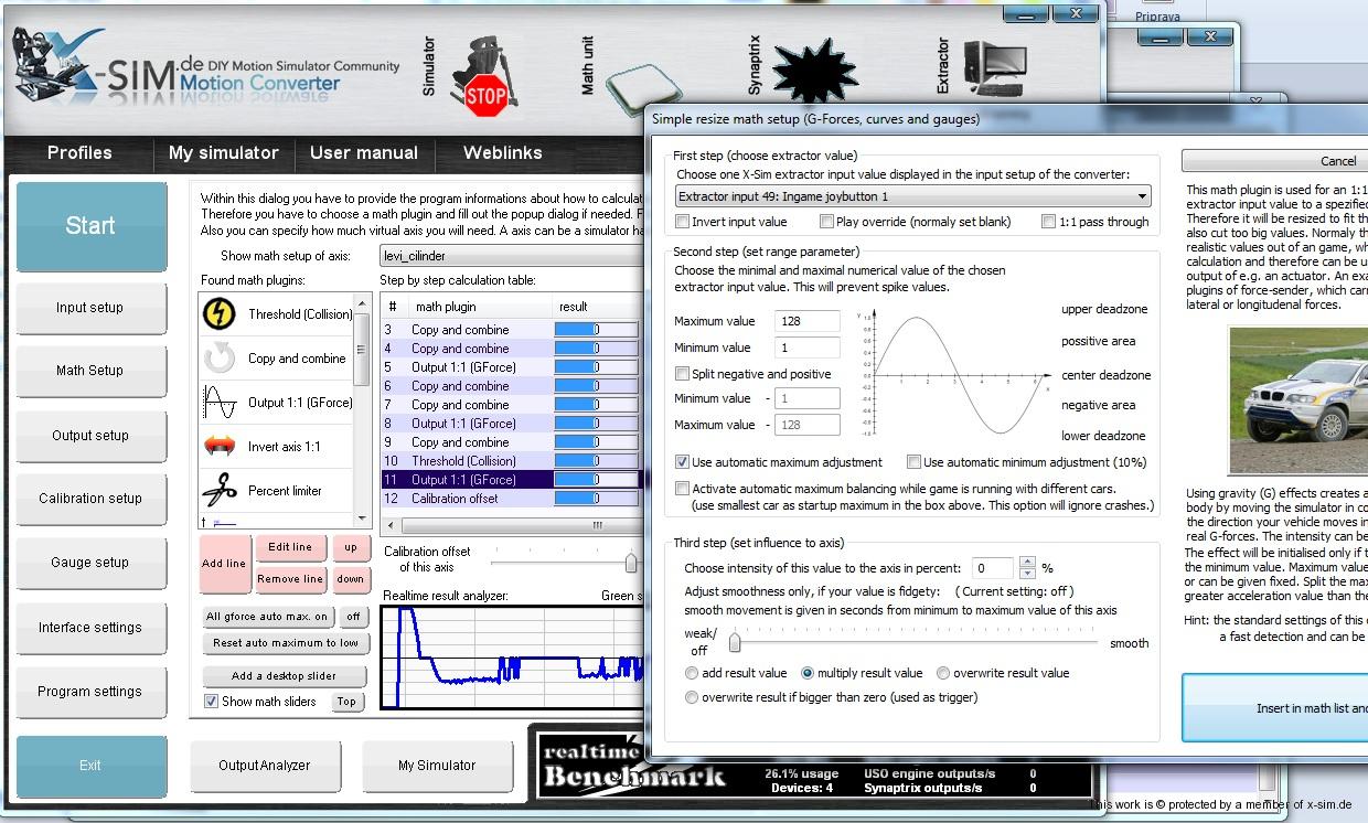

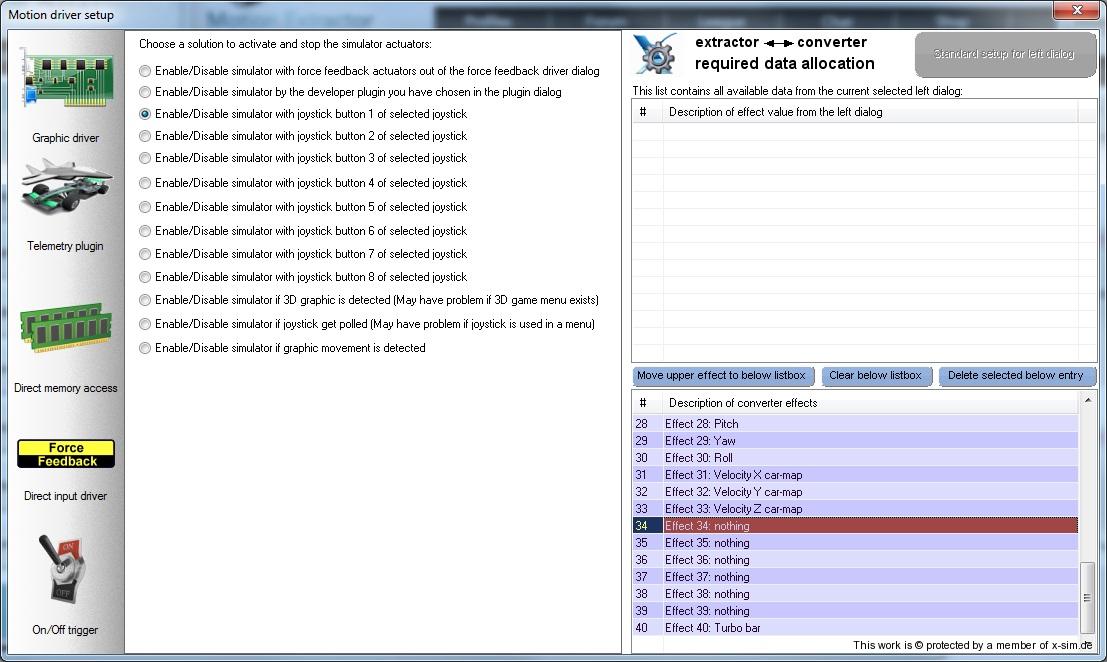

We have been searching for a way to stop our simulator with a physical button instead of the button in the converter GUI.
Sirnoname kindly gave us some pointers here, but we were unable to make it function.
We want to assign the joybutton1 on our g27 wheel for this function. The x-sim software recognizes nicely when the button is pressed but the simulator doesn't stop. Could anyone with some experience with this function help us please?
1361
Screenshot from motiondriver settings
1360
Screen from math for left actuator
