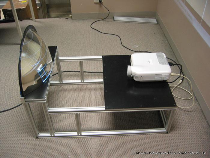

Just my 2 cts, after some searches, I found 3 softwares for warping images :
http://www.fly.elise-ng.net/immersivedisplaylite2
40€
http://nthusim.com/store
289$ single head
489$ triple head :o
http://www.immersaview.com/products
Immersaview Warp is the professional version of Nthusim (no prices found)
or a system with a curbed mirror :
2354
but luminosity seems to be a problem with only one projector on a curb screen...
Some setups here : http://www.forums.nthusim.com/viewforum.php?f=12
