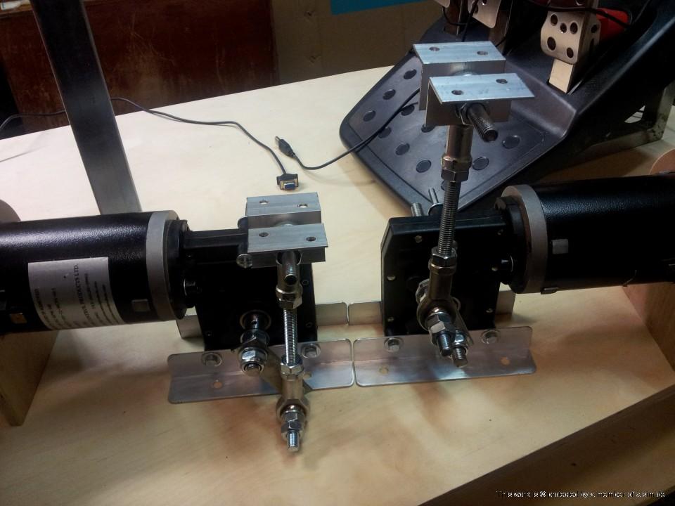

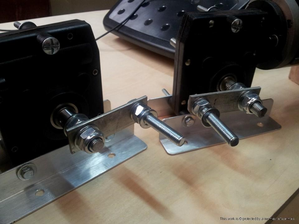

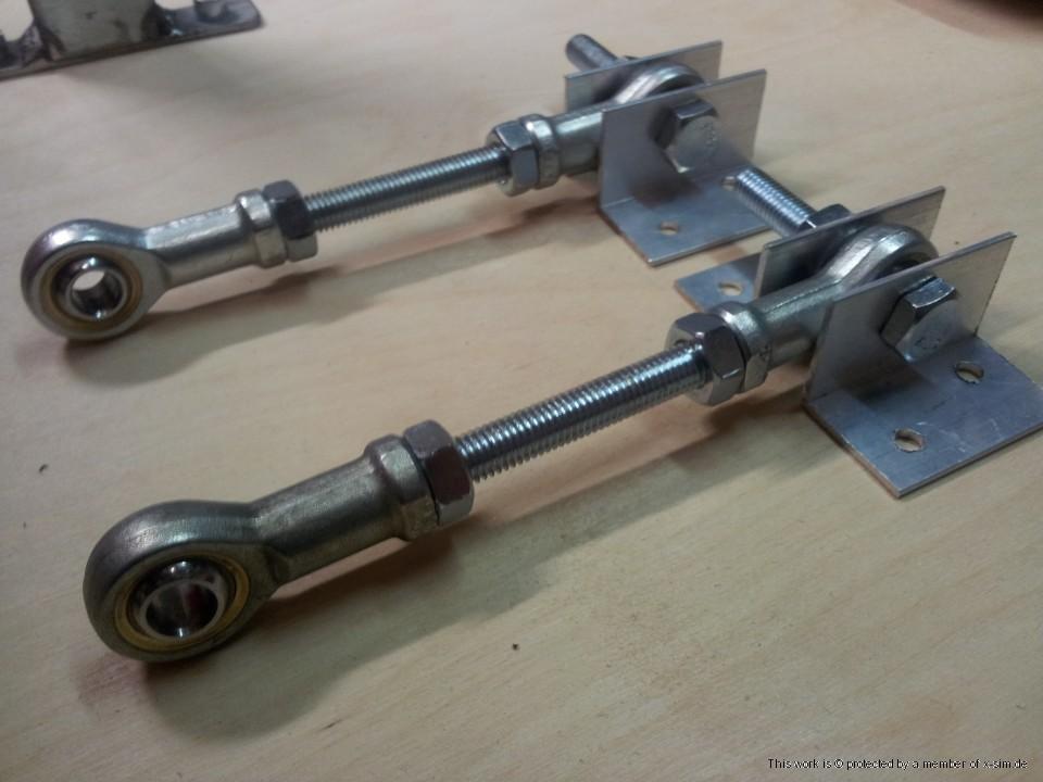

M10 rod-ends and I made some small steel levers on the M12 shaft:
364365
Differs approximately 10 cm in height, must be enough...

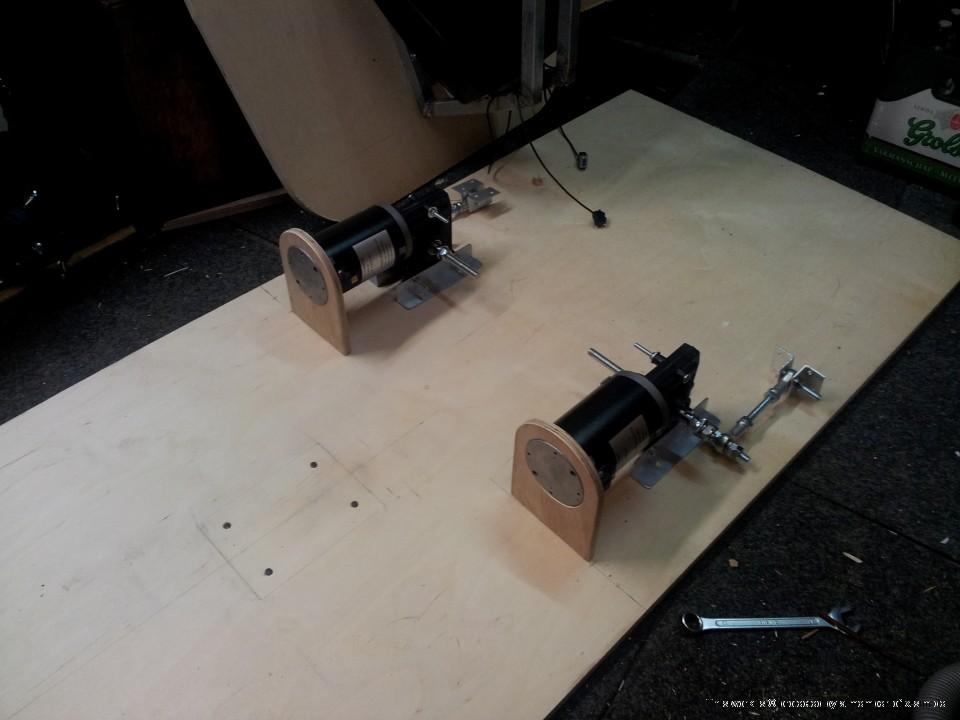

366
Big gamble... about here :lol:

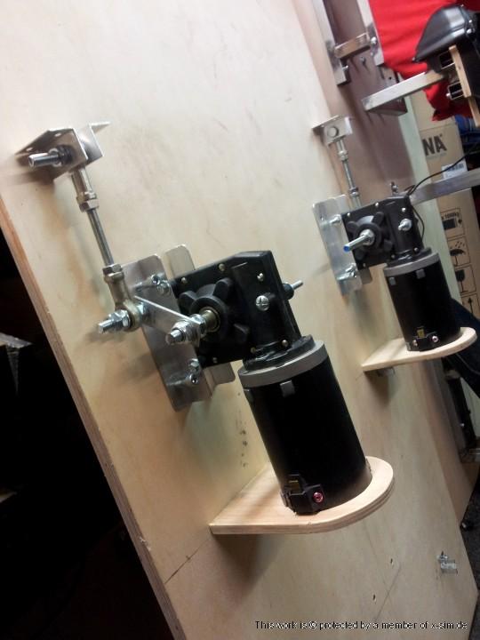

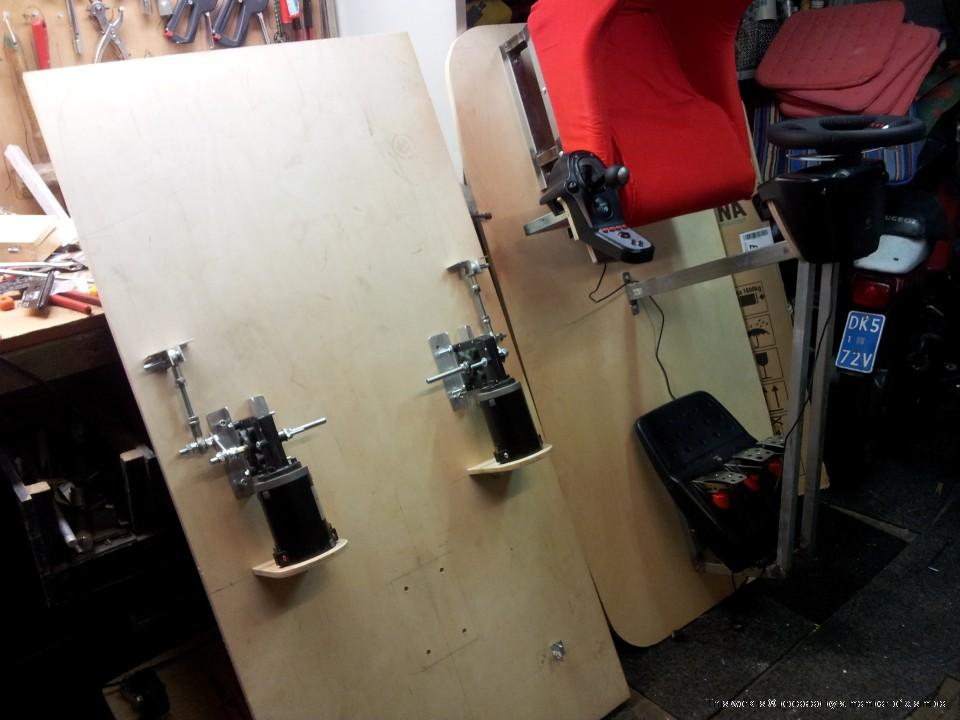

Bolted on the 18mm birchwood with some M8 bolts.
368 369
I still need to cut the bolts to correct size, but for now its good enough.
