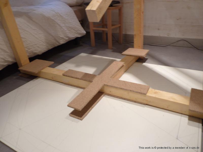

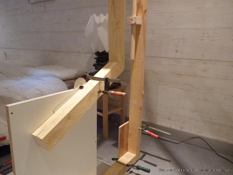

Re: Ultimate MSXR 3/4DOF
Postby sirnoname » Sun 9. Dec 2012, 23:53

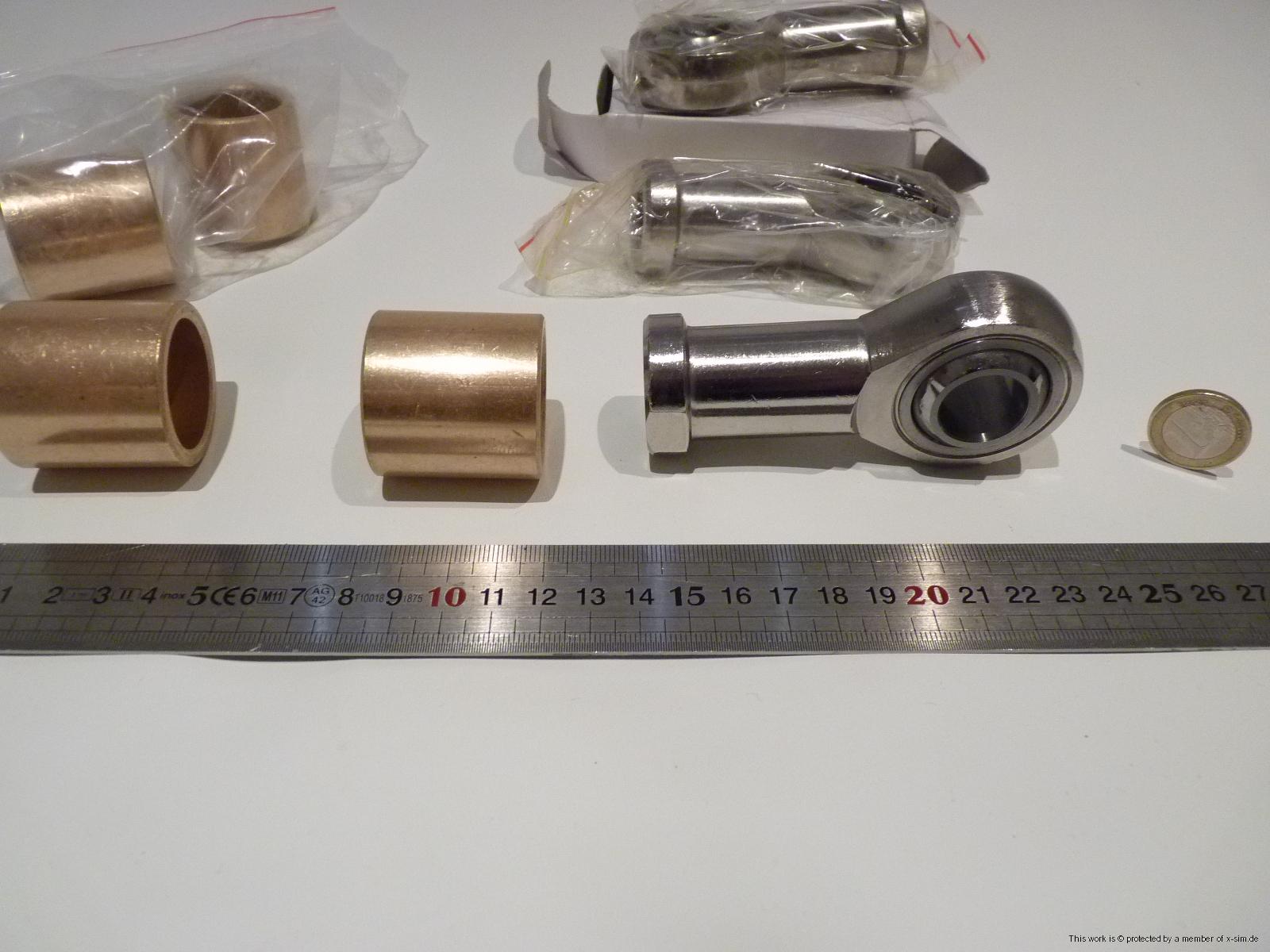

This is much work you are doing.
Do you think the chair will move if the weight of a person will stuck your wooden stick into hole solution?
As far I have learned from the rock'n'ride you need ball beared solutions.
This could be in your case drawer rails with metal ball bearing solutions.
Another question would be if this wooden construction will carry a person without break down.
Is this a modelling prototype and you will do this again out of metal?

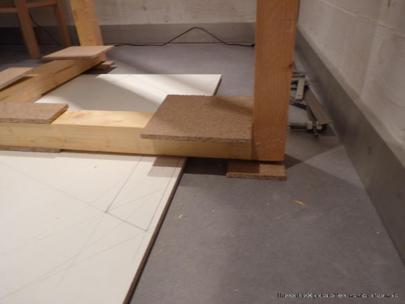

Postby Riton » Mon 10. Dec 2012, 00:09
it's just a model.
it will be made ​​of steel of course.
For sliding and rotating part, I use bronze bushings and ball joints. look at post 1
This wooden model allows me to check the plans, and trouble-free operation before performing steel.
I pioneered this achievement versus dynamic force.
This is not the jacks which moves towards the cockpit,
but, the axes which slide and rotate simultaneously.
the chassis is simpler, easier to achieve.
The model helps me to reflect on my work and verify potential problems.

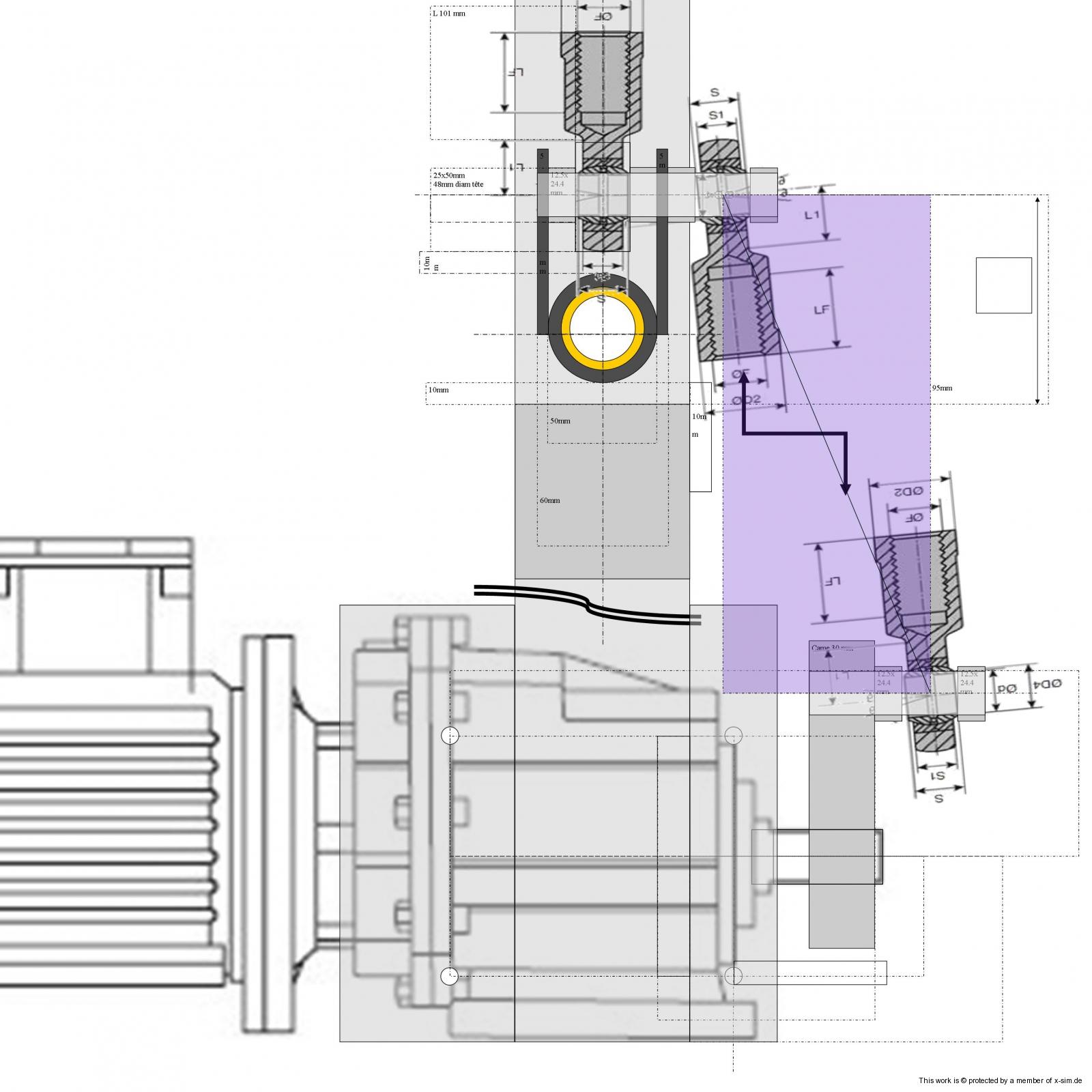

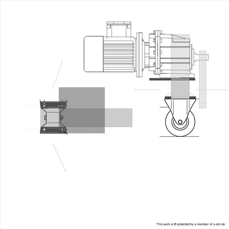

Postby Riton » Mon 10. Dec 2012, 23:35
simulating movement of a motor on the model

yes!

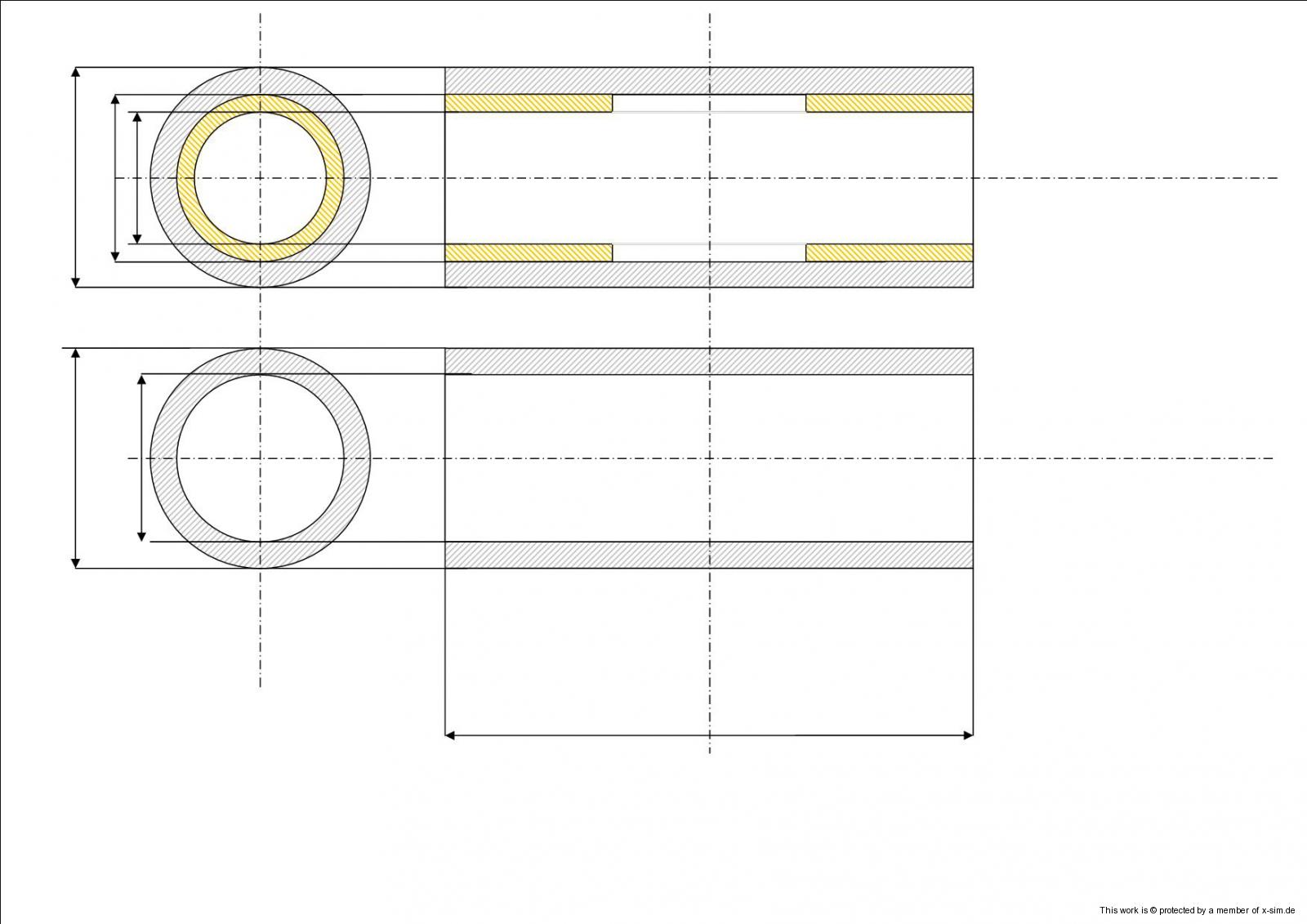

I got a job with the design of pipe support pads bronze.
1015
I placed an order for two steel pipes an online business
http://www.easyusinage.com/
1016
I also plan for new channels coat, I can verify that the items placed correctly.
1019
1017
1018

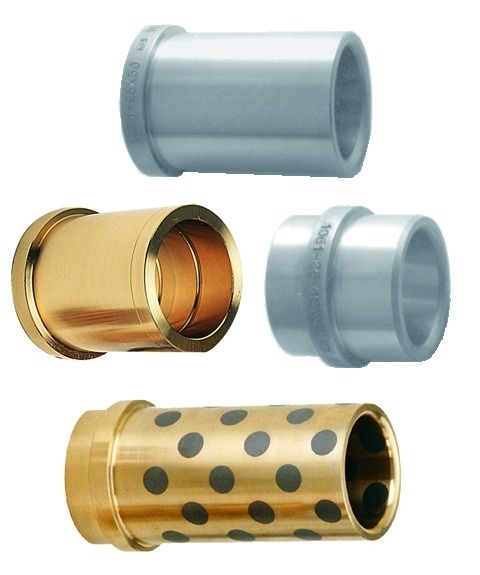

Postby mimio37B » Sun 20. Jan 2013, 11:03
Hello Riton,
I see your work from the beginning, very good project, I think it would be better use ball ring (I think like Sinoname).
http://img.directindustry.fr/images_di/photo-g/douille-a-billes-12564-2514615.jpg
You do not fear to rapid wear or hang on the axis?
It's posible to use self-lubricating ring?
http://img.directindustry.fr/images_di/photo-g/bague-de-guidage-pour-moule-et-outillage-14398-2823921.jpg
There are also composite ring, but probably more expensive.
http://www.pei-france.com/uploads/tx_etim/PEI10635.jpg
