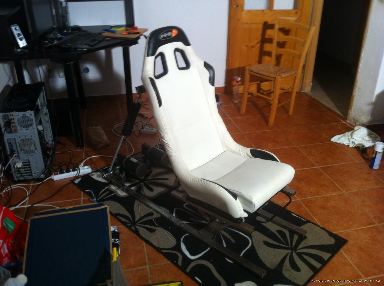

I have never finished this simulator because of errors that I had and some design problems with the motors under my seat, it didn't work. In the end I have cut the frame and did something other, I have put the motors behind me and I did the shoulder mount, moving just the seat, not whole simulator.
This is my current setup and it is working fine, I switched back to wiper motors because I couldn't setup JRK's and ZYT90 to work fine:

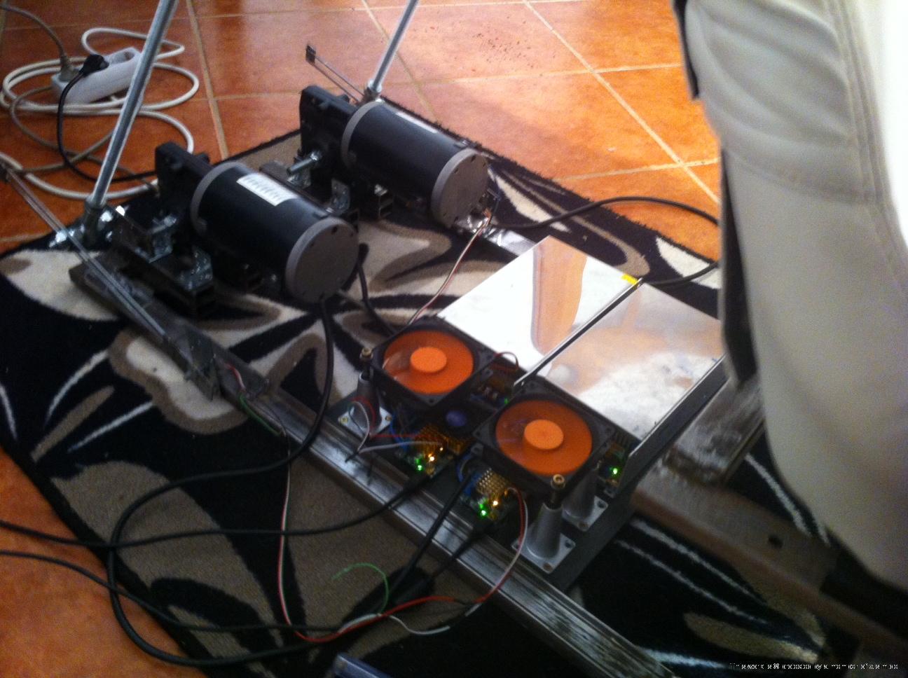

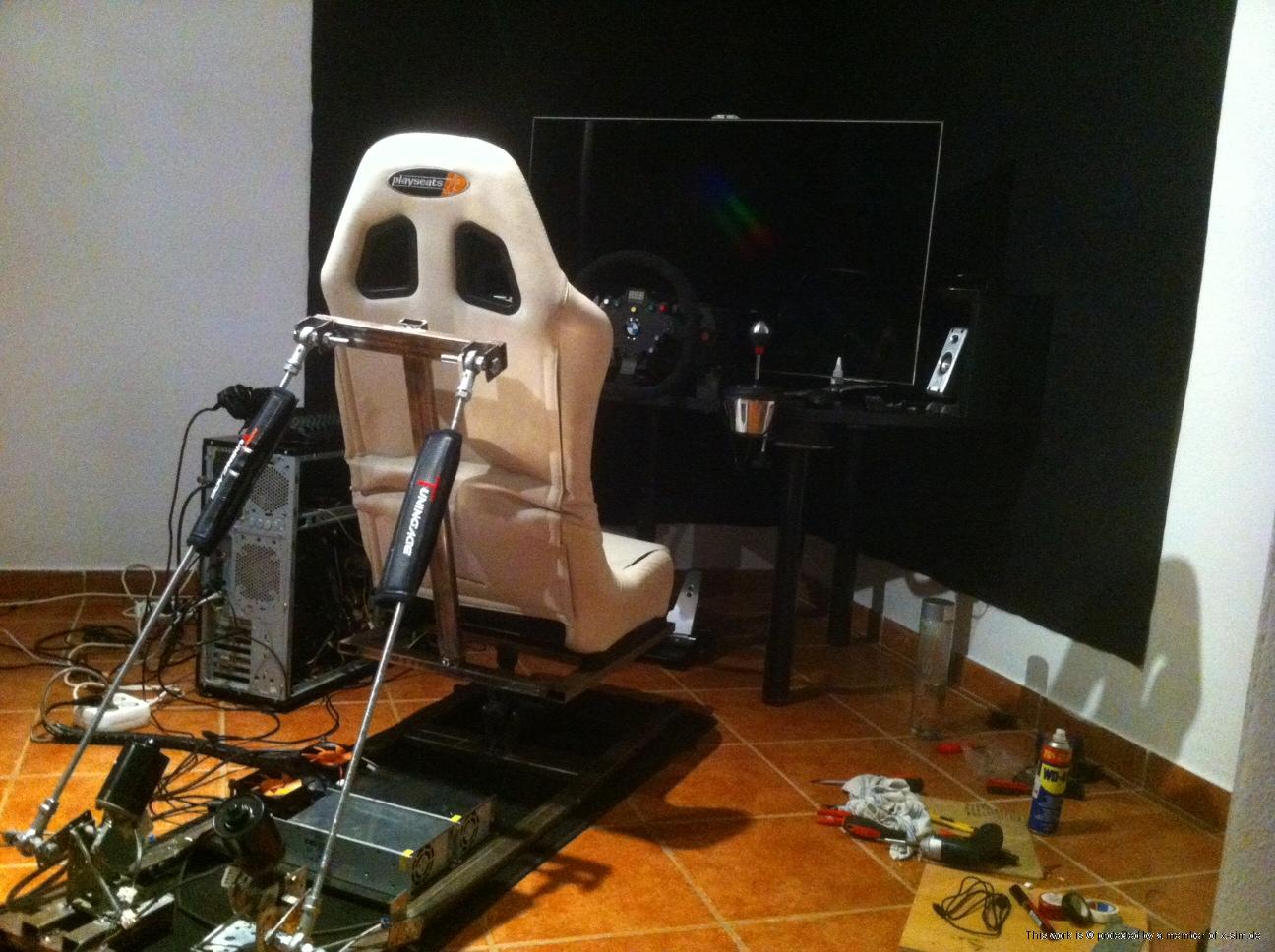

This was setup with ZYT90 motors with shoulder mount, but it didn't work for me, I had a lot of JRK errors and in the end I put back wiper motors. Since then I didn't have any errors and everything is working nice now
23362337
If you have same motors and JRK's like me, I hope you will do better, I didn't have luck.
