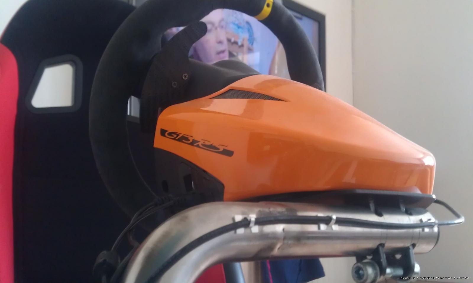

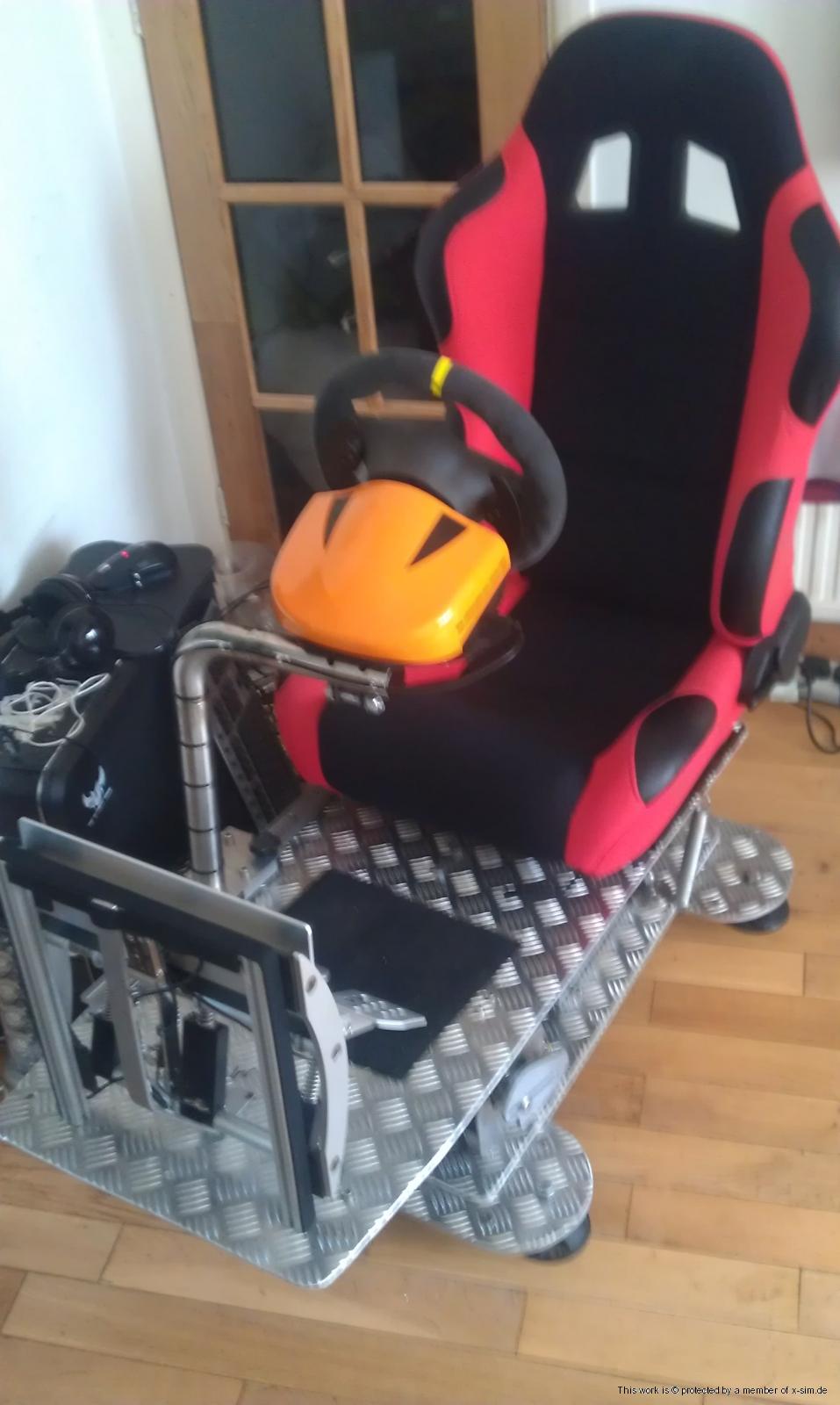

Here is my almost complete wiper motor project.

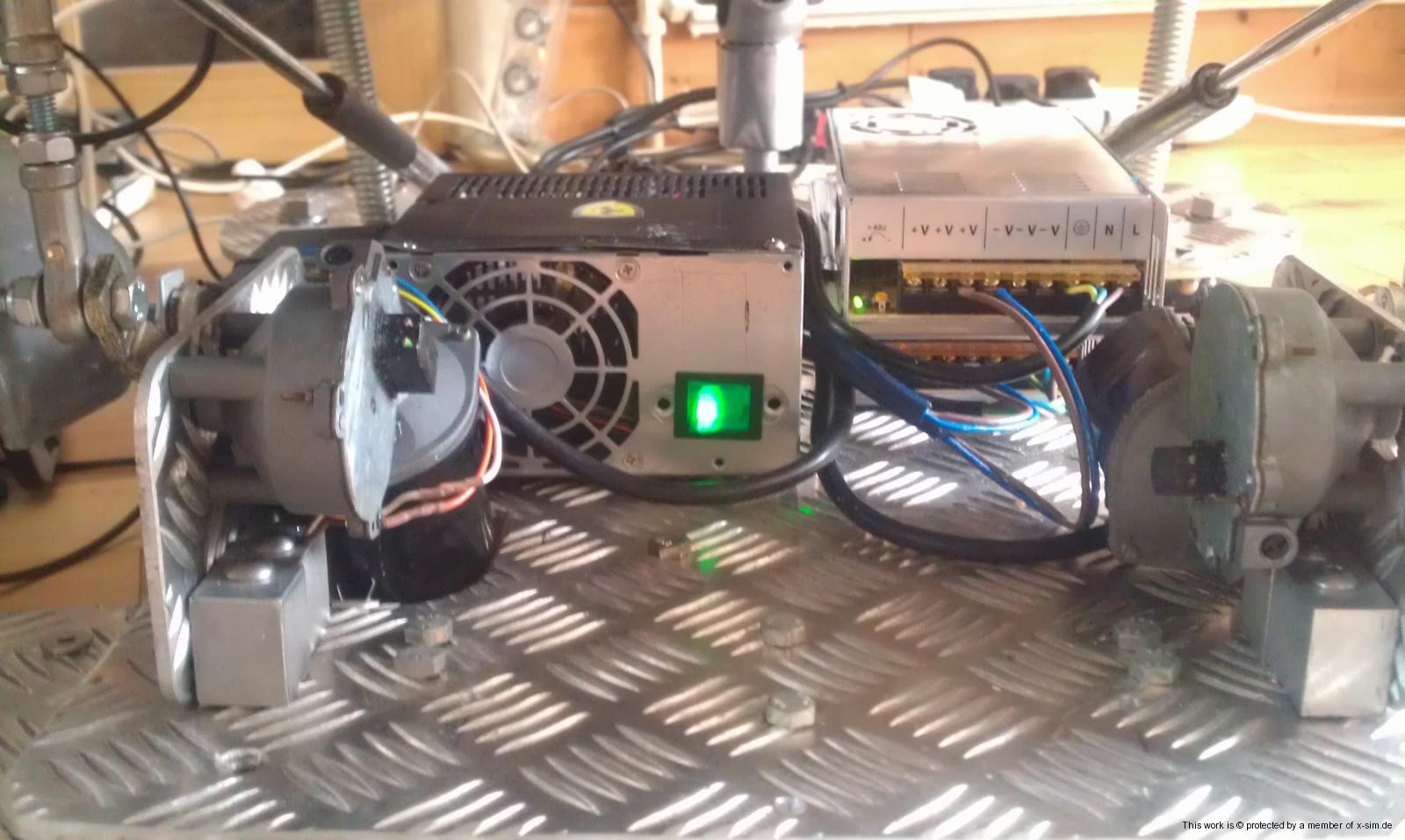

Postby Carl » Mon 26. Aug 2013, 23:17
My next task is to try and duct the extract air from my psu's and jrk cooler fan over the motors for some free cooling. I positioned the jrk cooler fan behind one of the motors and it was running stone cold after 20 minutes hard racing. My other motor was only warm too which was quite odd as it would normally be baking. I think this was down to the coanda effect across the bottom platform. My thoughts are that if I can split this air up and direct it over the motors I can keep both running cool.

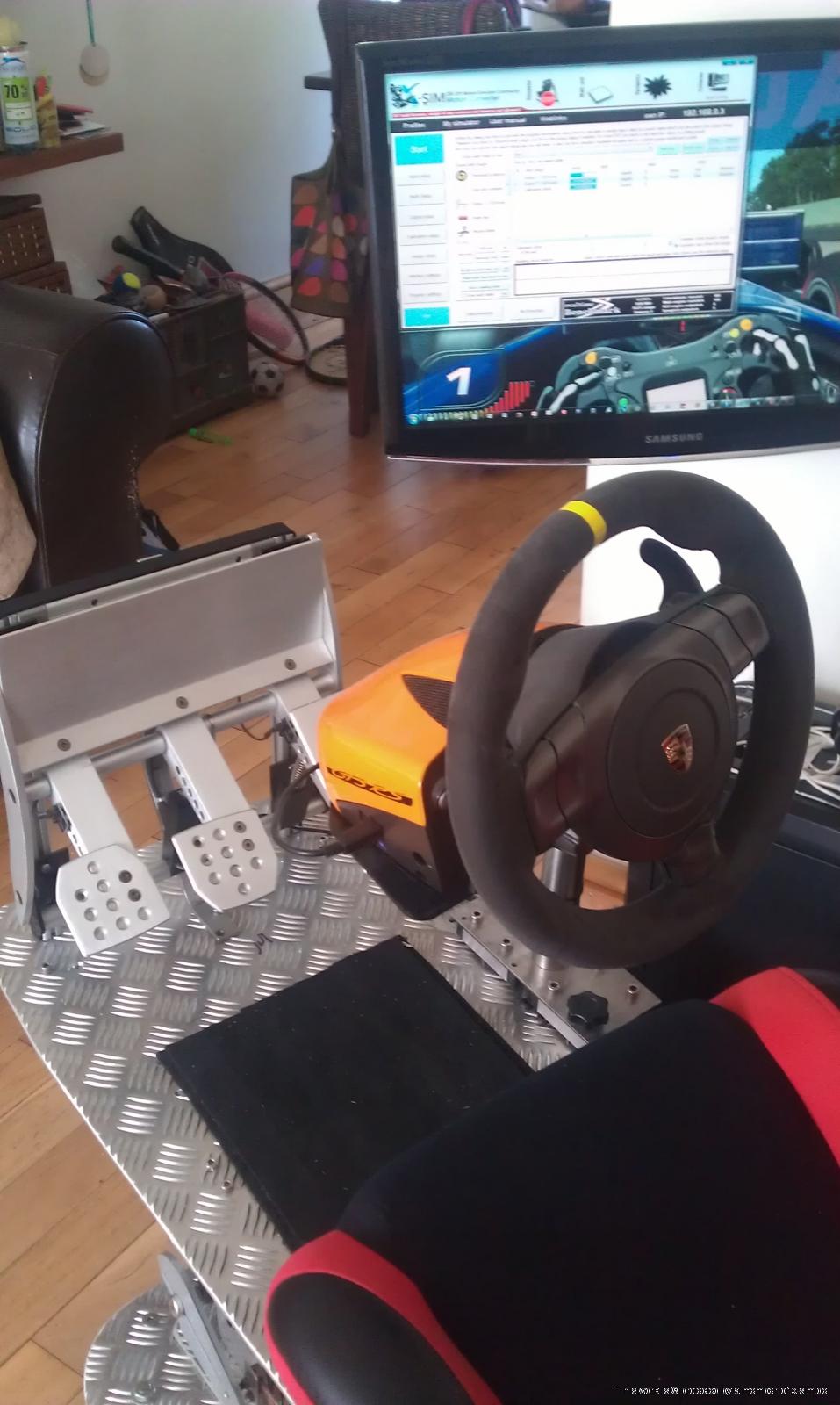

Postby kevin123 » Sat 7. Sep 2013, 13:14
Hello Carl
Nice work ;) only one thing you put it on the monitor sim or leave it to the wall sideways? Do not you a stiff neck? :mrgreen:
