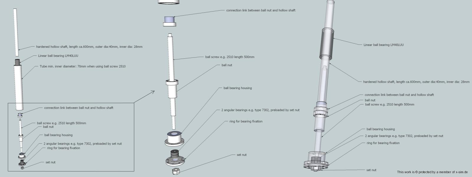

This is the actuator design:

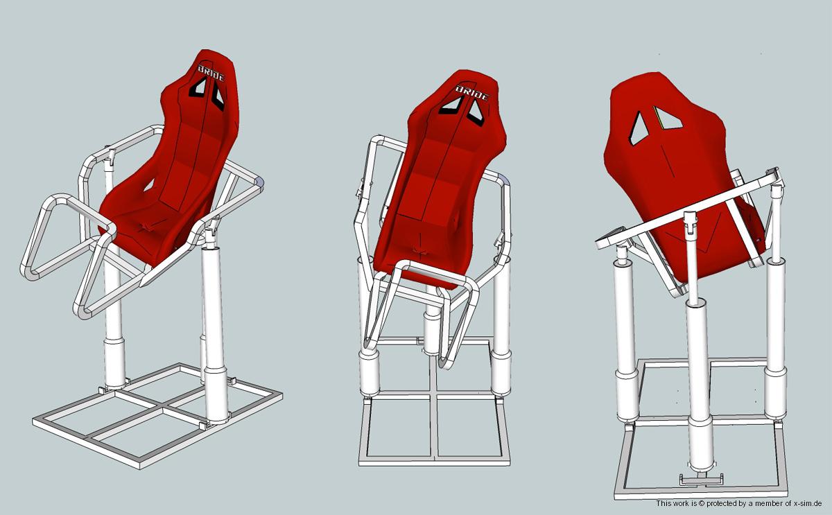

... and this is how I planed the simulator so far:
2836
Critics and ideas are welcome.

Postby sirnoname » Fri 25. Apr 2014, 08:03
Do you think the small power of the kangaroo will lift you? Lift you powerfull as usual for simulators?
Look at tronics AC motor control, they can and maybe you get some cheap from ebay. It might be easier going for you.

Postby madmarty » Fri 25. Apr 2014, 20:44
Thank you for your answer.
I don't have experience in what is needed to lift a platform.
I found this in the gallery: viewtopic.php?t=273
It's a great work but it doesn't look very snappy.
They use 350W DC motors but ballscrews with 10mm pitch, which need stronger motors and the center of movement is much higher than the center of gravity so the motors have to work very hard. I tried to match both, center and movement and center of gravity.
I have been told in another forum that AC-motors are strong but relatively slow and sluggish in reaction. I would like to have a snappy motion like you can get from scn actuators. Some people said that the AMC does have some slight lag and isn't as fast and accurate compared to a JRK or a Kangaroo and it is fiddly to adjust?
I know I can't have everything but maybe I can find a good compromise?
Ballscrews are relatively efficient and easy to hold and move with 5mm pitch and I thought about supporting the left and right actuators with big springs which each can lift 60Kg. The platform inculding me should be 120kg. I don't want use screens but the oculus rift with my simulator, so this saves me some weight.
What do you think about this?
Are there fast and snappy AC-solutions in the same price-region of my choosen stuff?
