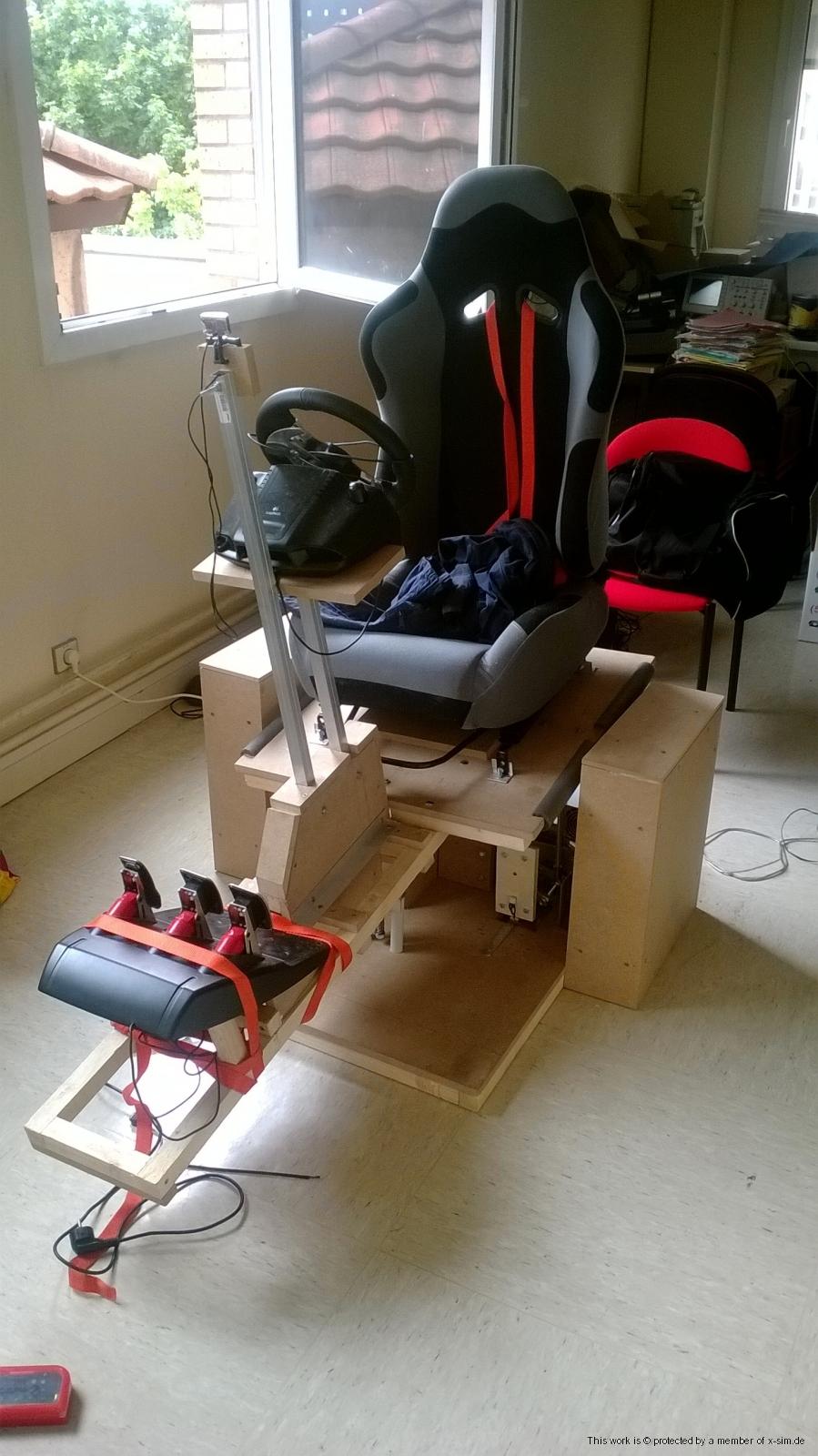

Postby ENSEM1A14 » Fri 30. May 2014, 15:01

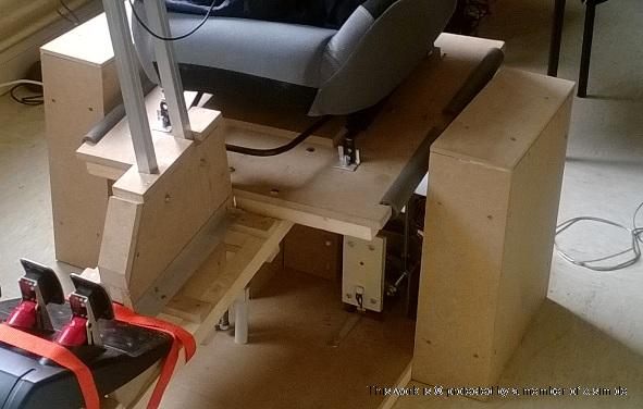

Hello, we give you our new simulator. It's a scholar engineering project. :geek:
We had to build a 2DOF race simulator.
2913
All the structure was made wooden.8-)
It is cheaper than a metallic structure, more easy to built and move and it's as light as a Aluminum one.

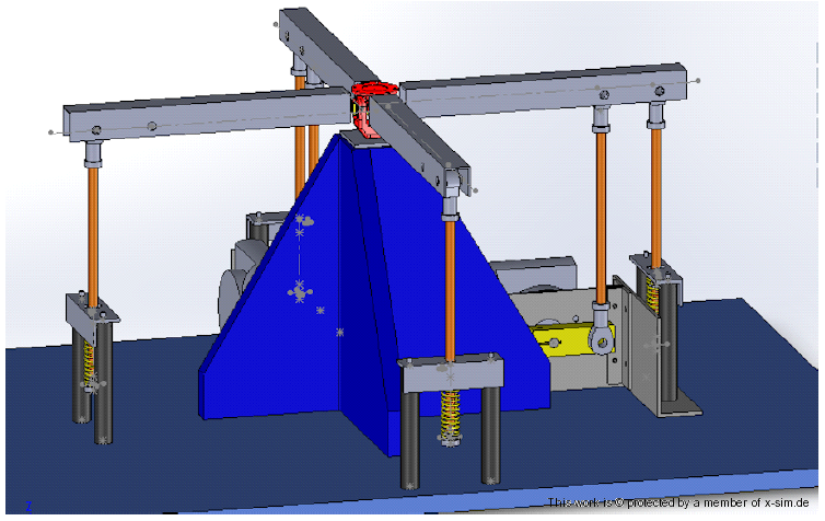

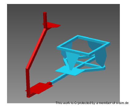

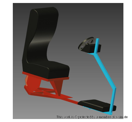

For the designing part

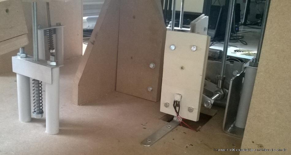

It was necessary to design the basis of the simulator allowing to put in movement the cockpit, which is constituted by two engines which by means of a system of connecting rods make turn according to two axes of rotation the cockpit.
To relieve the effort of engines, a system by spring was set up (at the end of every rail on the figure).
For the "special" parts, we thus realized plans by means of a software of CAD Solidworks
Inspiration:
2911
2912
2914

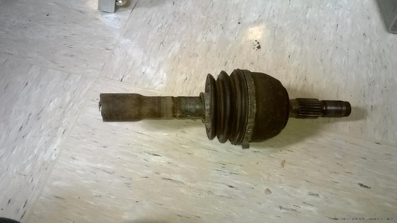

One of the major problems of the realization was to find the cardan joint which is in the center of the structure.
Finally we found a cardan joint sizes of which were compatible with the structure.
2915

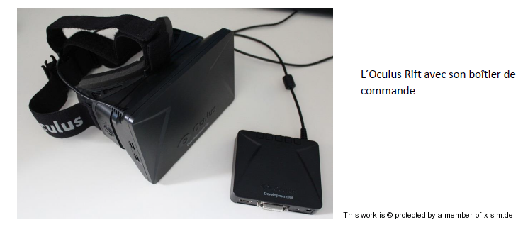

Oculus Rift
For our project, we decide to use The oculus rift instead of screens.
So it's appeared necessary to use a TRACK-IR to compense the picture deformations due to the head's movements while the cockpit is moving. We also need it to shut off the inertial centrals from the oculus rift. Then this is the TRACK-IR which provides the head's movements in the game
2910
2916

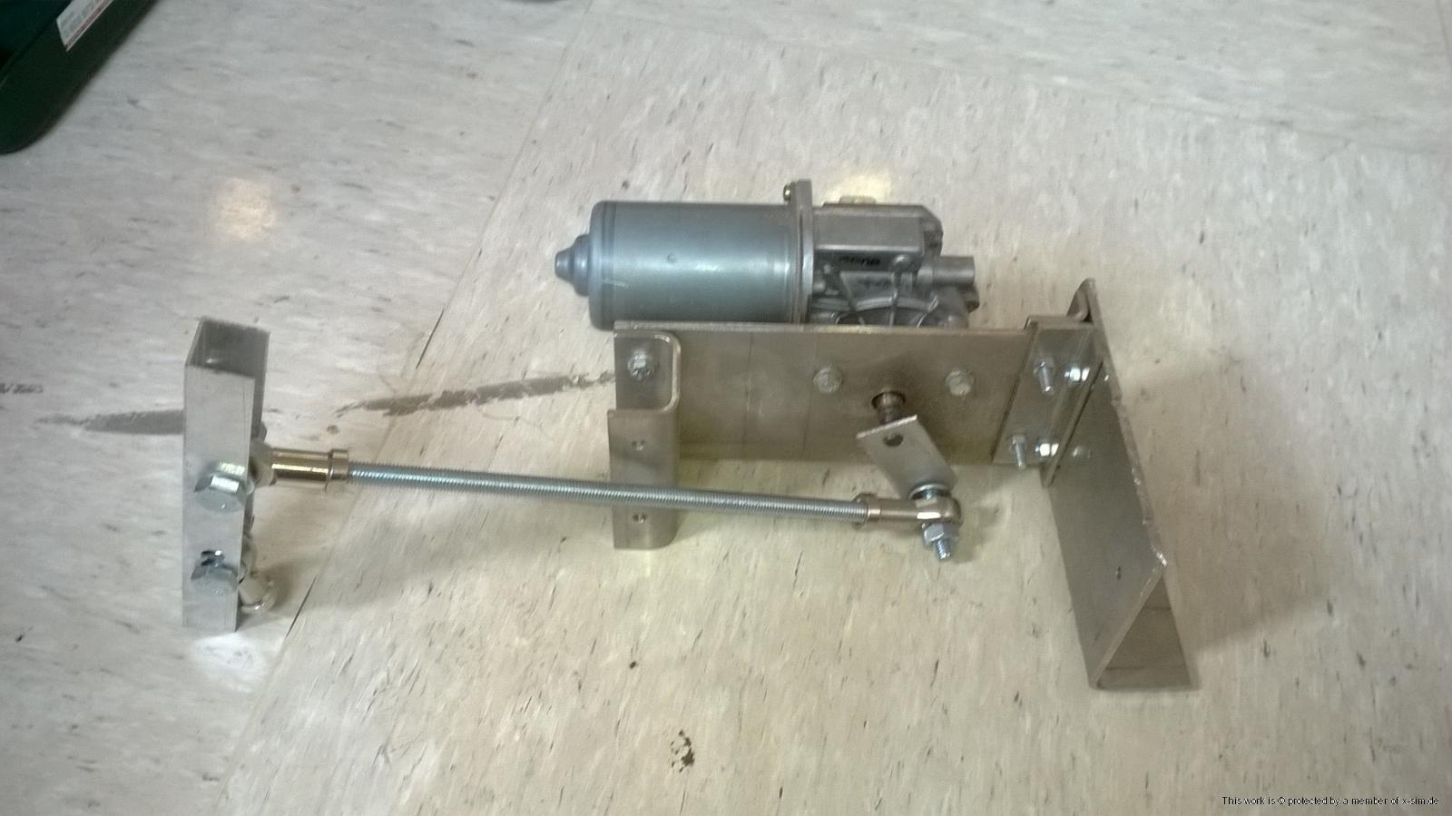

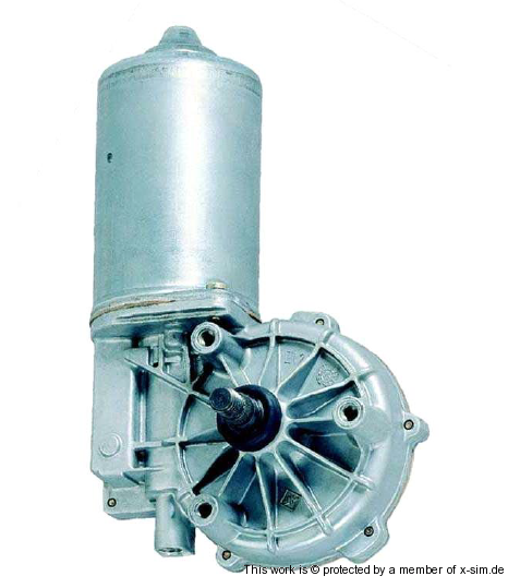

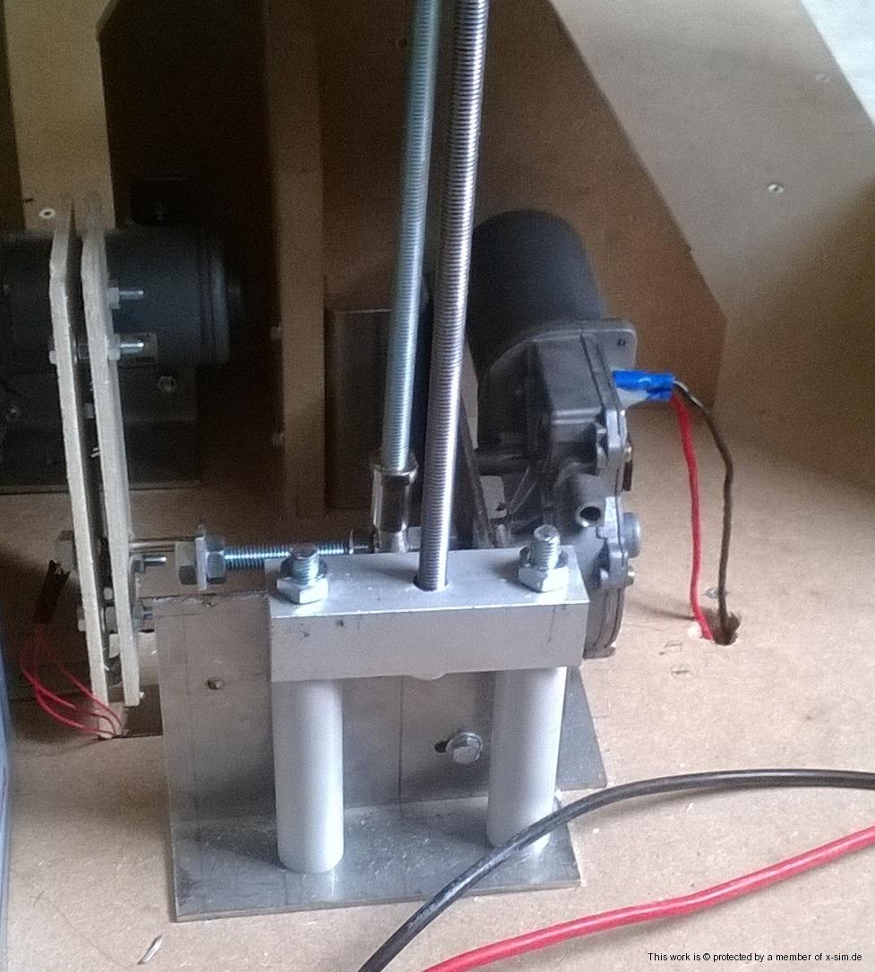

Mechanical part

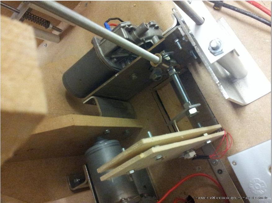

To insure the movement of the cockpit + user of a maximal mass of 150Kg, engines have to divide up the efforts necessary for the movement. It is essential while every engine develops a minimal couple of 16 Nm. Beyond the constraints of effort, engines also have to supply speeds necessary for the simulation of the various movements of the nacelle. Engines so have to have a minimal rotation speed of 30tr / mn and it in both directions of rotations.
2917
ENSEM1A14
Posts: 7
Images: 24
Joined: Thu 2. Jan 2014, 22:21
Re: Simulator ENSEM1A14
Postby ENSEM1A14 » Fri 30. May 2014, 17:18

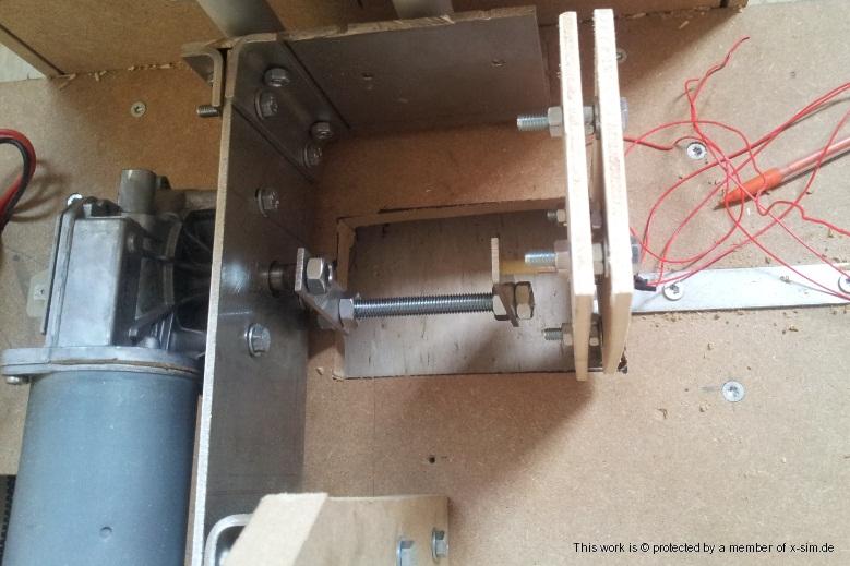

A system of connecting rods is fixed to every engine to transmit the movement to the cockpit.
One of the rods is linked to the engine and the other to the platform to help engines to compensate for the weight of the cickpit during a slope of this one.(see solidworks plans)
2918
2920
2921

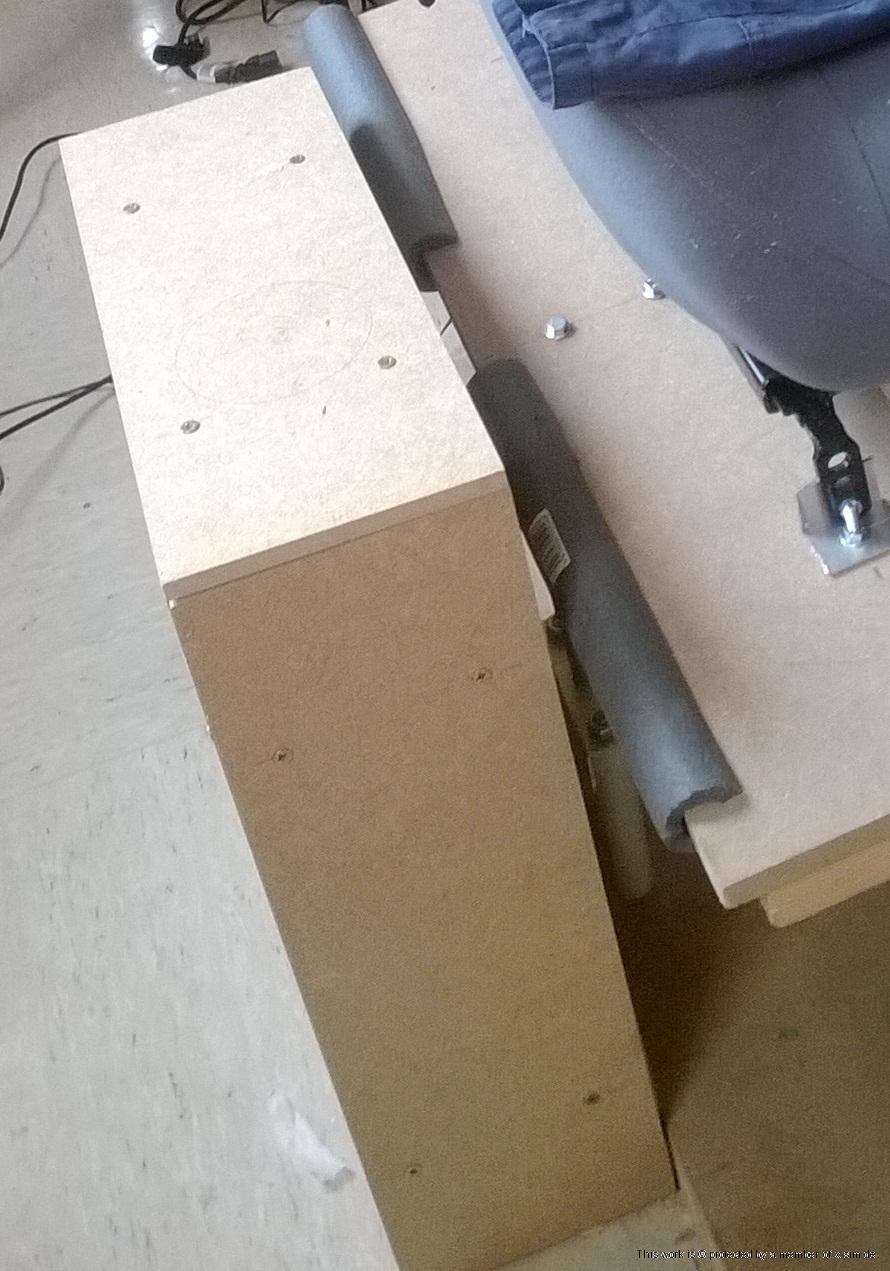

To avoid to damage rods coonected to engines by the movement of lace of the cockpit, we made two cages which block the rotation with regard to the vertical line of the cockpit. Those cages can also be used like a support to put a drink or a cell phone on it ;)

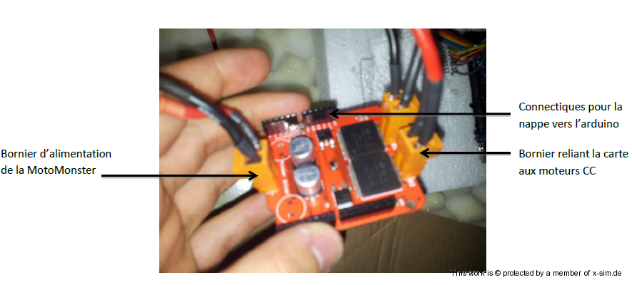

Electronic part

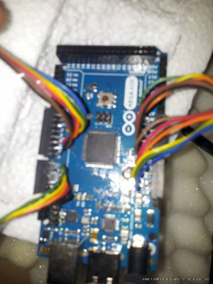

We use cards arduino and to motomonster which delivers the necessary power for the functioning of engines. We also use potentiometers in order to te acheive the subjection of engines. Concerning the potentiometers, we got problems about its integration into the engines. So we built a wooden plate which transmits the rotation of the driving shaft to the potentiometer.
2929
2931
Arduino card
2919
Motomonster card
2925
We designed a box which contains the two cards. In the box, there is a ventilator which will allow to cool cards during the using.
2928
2930

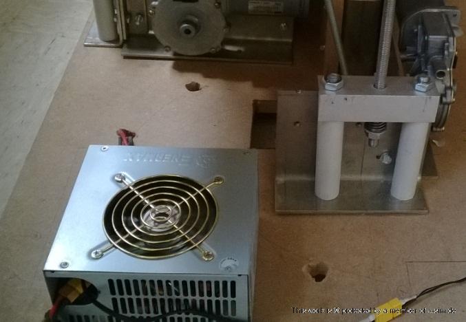

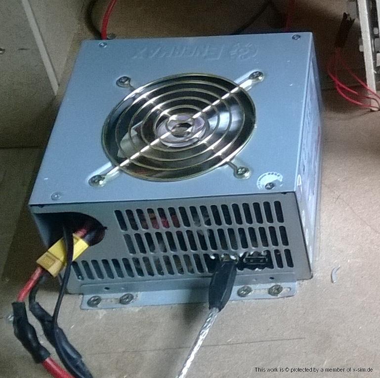

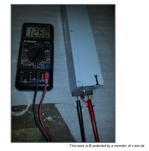

For the electric supply of the electric part, we use a power supply of 12.6V and 47A
2909
