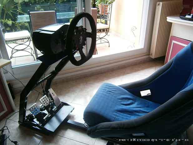

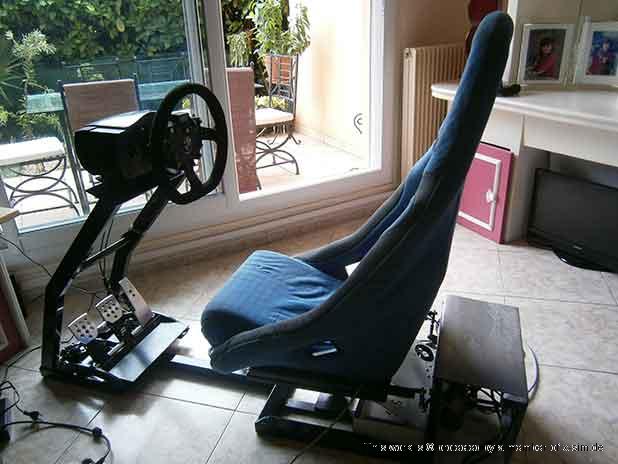

So I'm motivated to make my first 2DOF dynamic simulator today.

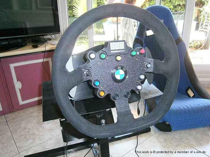

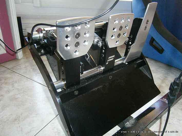

The materials:

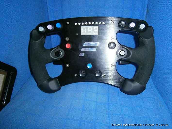

Flying FANATEC BMW M3 GT2 clubsport
Flying F1 clubsport
Crank-clubsport v2

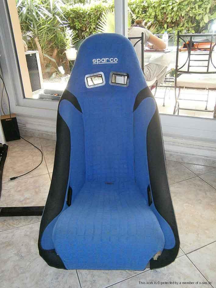

See sparco
Brake-box and a homemade speed sequential.
-Motor Wiper course 3

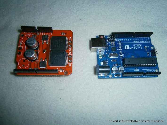

Card-compatible Arduino UNO R3
Card SparkFun - Monster Moto Shield - VNH2SP30
-Two potentiometers
LCD Keypad Shield-1602 For Arduino Duemilanove UNO Due R3 R3 Mega2560

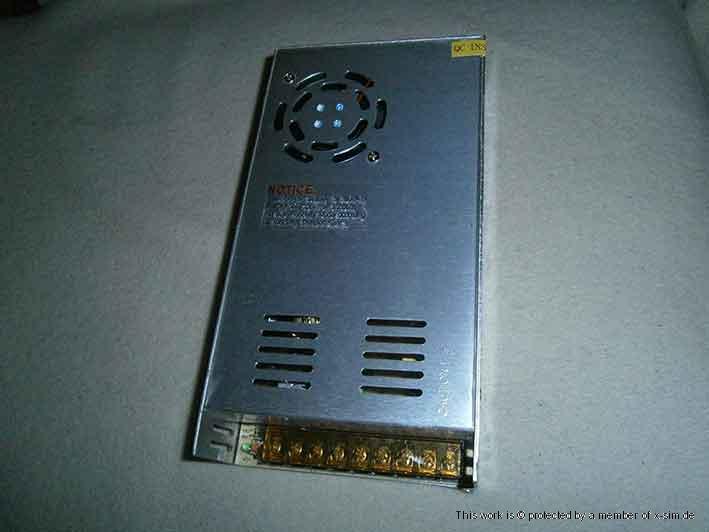

Power Cut-AC 110-220V TO DC 12V 30A 360W

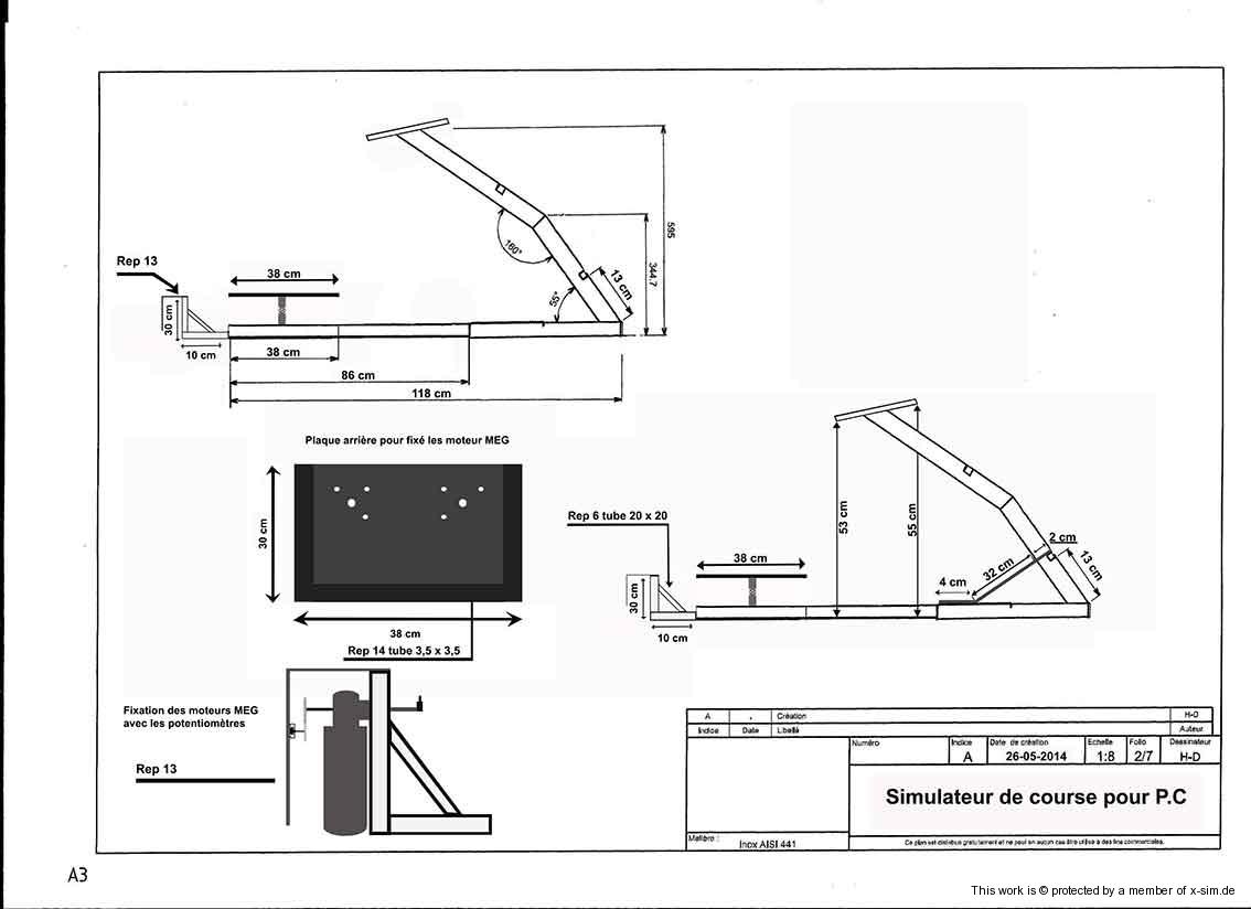

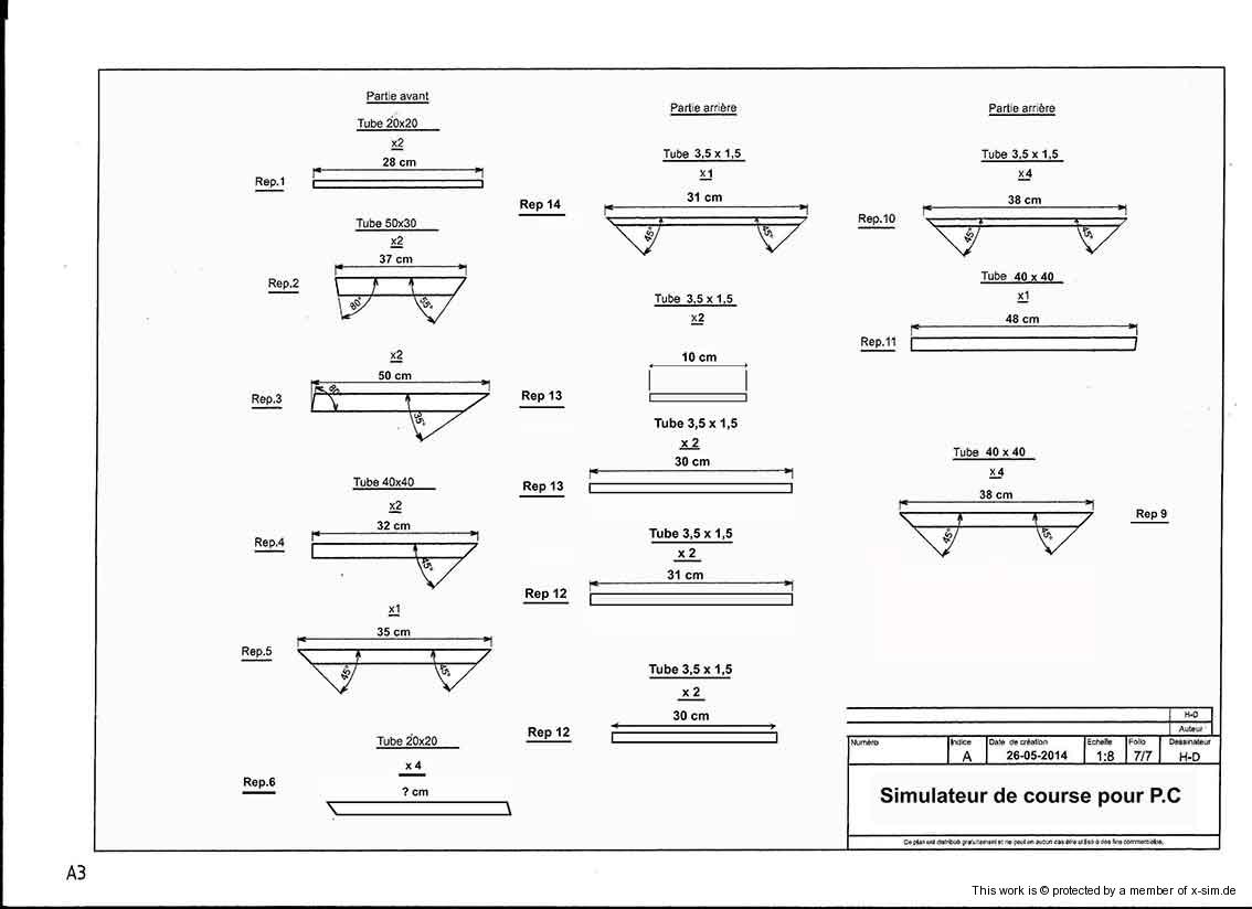

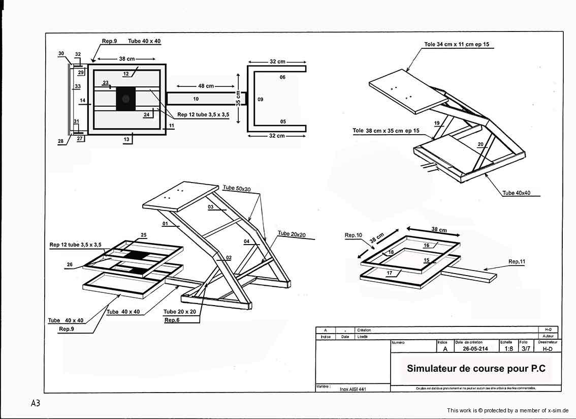

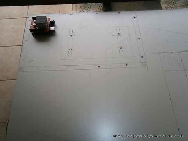

Chassie-produced with rectangular metal tube (40x40, 40x30, 20x20, and 3,5 x1, 5.
A carding-
-Two wooden planks

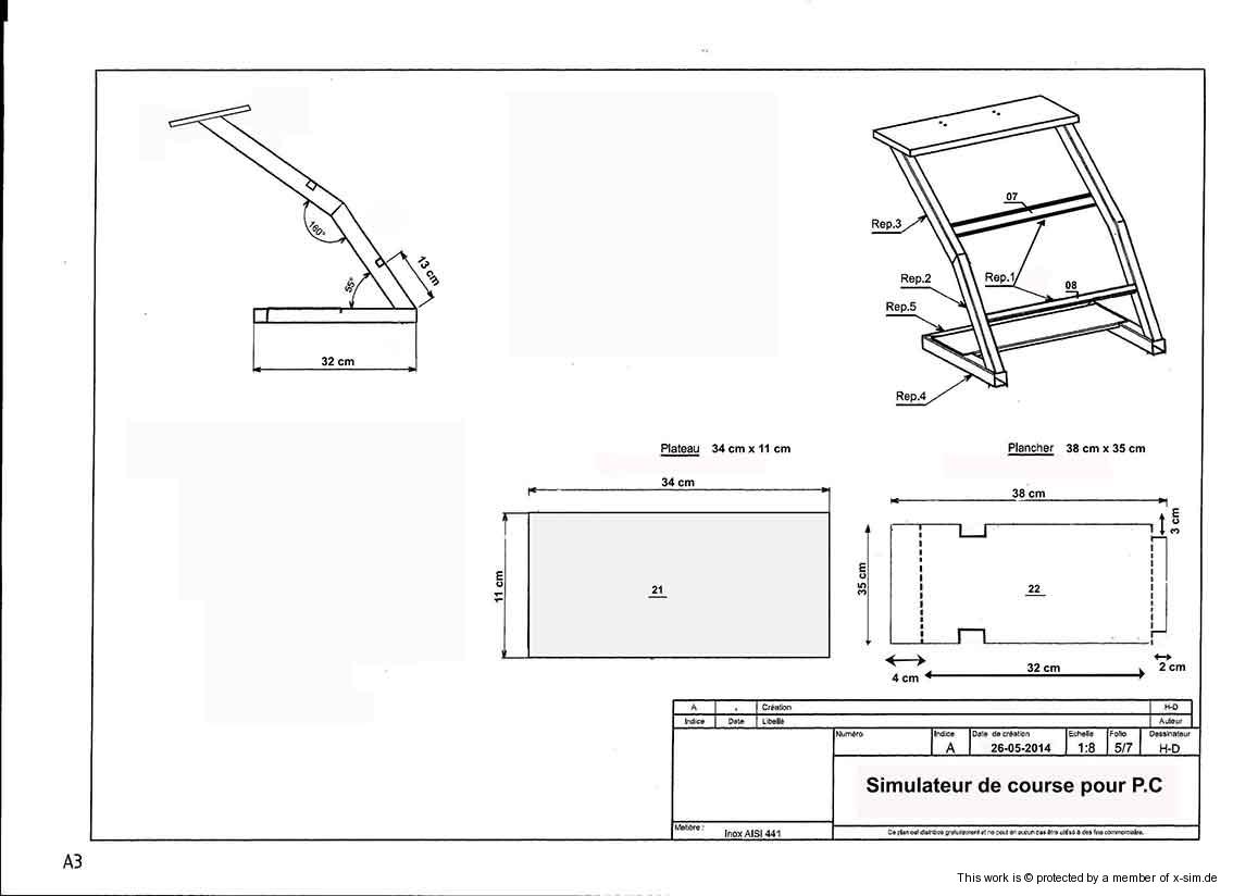

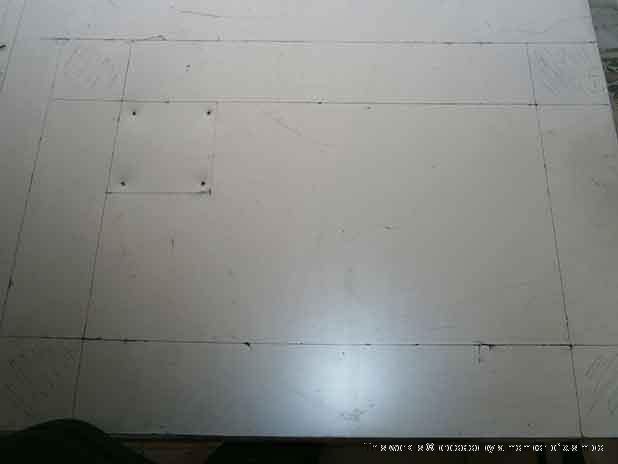

Here is the plant which was given free by my Playseat herve who made a simulator stainless steel is beautiful thank you to luis.
I did some mod.
2990299129922993
Pictures of my gear
2950295129522953

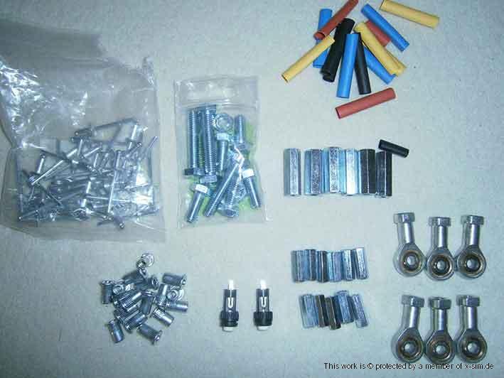

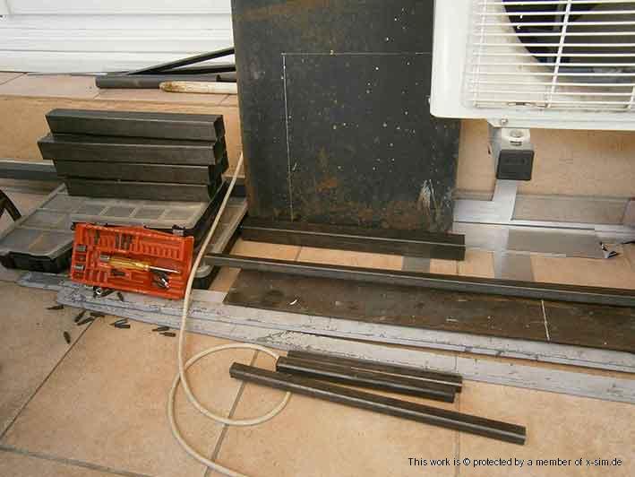

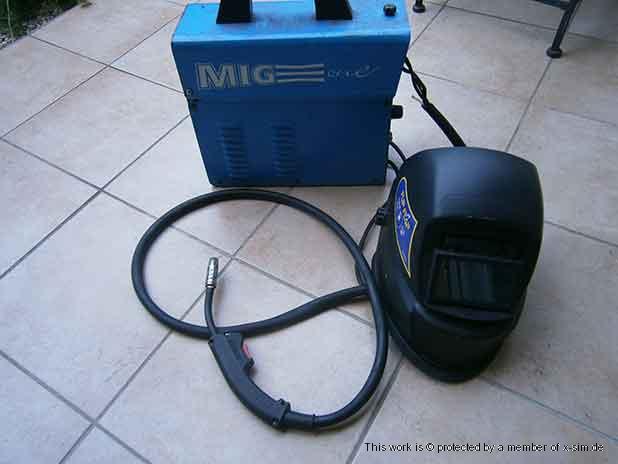

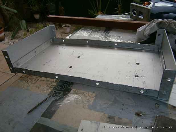

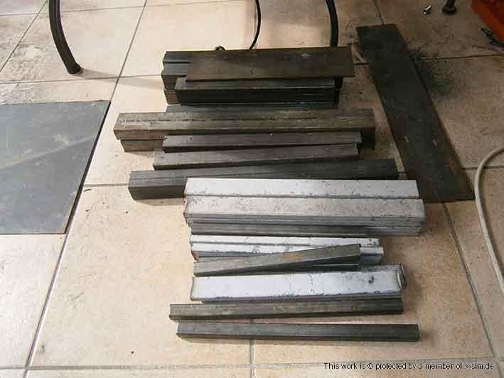

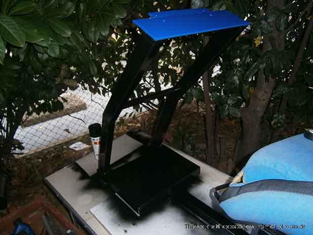

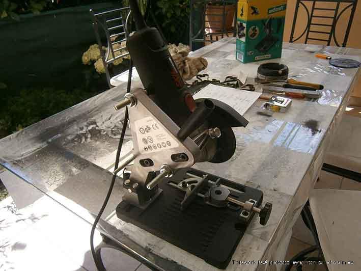

I pass now veiled gear cutting tubes and small acquisition to secure the grinder
2958295929602957

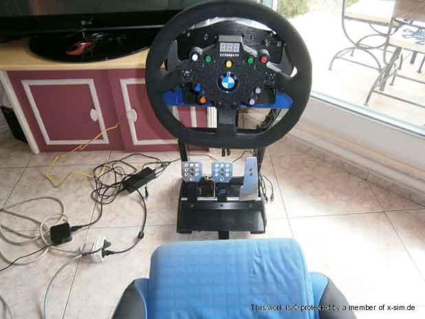

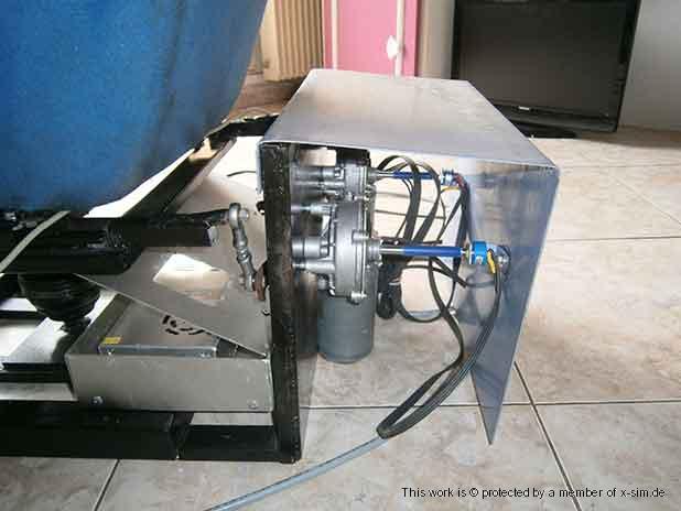

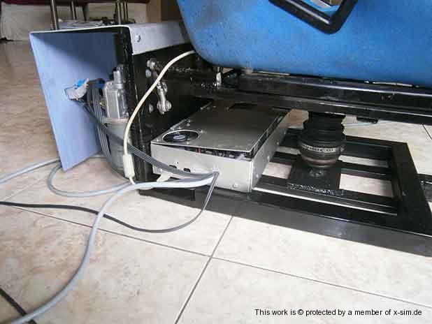

I am no longer a 2DOF but frex with engines attached under the rear seat, if someone has an idea let me know thank you
I received the rest of the cool equipment
2961296229632964

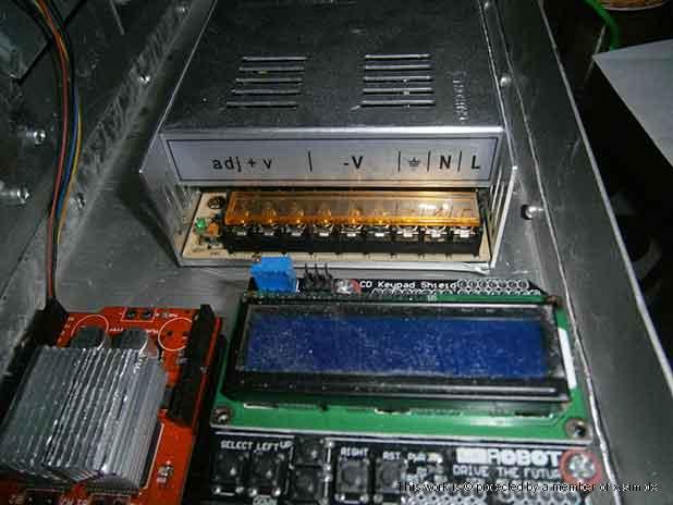

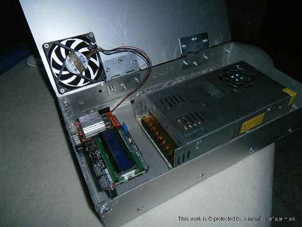

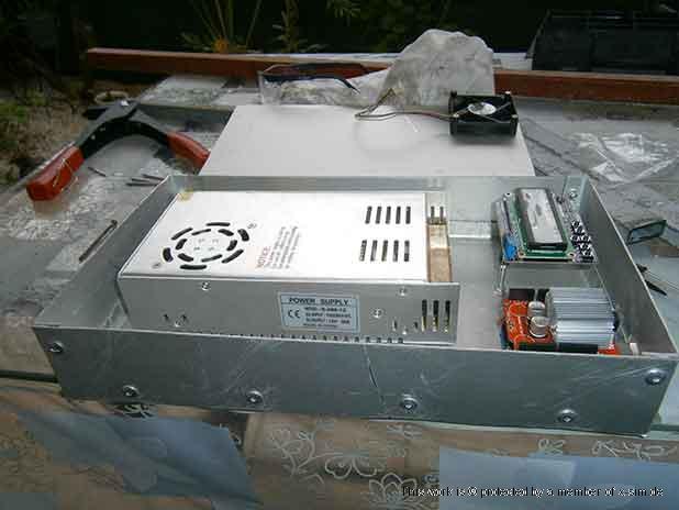

Hi to all of you here I am back, after several searches in the forums I found the answers come to you.
I try to connect the Arduino board with the Monster Motorcycle and related to food and what serves the connections on the power, the right is the more mass and the earth in its 220v is ok but left I do not *
I took shielded cable for connections made​​.

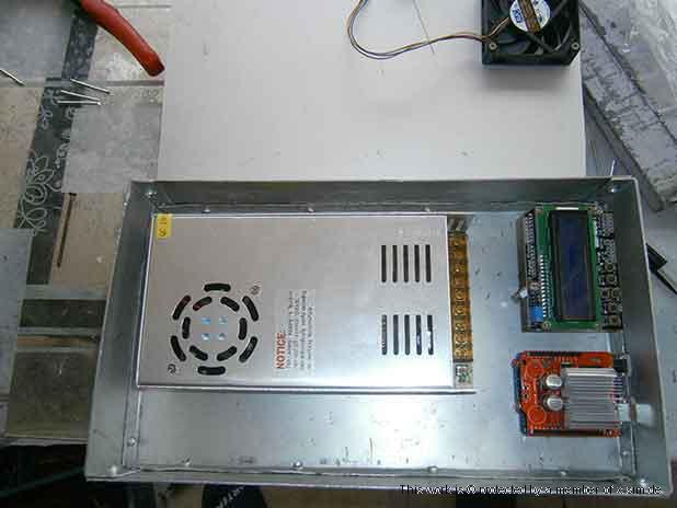

I made a box to put the cards with food, I just elevated and protected so that nothing touches the plate.
296629672968
2969297029722973

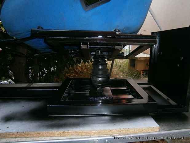

Hi all, here I am back.

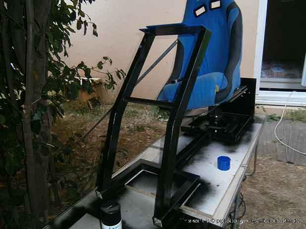

I finished welding, painting, fixing the electronic box, potentiometers and engines.
I still have to finish the button box, fixing the gear box, the brake and the board with four wheels in the simulator, I finally see the end of the tunnel.

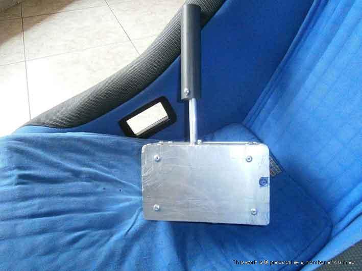

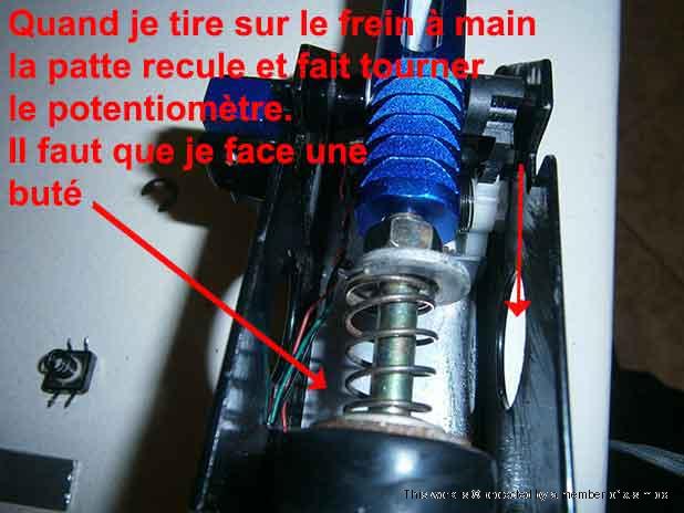

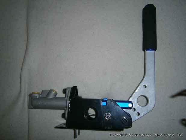

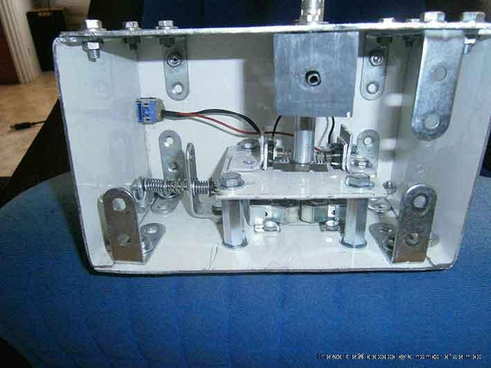

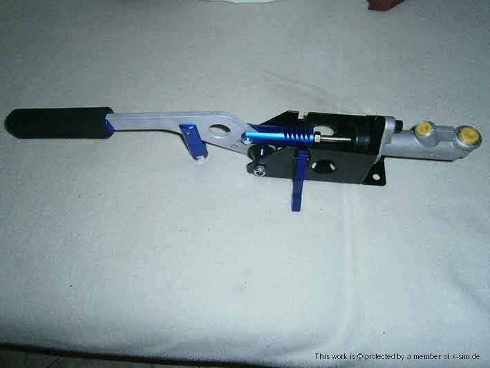

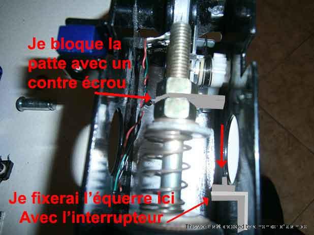

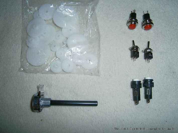

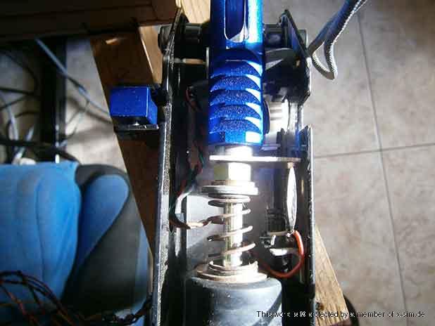

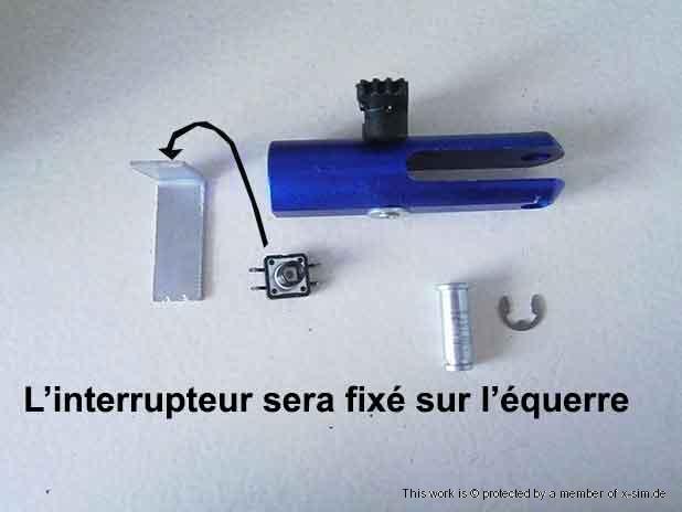

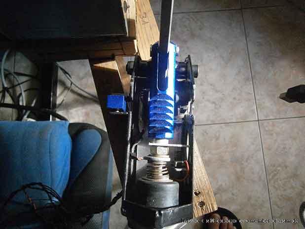

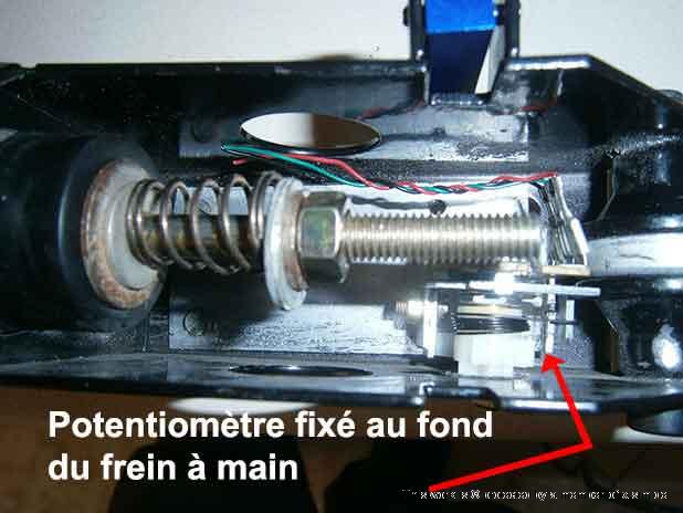

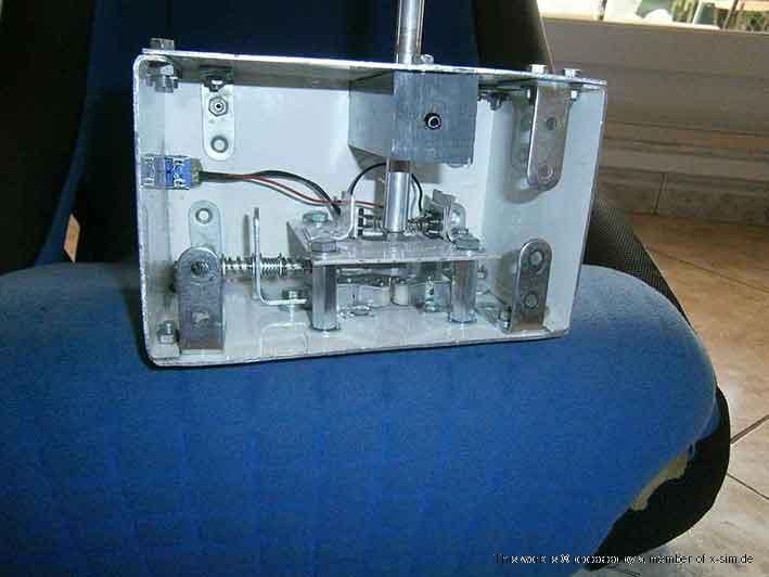

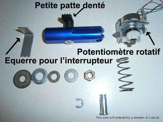

I'm a vertical brake hand with a potentiometer and a cross as a function.
It is connected on the circuit board of the clubsport pedal FANATEC.
why a potentiometer for richard burns rally games like that on an analog setting handbrake, it gives more realism when you pull the cablle, a interupteur it off.
And interupteur for other games that do not support it.
Here are some pictures for you motrer the motage.
