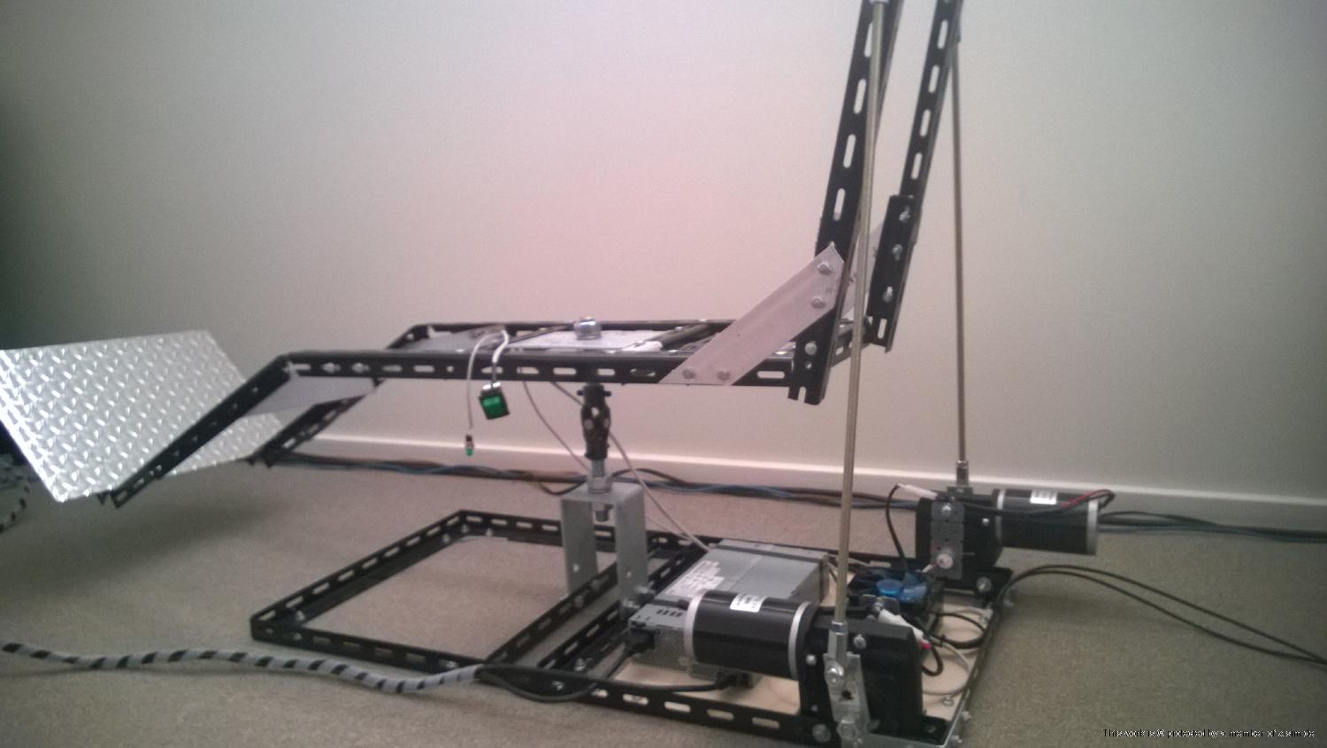

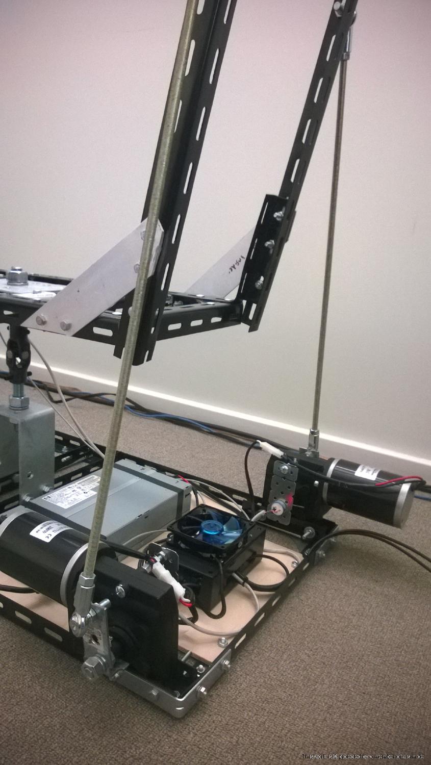

Consequently, I've roughed in a frame using steel angle/shelving from the local hardware store, bolted together. Some threaded rods and rod-ends serve OK to connect the upper part of the seat to the worm drives.

I'll canabalise my old DXRacer office shair for the seat.

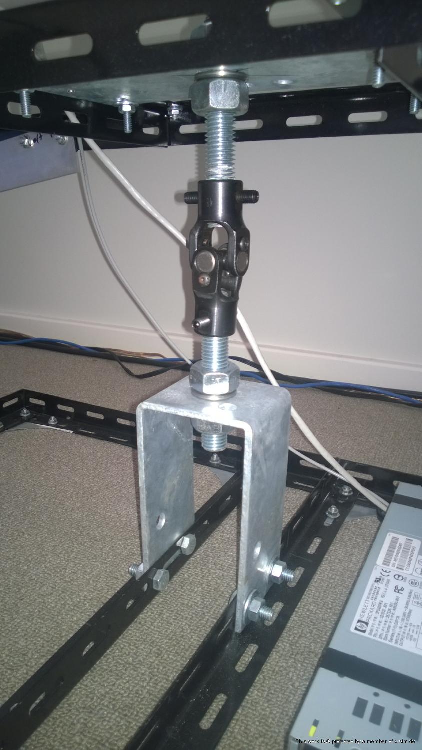

I'm using a steering wheel knuckle as a u-joint, but I don't expect it to be solid or rigid enough for the finished product, so I plan to use a more robust universal joint from a modified car drive shaft, with fixing plates welded on each end. I'll make sure the actual u-joint is right underneath the chair for the finished product.

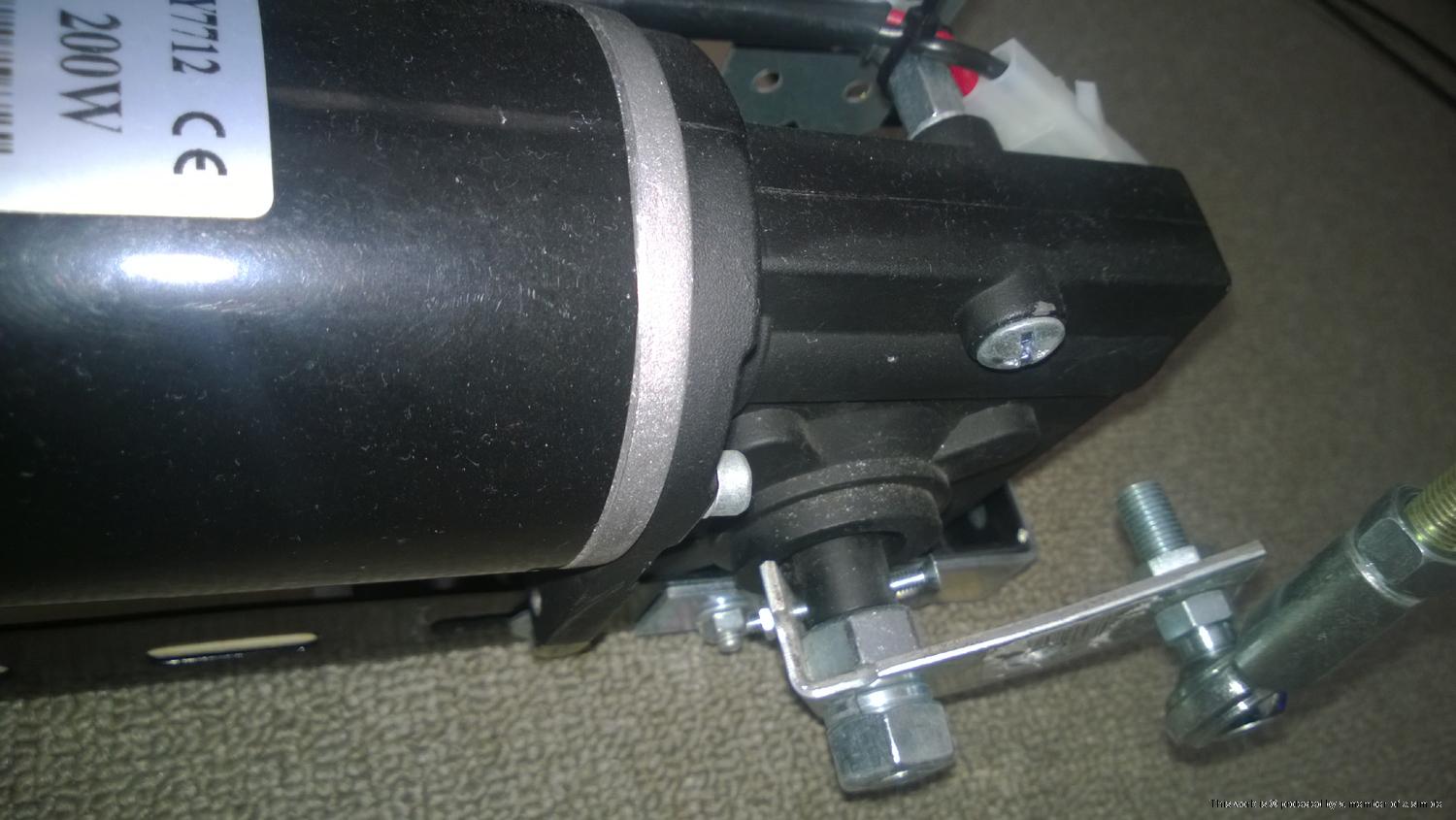

I'm using two 12v worm drives from motiondynamics.com.au which are doing a great job so far.

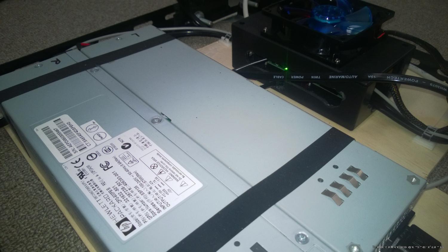

With a few bits of hardware from the local electronics shop, I've wired up two Pololu Jrk 12v12, powered by two HP DPS-600PB server power supplies so I'll have plenty of power.

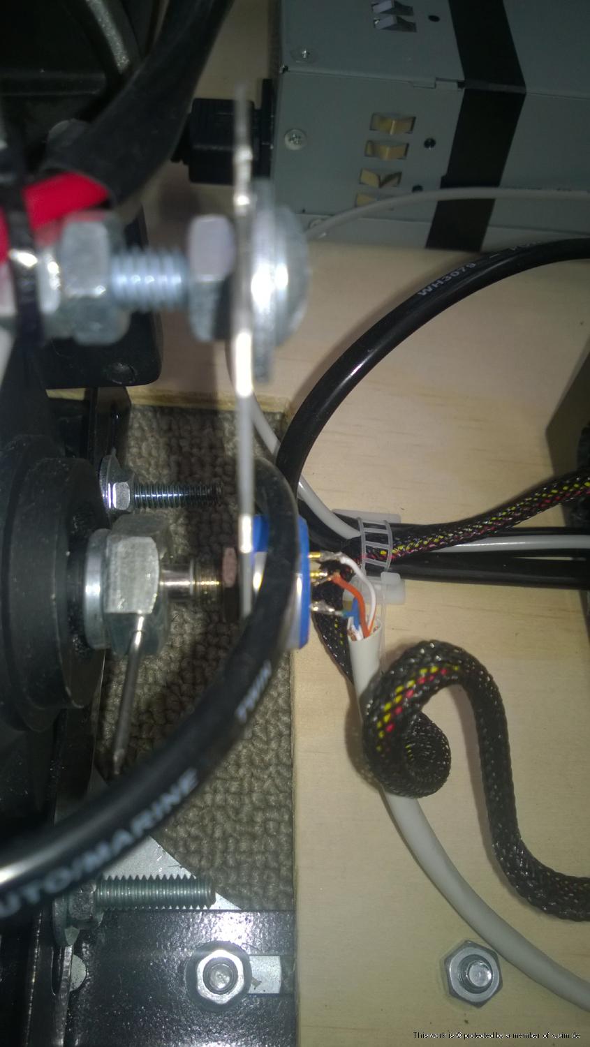

I used a bolt as the axil for each motor, and eventually I ended up drilling a hole in one end of each bolt to fit the potentiometer that feed back to each JRK controller. This hole is just big enough to fit the pot, then I drilled a small ~1.5mm hole through the axil and pot shaft so I could slide a nail through to lock them together. A metal bracket holds the pot in place, but it is flexible enough so that my alignment of the pot to the axil doesn't have to be perfect.

On the other end of the bolt is the lever arm with a small 90* bend at one end. After I tightened up the whole lot I drilled another hole through this bend and the bolt and slipped a pin through to ensure the lever arm won't slip.

I'd be very careful with the resistance of those materials you have used as they don't seem strong enough to withstand the weight of the player against the force of those motors you're using. you may find that metal is quite flexible in certain situations.
