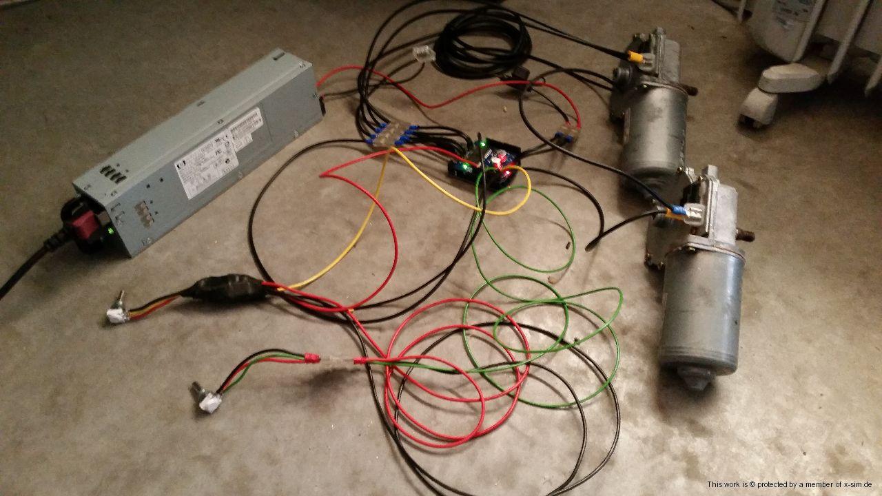

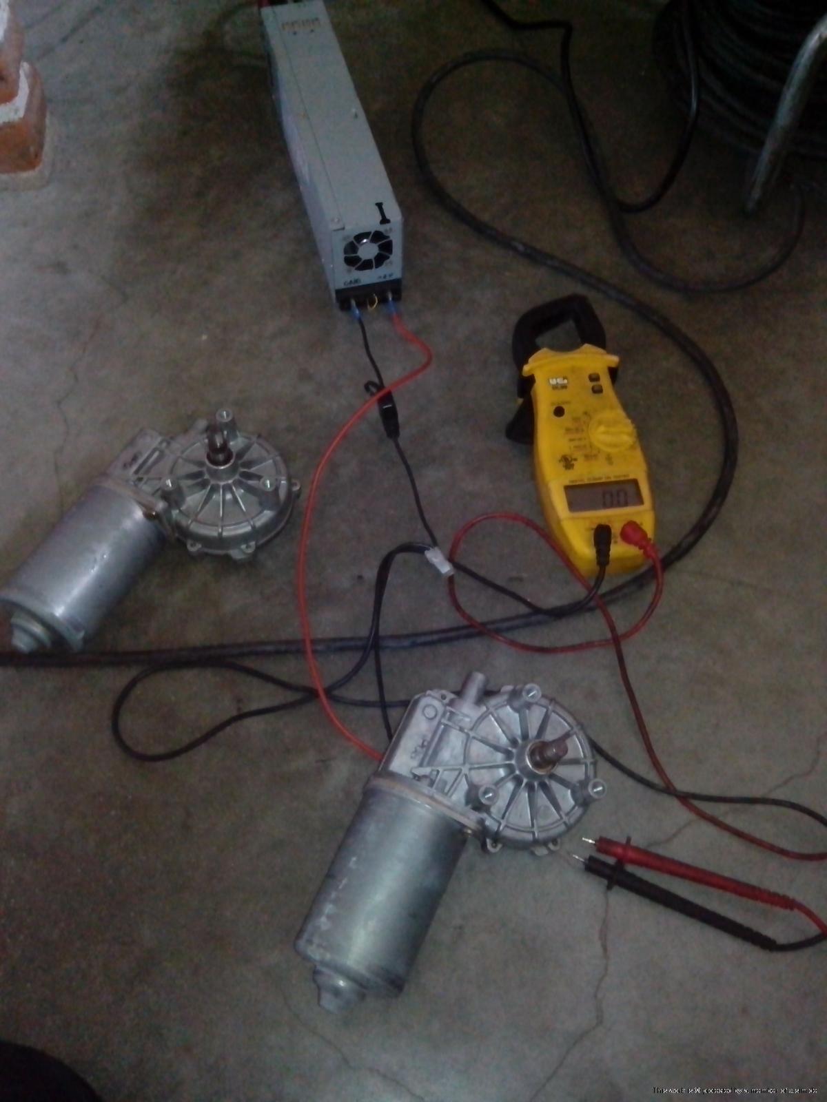

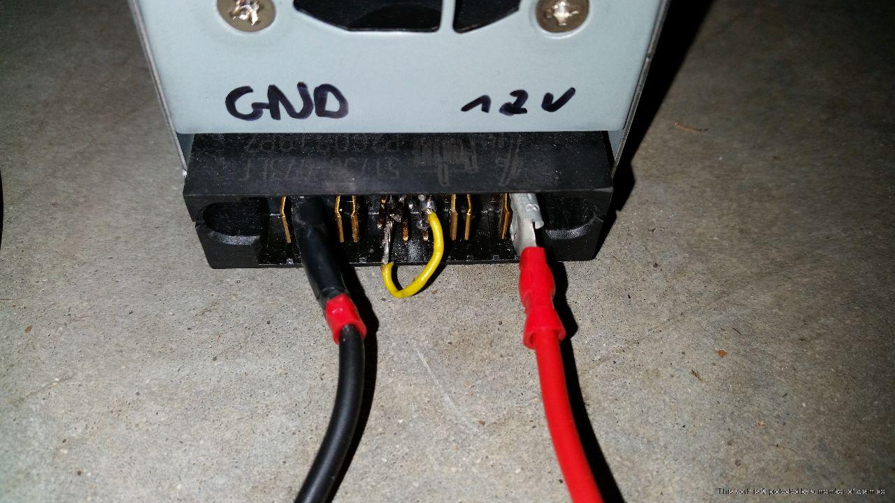

The HP Server DPS-600PB will not work if you don't connect some pins.
More information, you can find here: https://sites.google.com/site/tjinguyte ... ects/HP47A
3333
After I connected the pins, I had 12.6V.
I also connect Pin 4 and 8 of the psu.
(The psu powered on the fan started spinning at 100% without it. So I shorted pins 4-8 to reduce the fan rpm to minimum. The fan still spins up when needed but stays quiet when the psu doesn't require cooling.)
3373

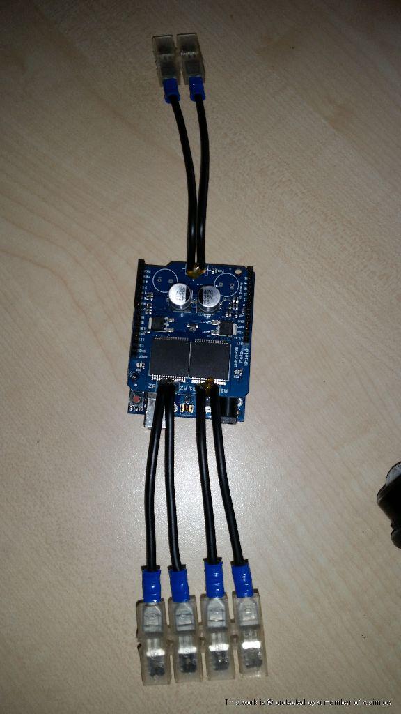

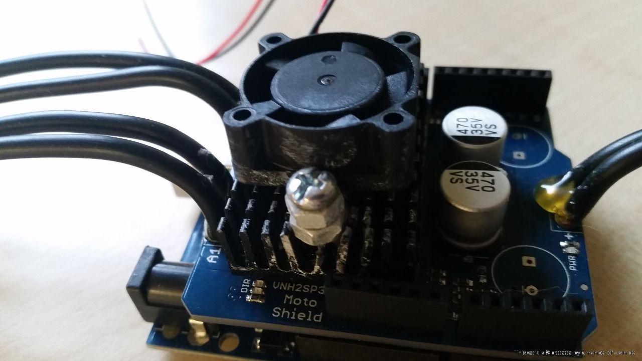

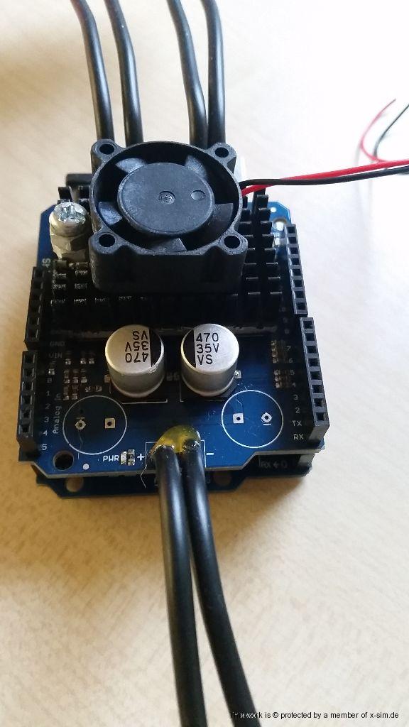

MONSTER MOTO
Place a heat sink on the shield! I have also a ventilator on the shield, for maximum cooling.
348834873486

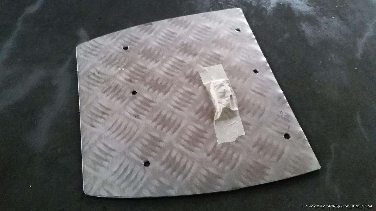

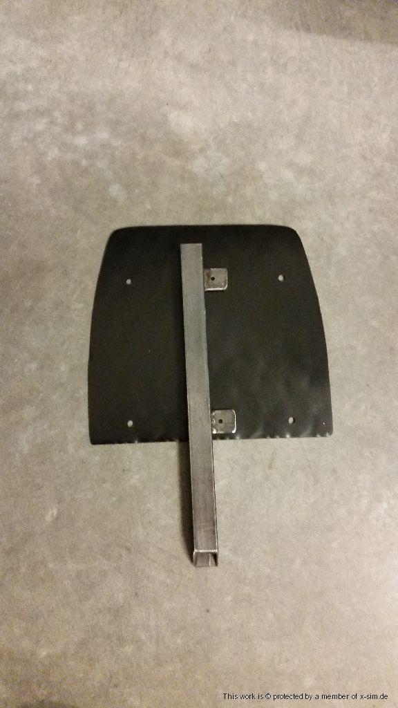

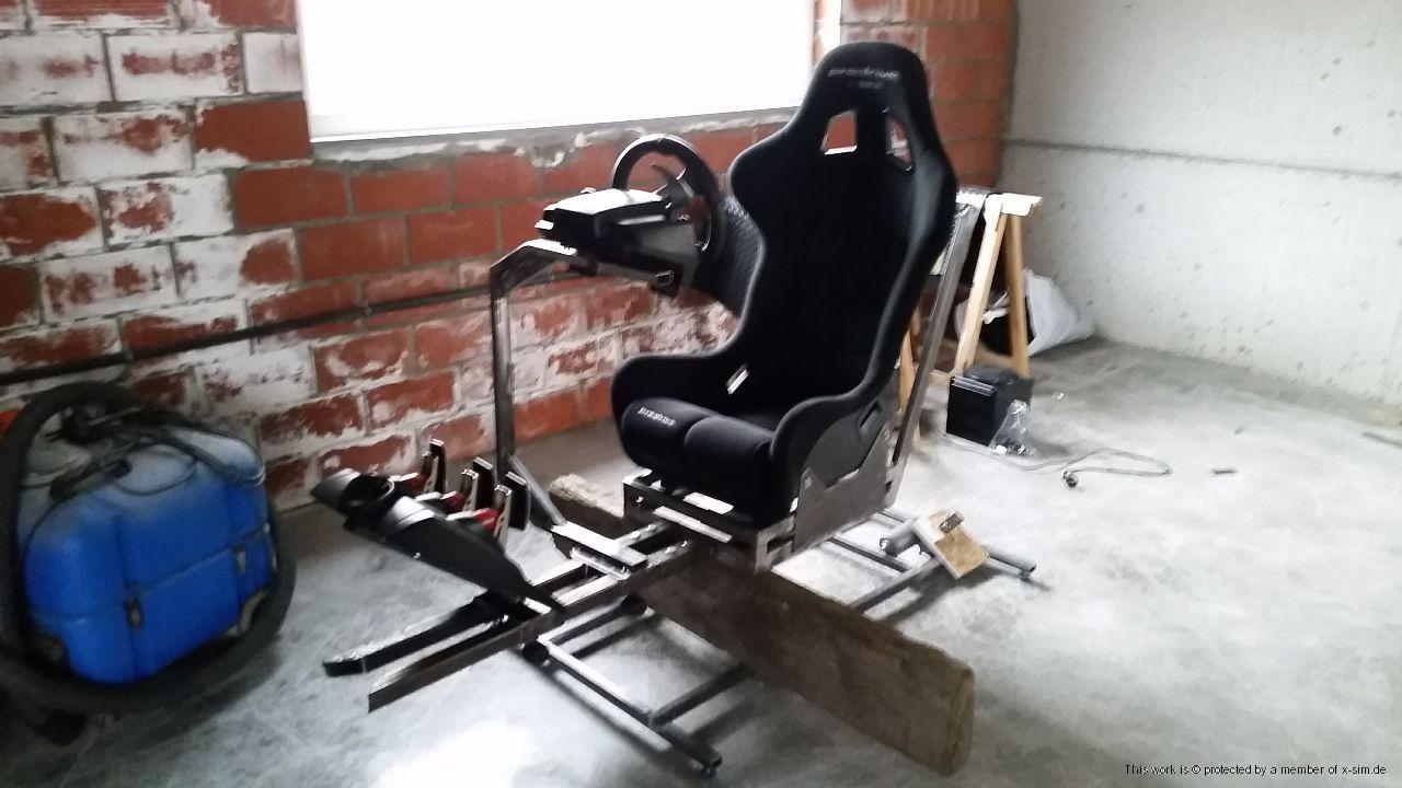

Mechanical parts:
The connection plate of my pedals
3489
3592

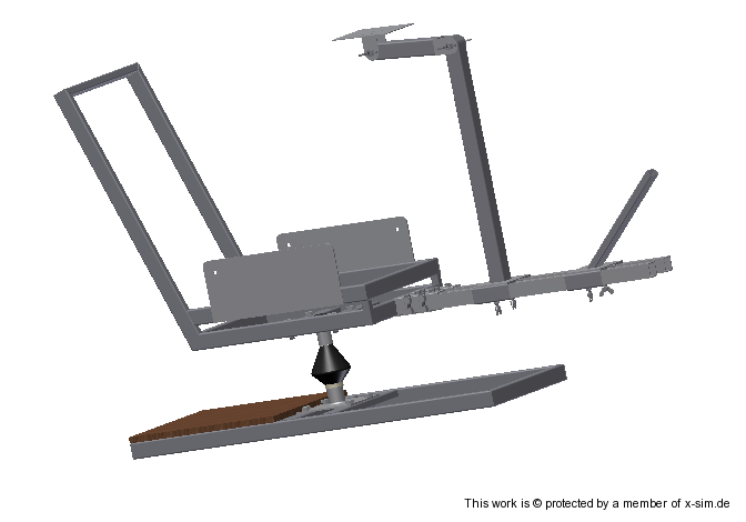

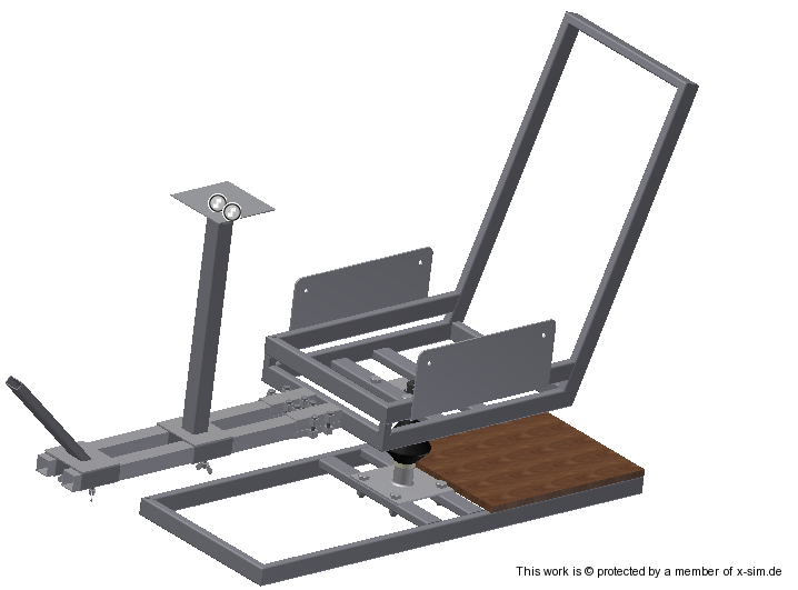

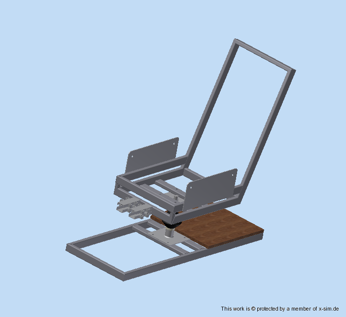

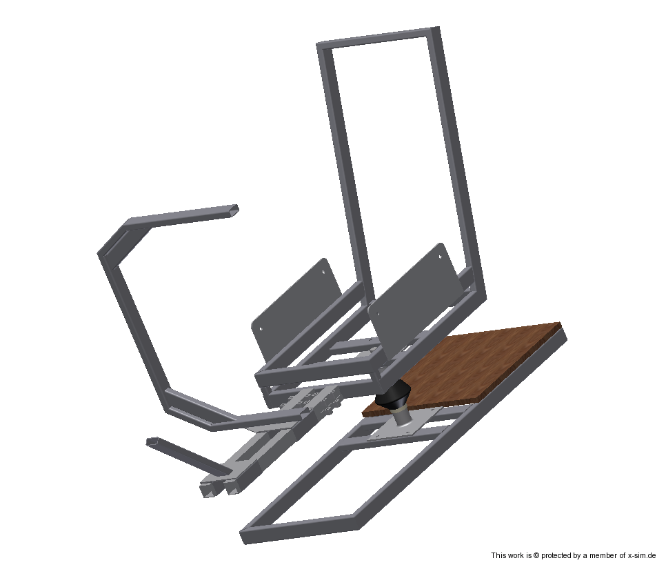

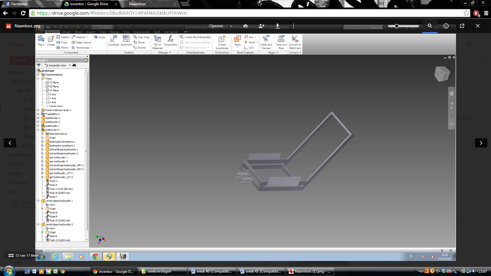

I’m working on the design of the structure. The complete drawing will follow soon.
This is one piece from what I have for the moment:
3332
I have already connect my server.
3333
And I have also tested my motors.
3334

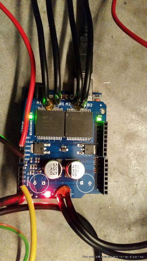

Postby arne » Sat 15. Nov 2014, 11:50
I received my Monster Moto, so I can connect everything
3374

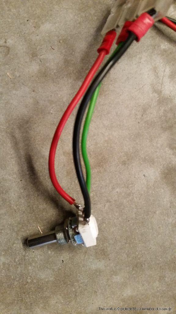

Also the potentiometers:
3372
And Pin 4 and 8 of the psu. (The psu powered on the fan started spinning at 100% without it.
3373

Postby arne » Sat 15. Nov 2014, 12:14
Test of the Arduino program:
3371
3370
https://www.youtube.com/watch?v=4s0hjElOCIE
Everything works as expected.

Postby arne » Sat 15. Nov 2014, 12:50
I bought this: http://www.benl.ebay.be/itm/32127879964 ... 1439.l2649.
This DC cooling fits perfectly on the Moto Monster.

Postby RacingMat » Sat 15. Nov 2014, 13:48
Your blue motomonster clone is fine! good!
