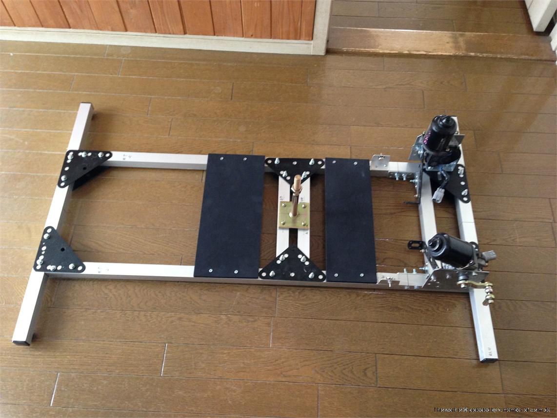

I made main frame by square aluminium tube. mainly by pop rivet & bolt and nuts.
I can`t welding.
3290
brack plane is wood.  I changed the posture of the motor later for dont disturb the moving of the upper frame.

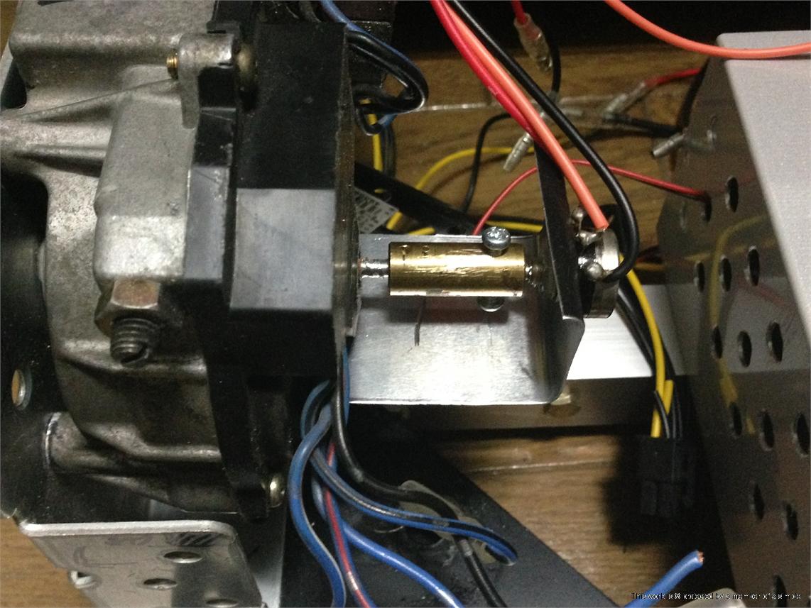

I made a machine along instruction of RasingMat basically.
3289
3287
Aruduino UNO and Motomonster
3294

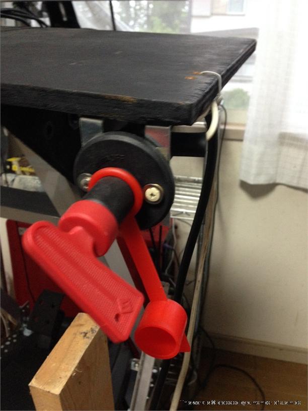

Emergency Stop
3292

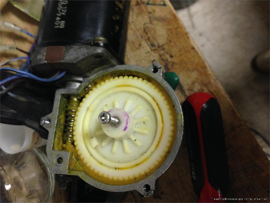

Tapping screw on the gear of the wiper motor. and this screw is connect to pot.

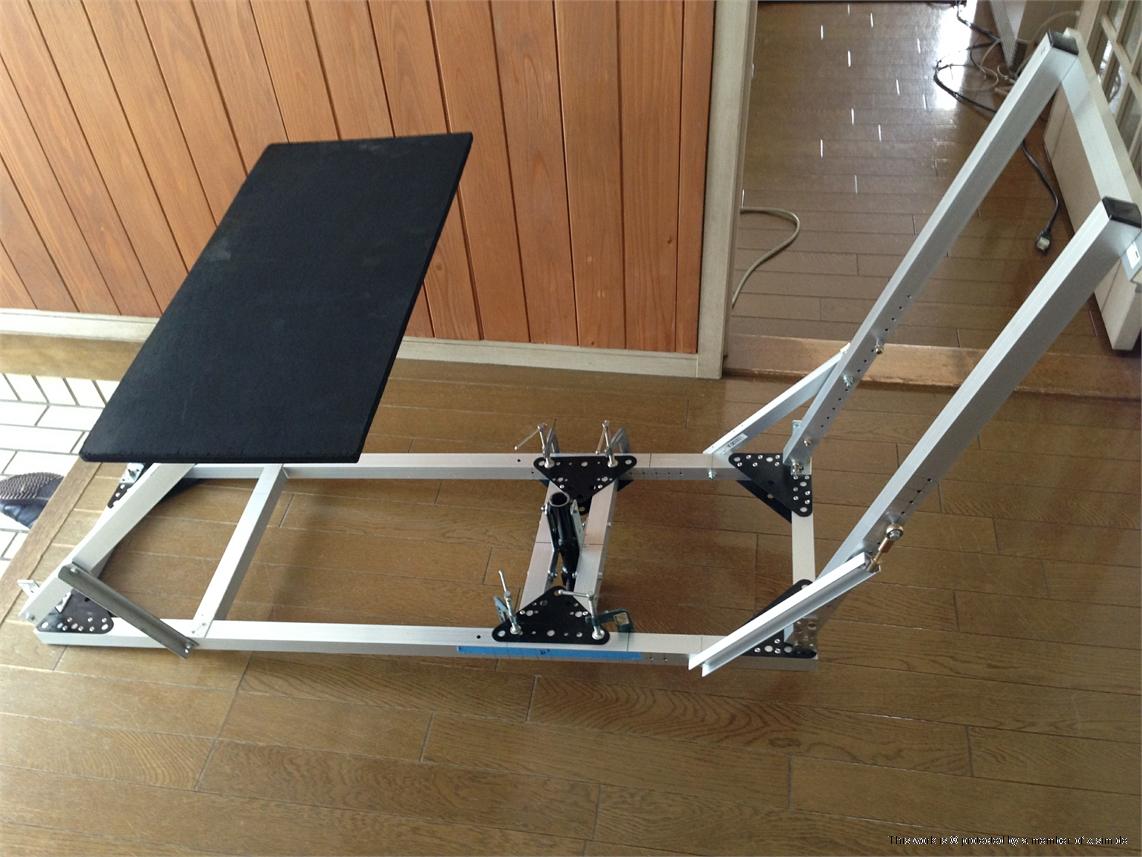

However, a new problem occurs.
The lateral rigidity of the frame is insufficient.Therefore it keeps changing its mind laterally. :P

Postby RacingMat » Wed 15. Oct 2014, 07:36
Woah! Nice aluminium project!
Thanks for sharing your building pictures :-)
I'm glad that my tutorial went as far as Japan!!
Well done so far :-)
Hum, too bad you will need to reinforce your structure...
Yours

Postby fledge » Wed 15. Oct 2014, 18:54
Hi Racing Mat !! Thanks for your advice. :P
I succeeded in reinforcement of the structure afterwards. :D
