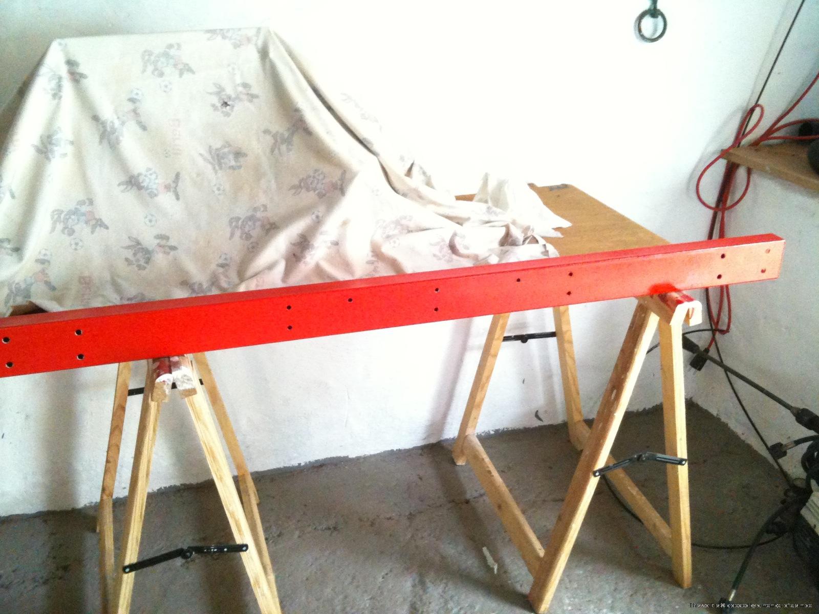

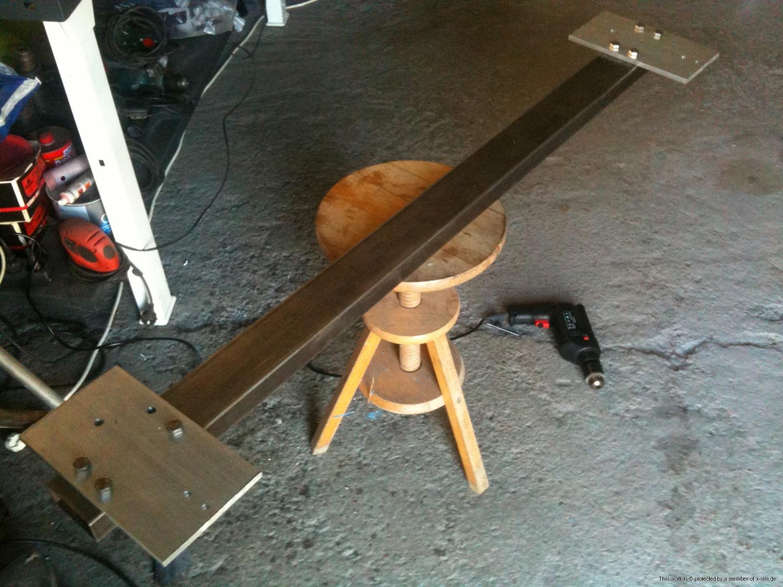

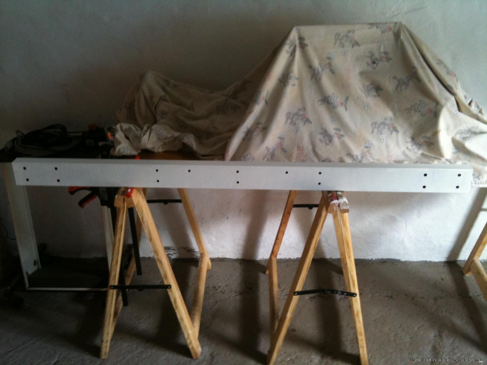

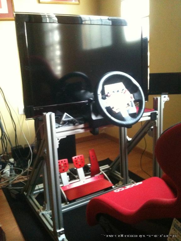

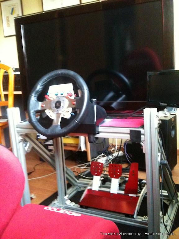

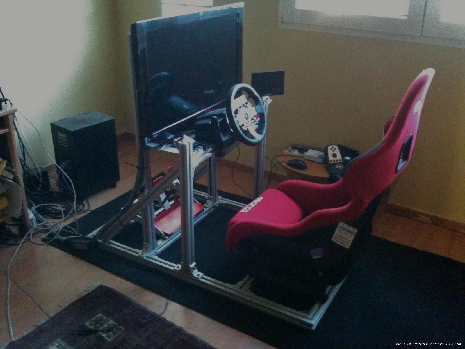

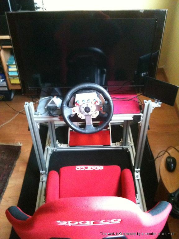

The Base
The base structure is that of my previous simulator once removed from my previous project. Is made of extruded aluminum profiles 40x40mm

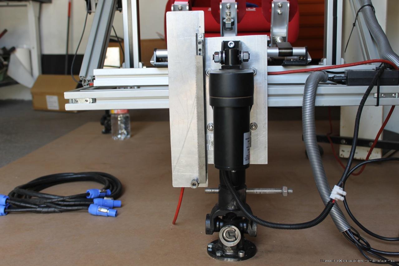

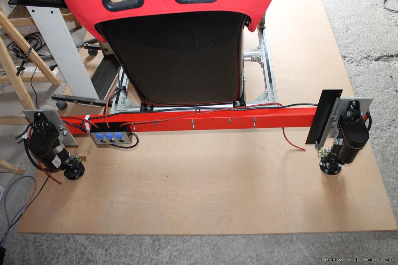

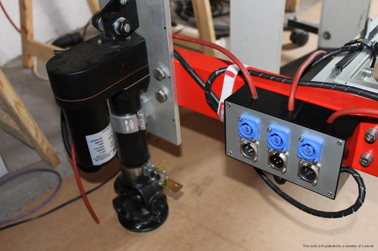

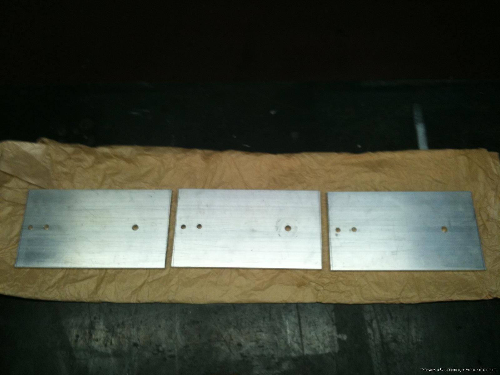

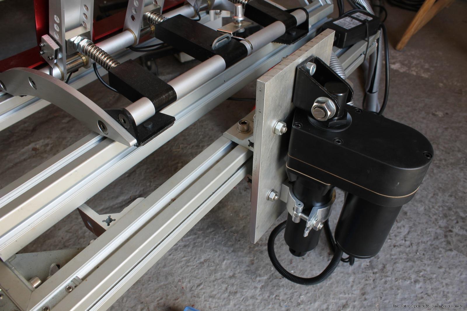

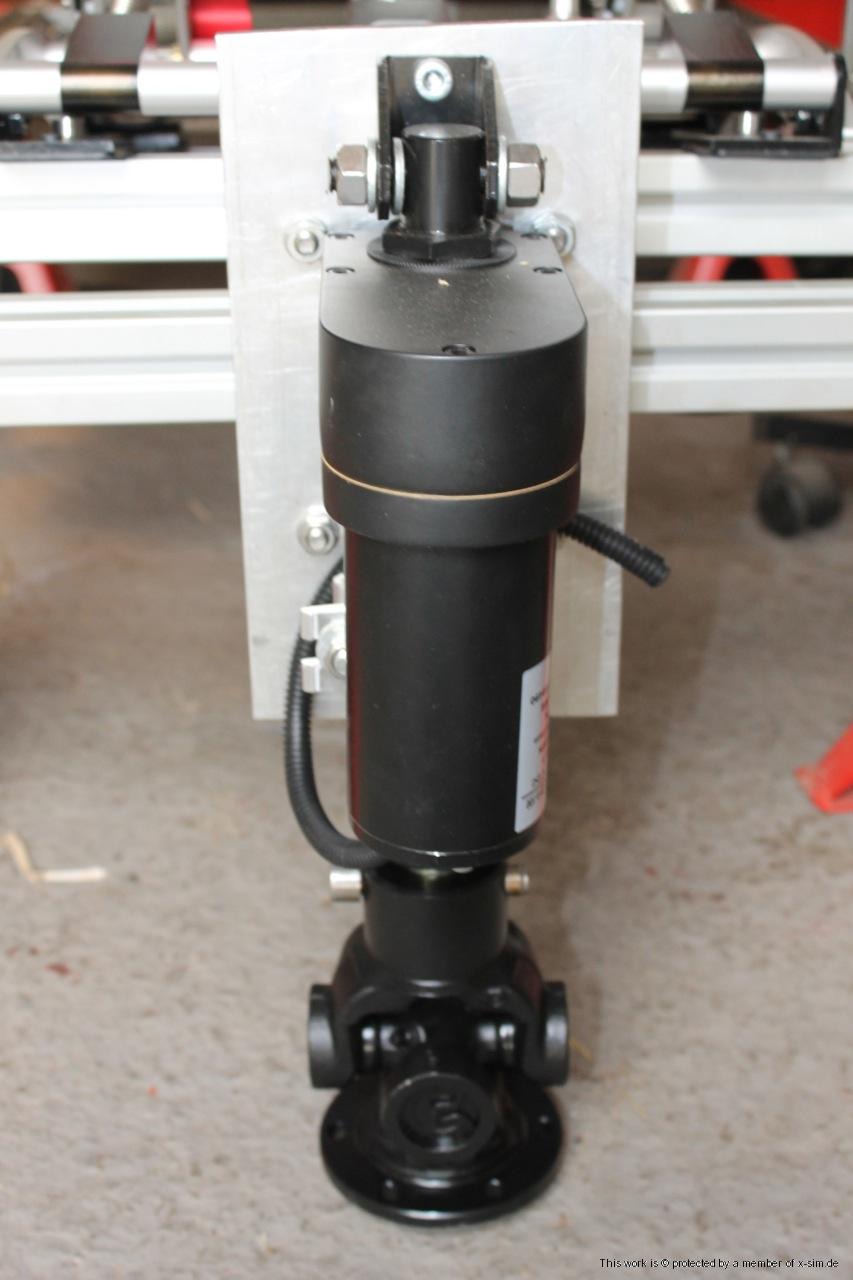

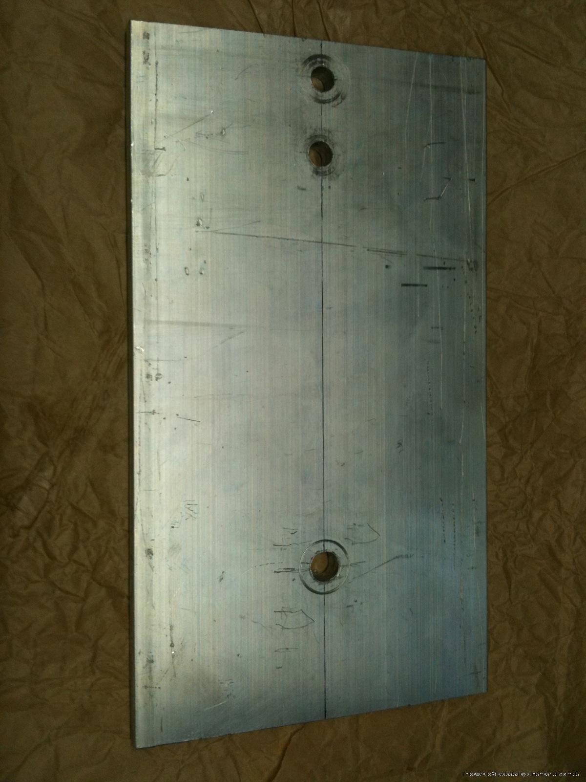

Installation of the actuators

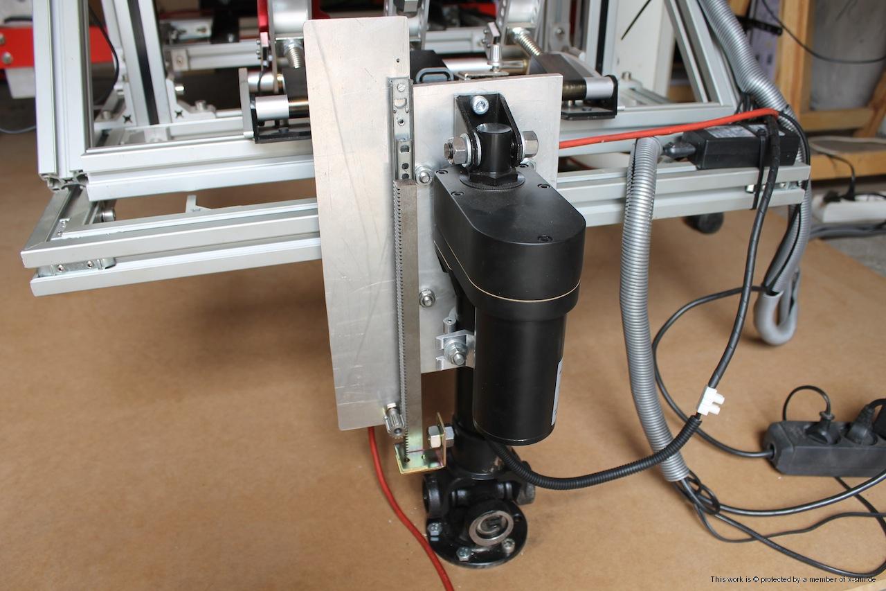

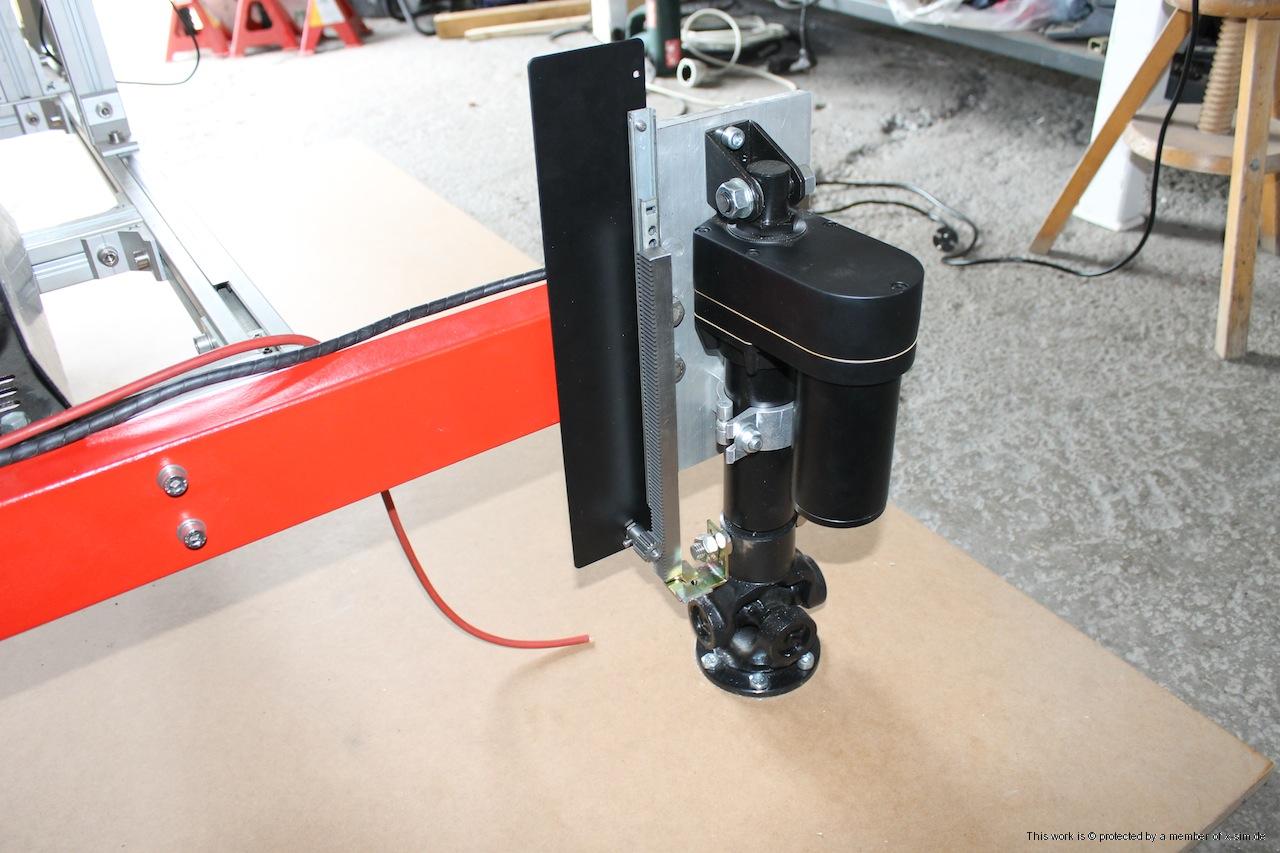

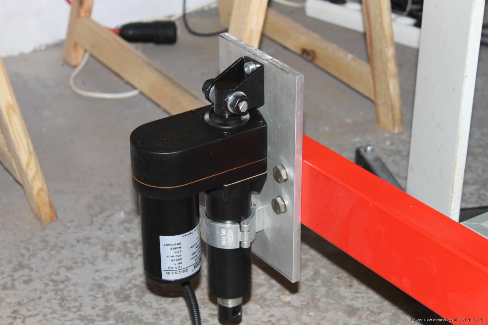

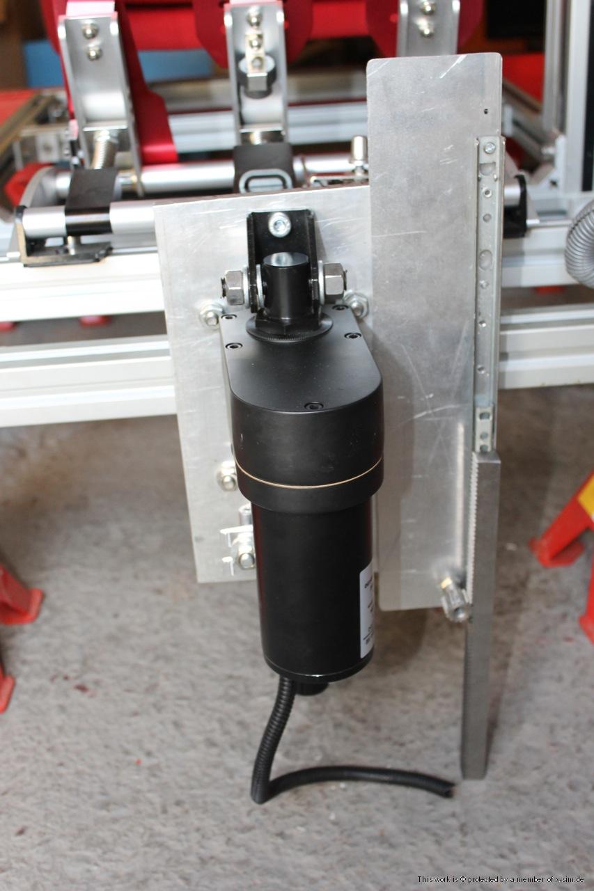

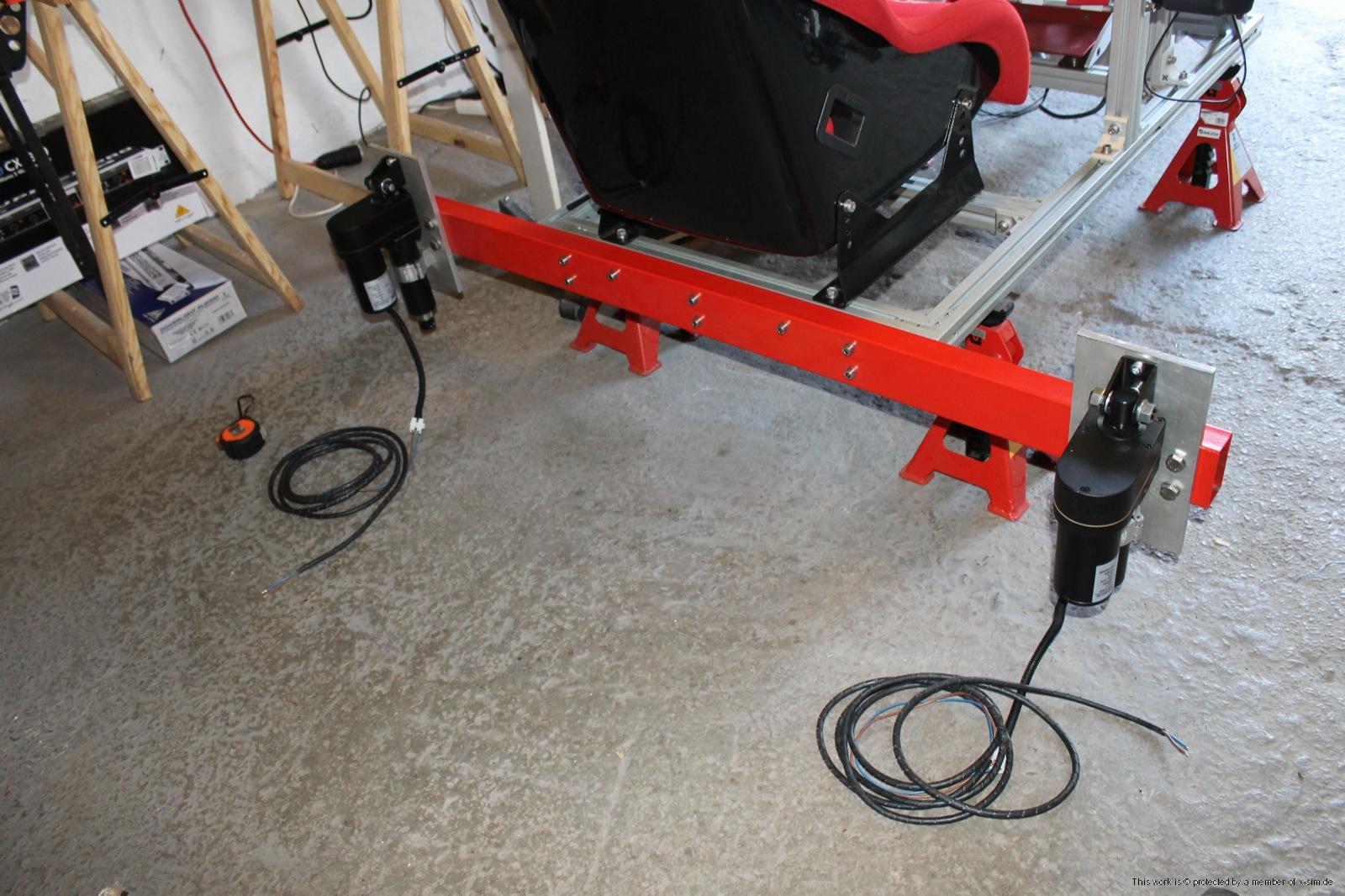

The system is equipped with two actuators at the rear, mounted on a square steel and aluminum plates.
193194196198
199184183

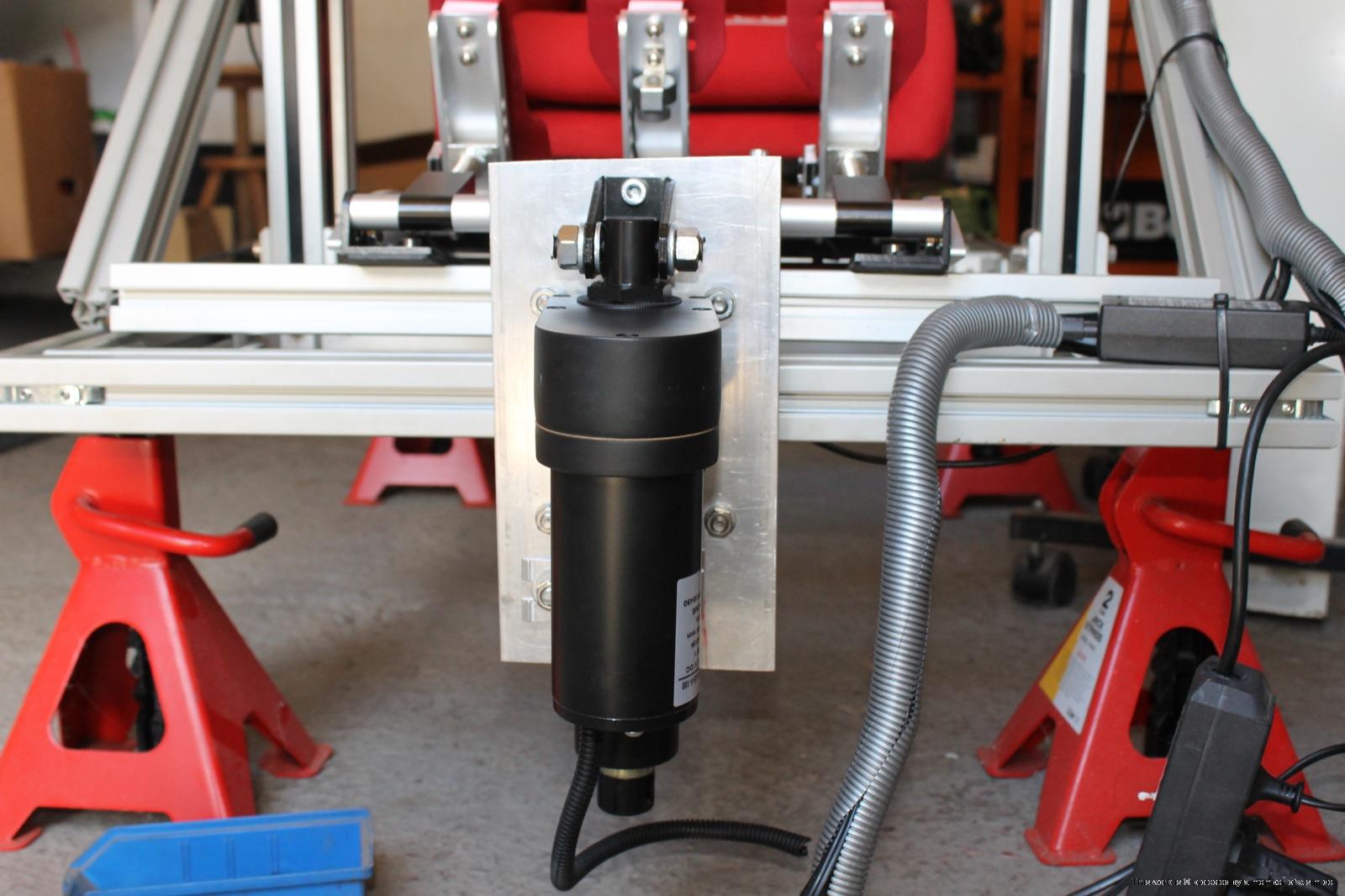

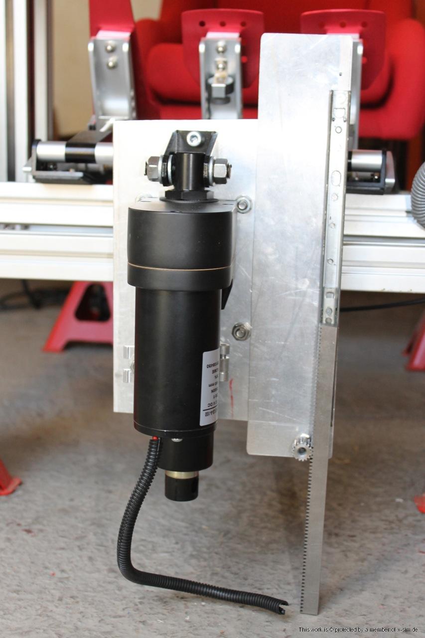

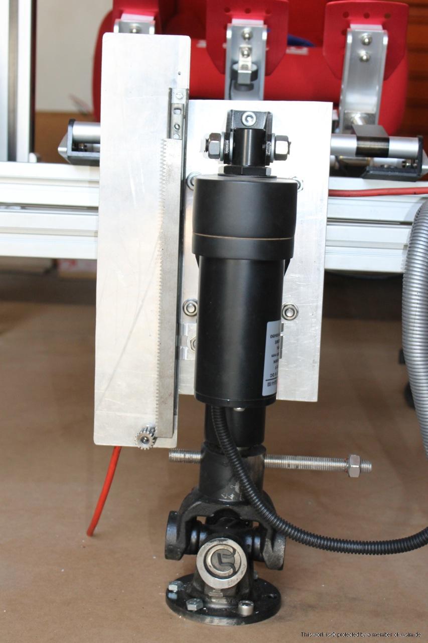

The front actuator is also mounted on an aluminum plate and have attached directly on the aluminum profiles.
192182181

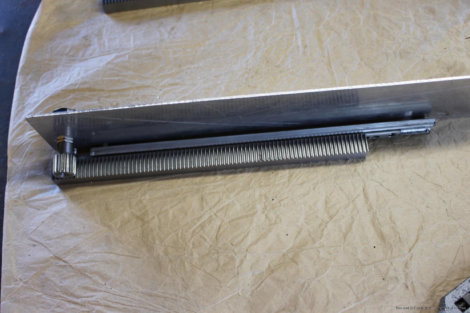

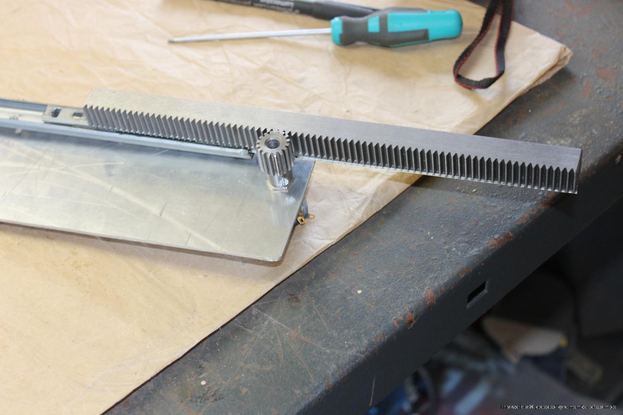

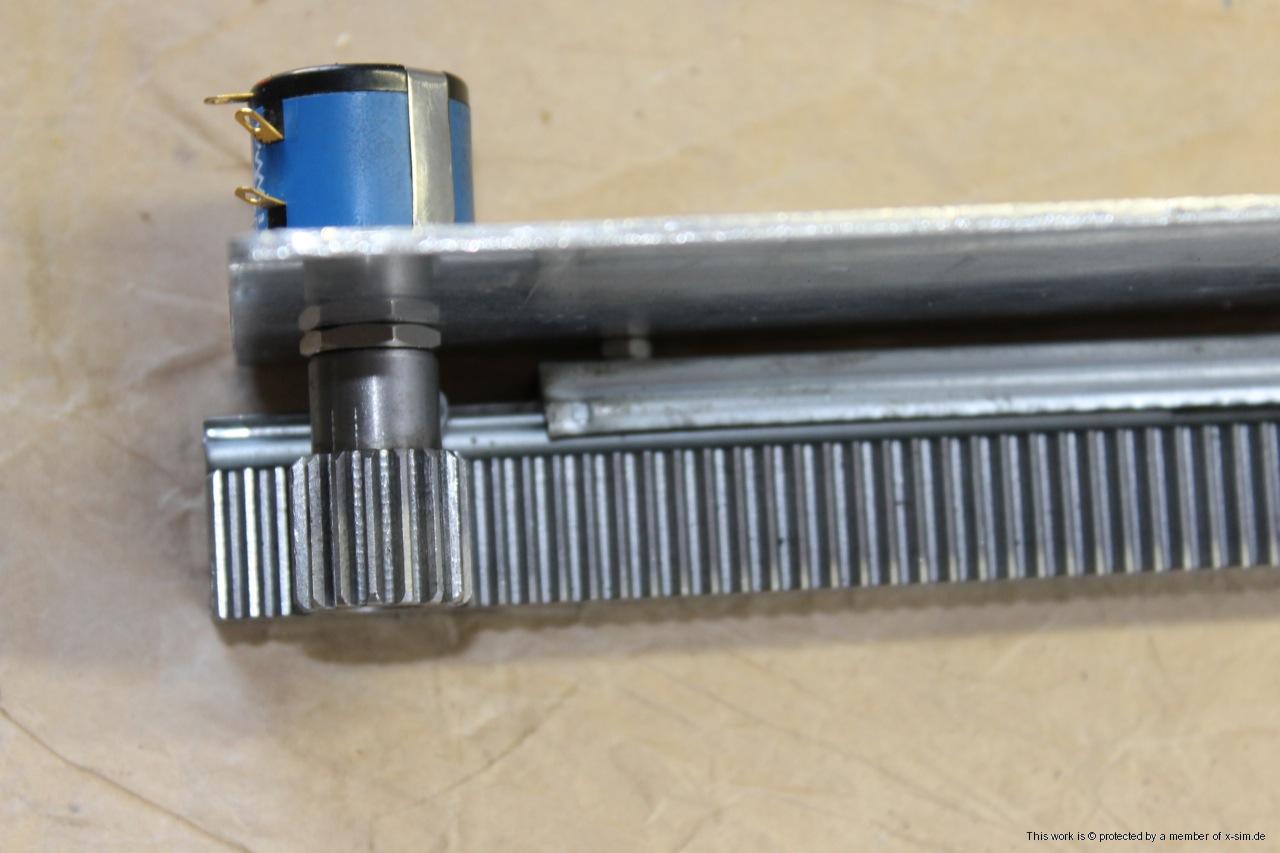

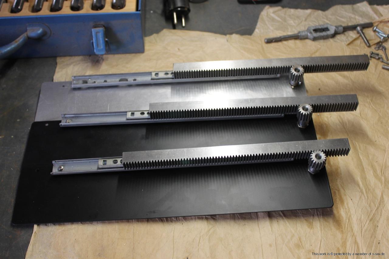

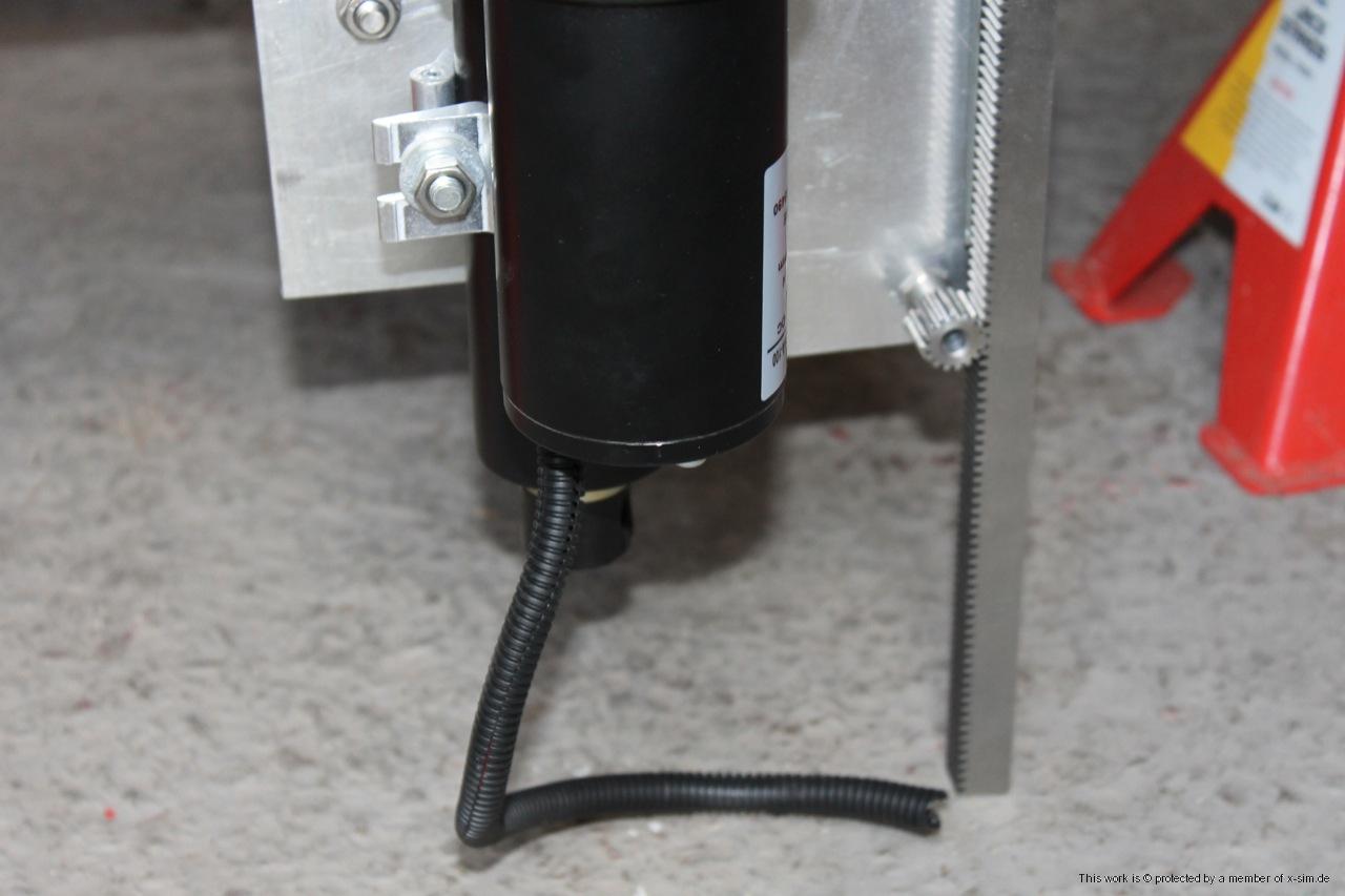

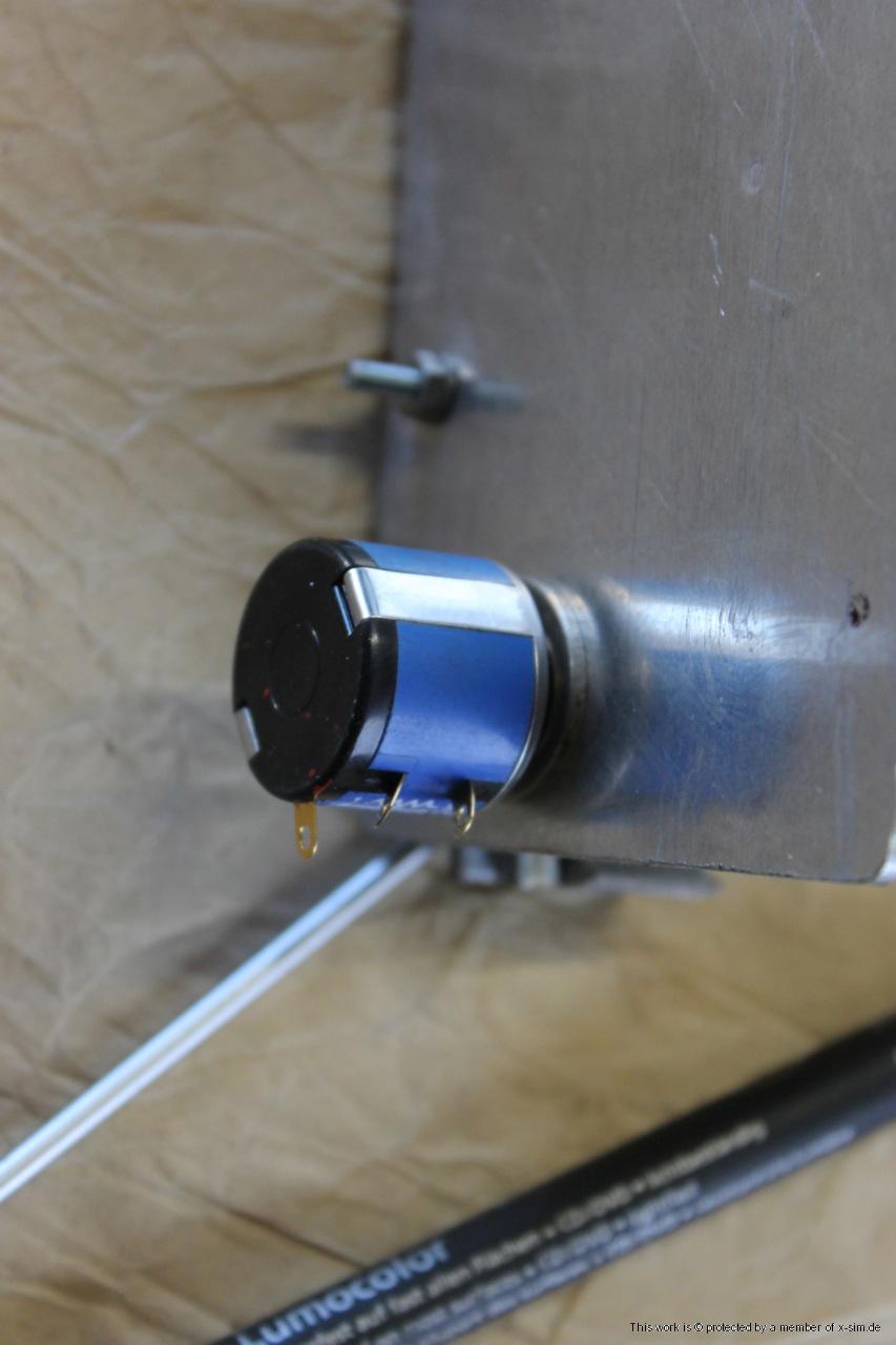

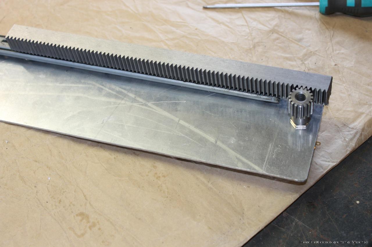

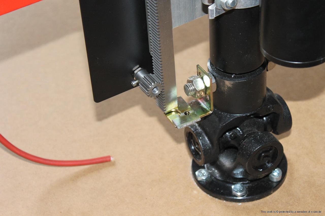

Install the potentiometers

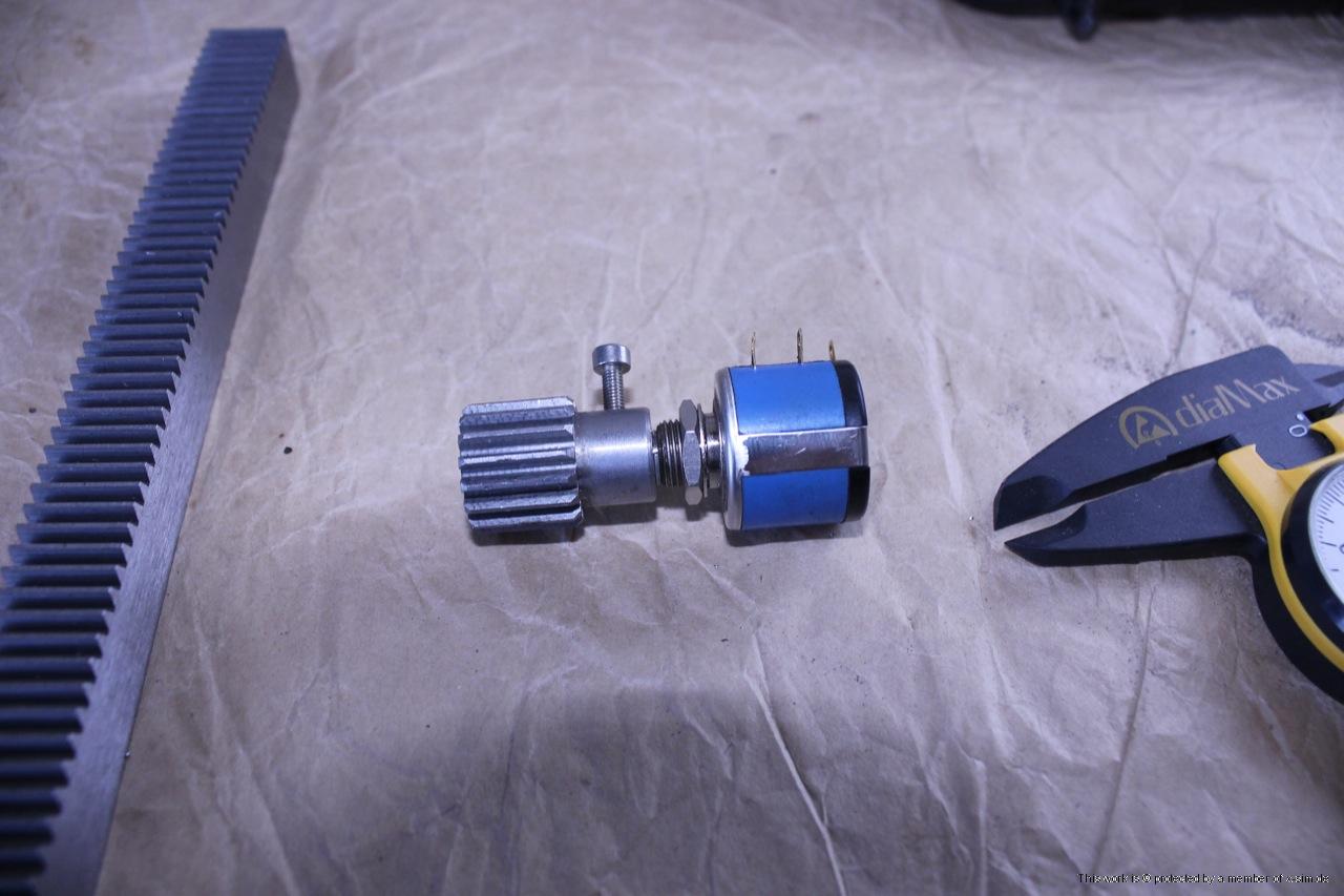

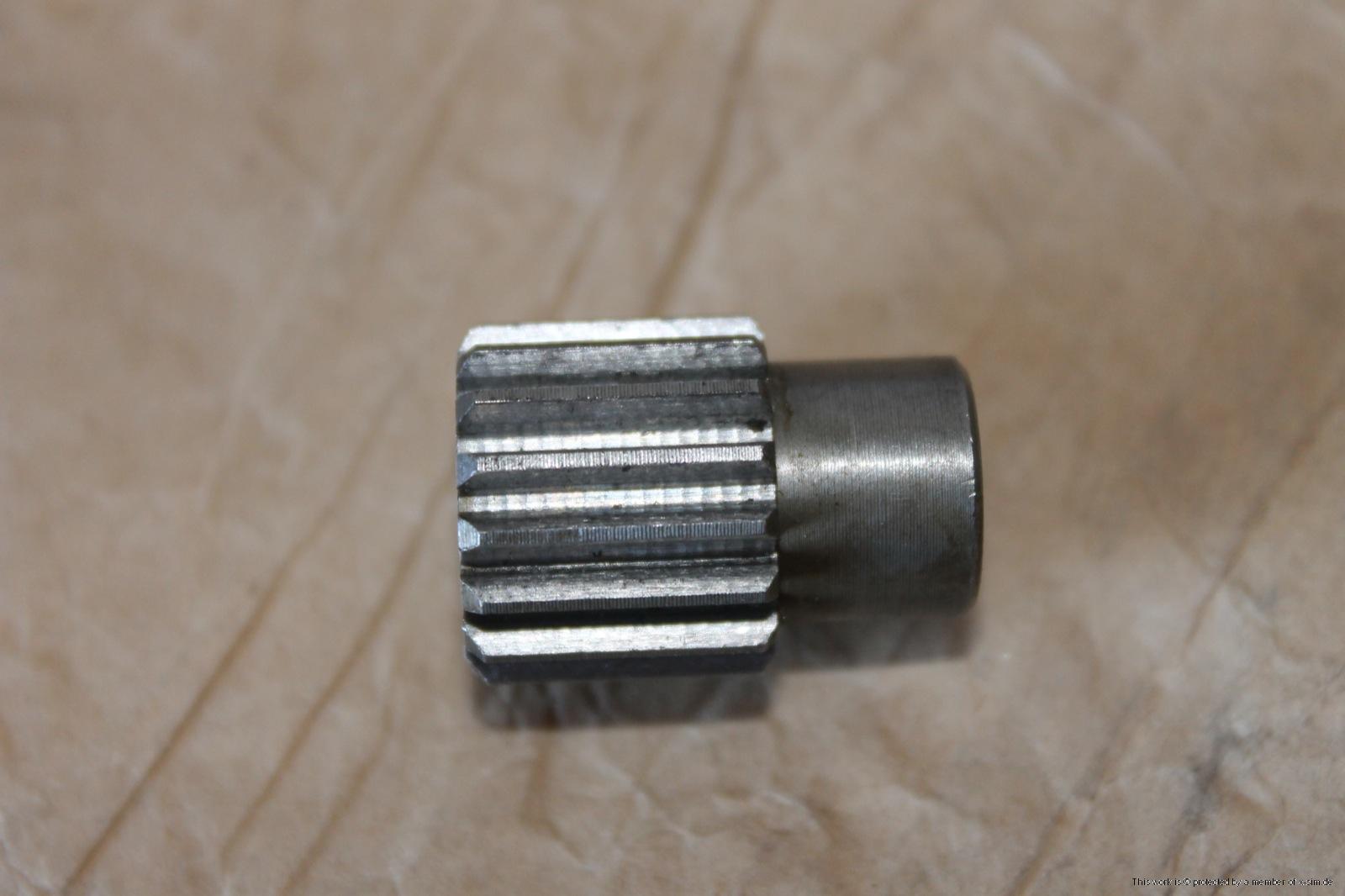

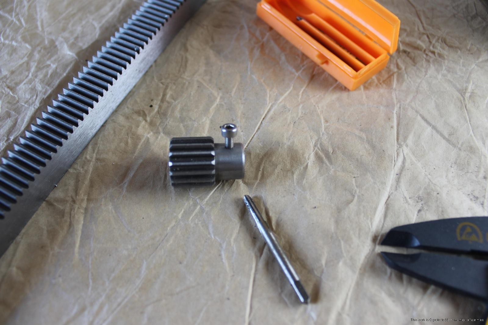

For installation of the potentiometers I will use a rack and gear system. If the plates of pololu JRK admit multiturn potentiometers, I'll use small gears, if not I'll use larger gears.
185186187205
206207208209
210211212

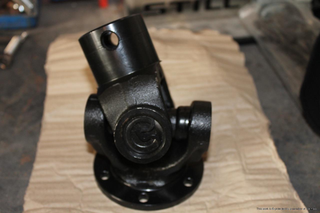

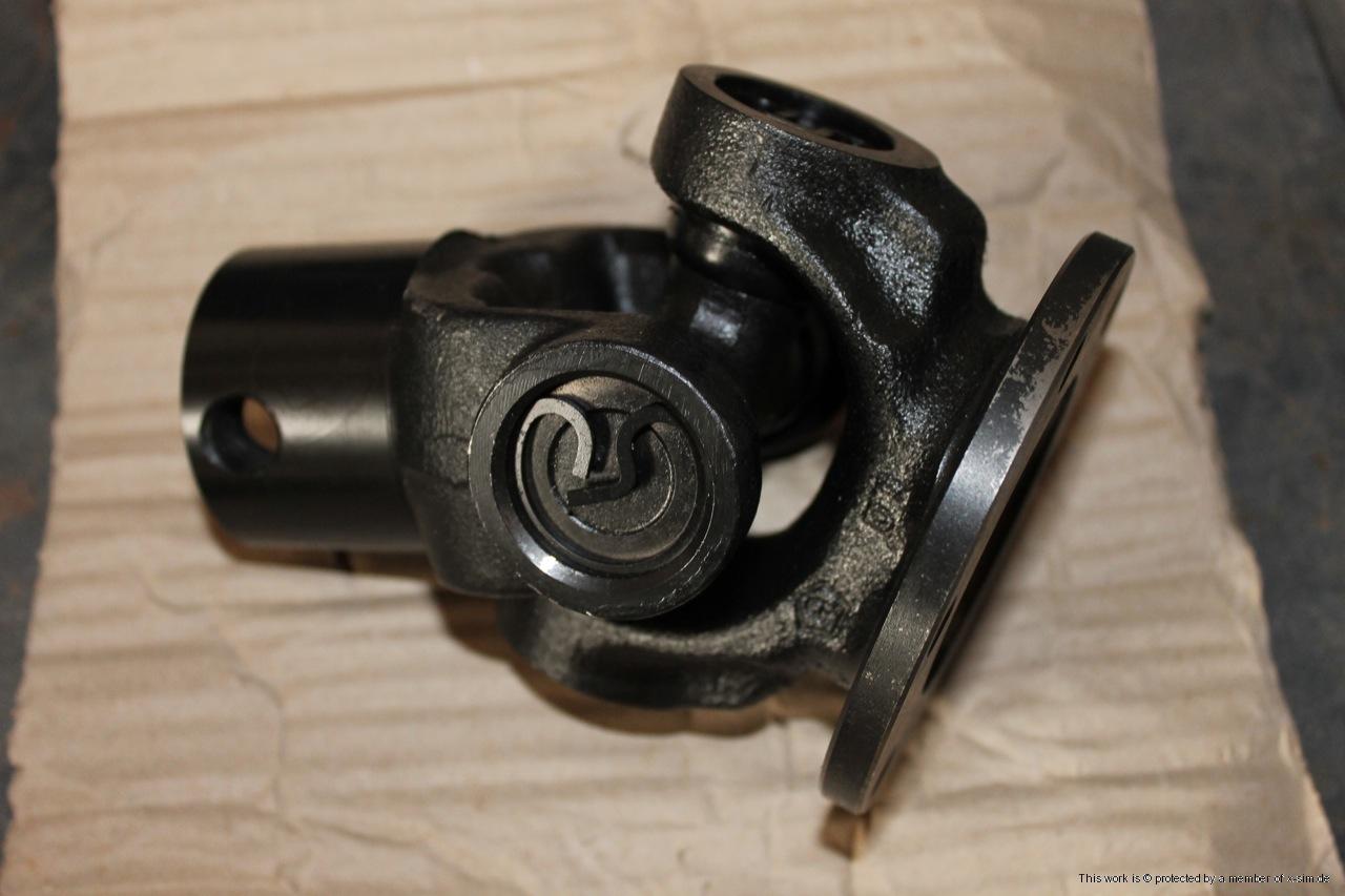

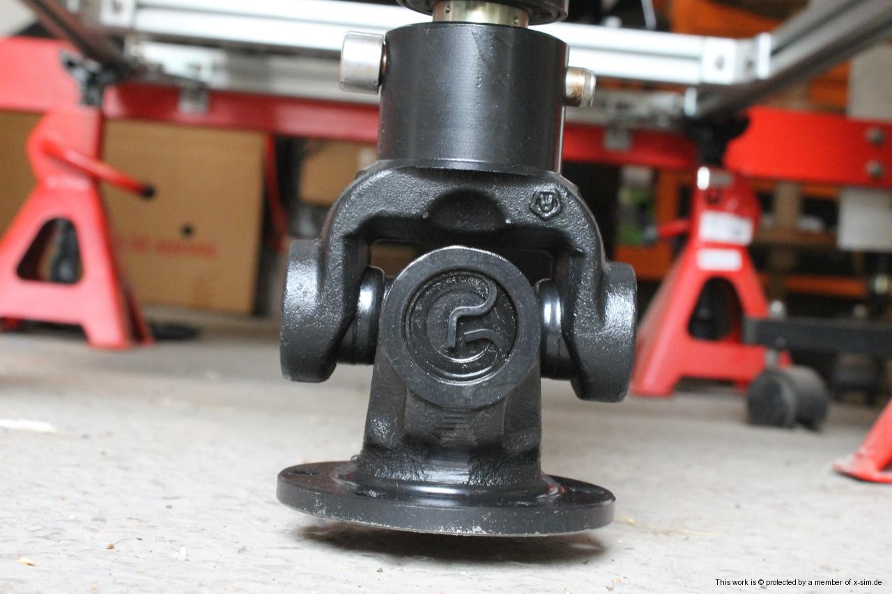

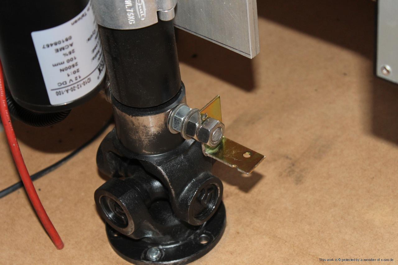

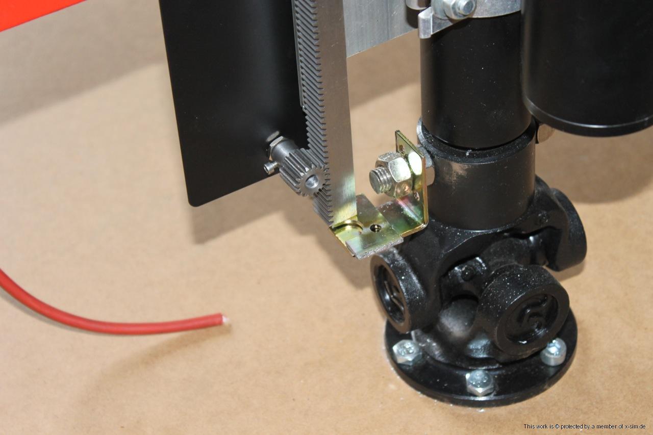

I have used Cardan connections to support the cylinder head, I used the pin to lock the piece that moves the potentiometer gear

As for pots, with actuators, a multiturn gives the best resolution. I will start with a big slider pot myself.
A 5K linear pot is best, be it single, slider or multiturn pot.

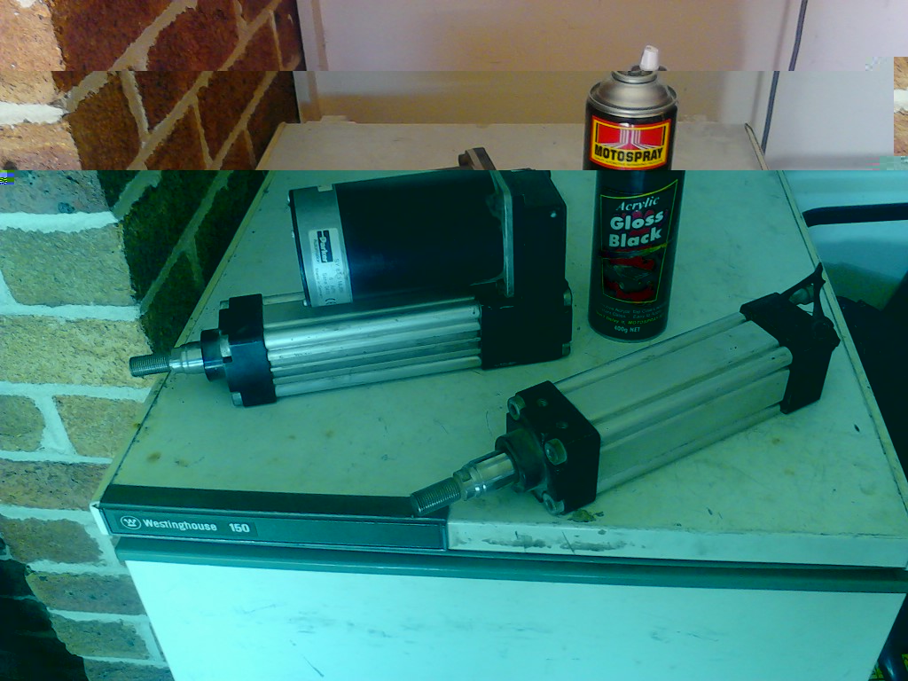

Postby motiondave » Sun 29. Jul 2012, 14:26

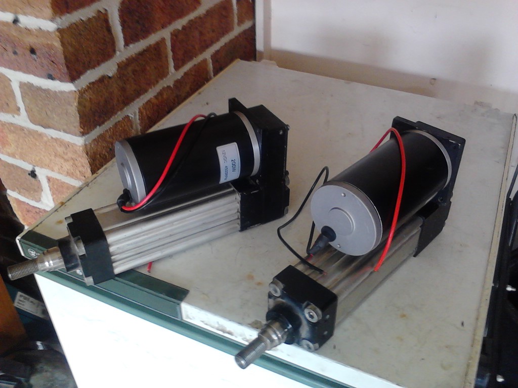

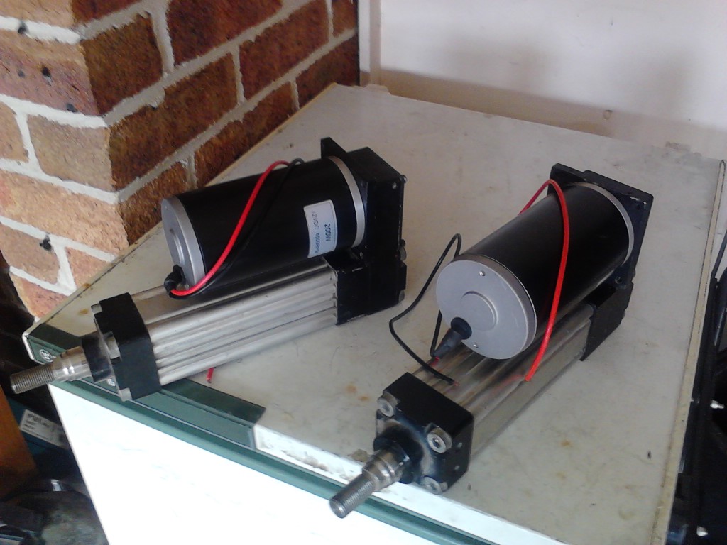

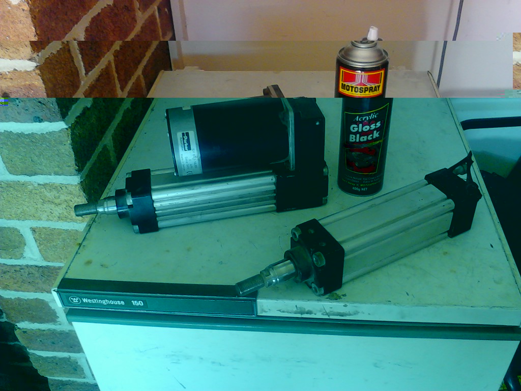

Heres the size of the actuators I am going to test, pity I cannot get some more, but you take what you can get.
You can see in relation to size of a big paint spray can. ;)

Look great. Seem able to move anything. Do you have any estimate of the speed of movement that can be achieved with the new 12v engine?

Postby motiondave » Mon 30. Jul 2012, 00:14
Txus wrote:Hi
Cheers
Jesus
The actuator throw is 100mm, so I am going for 180mm per second or less - loaded.

Yes, they should have the "f.... me!" motion for sure!
http://www.youtube.com/watch?v=DXUR-kTz6YY heres a result I got from it. I use 12v 200w 4500 rpm motors and got at least 200mm per second.
That and I sat some weight on them, they moved 40kg under motion no problems. Total throw is 100mm.
Pity I cannot get more, but I guess they would cost about $1100 each with no motors.
