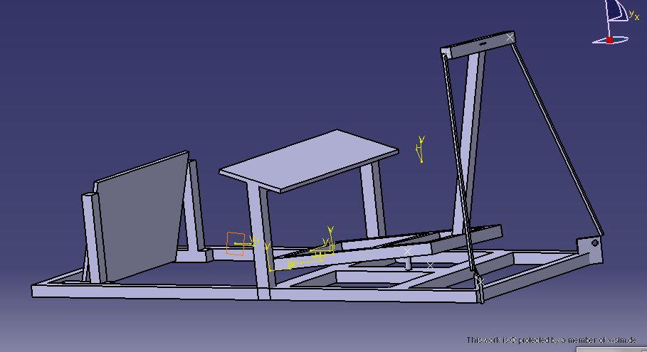

Now I got all needed parts and builded a first testmodel - the geometrie was tested in catia v5 (3d simulation). It's a copy and paste of all great working sim's here in the forum "thanks everybody".
