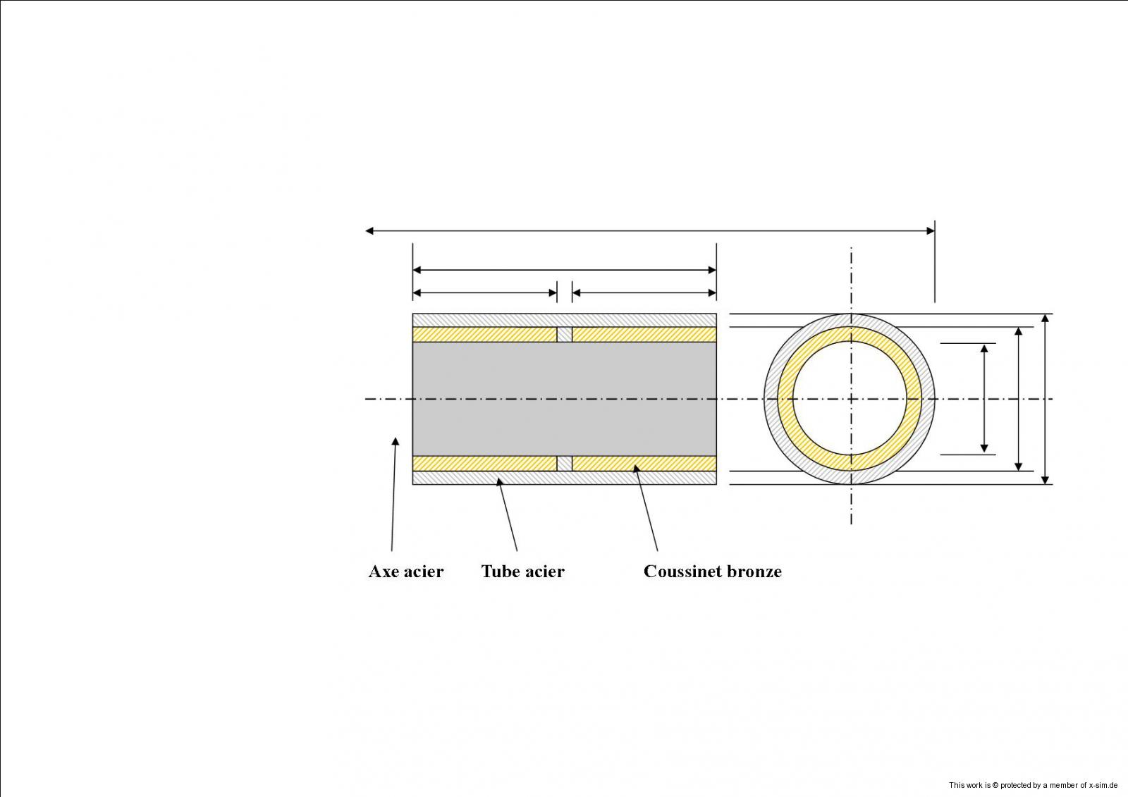

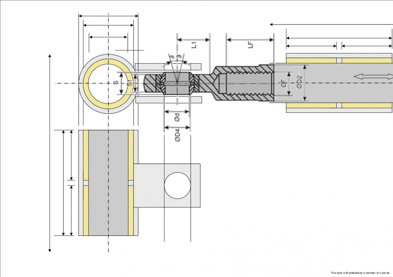

So you will find the beginning of the production:
Current work:
Design, layout ....
shots of moving parts:
764763762761760759
765[album]

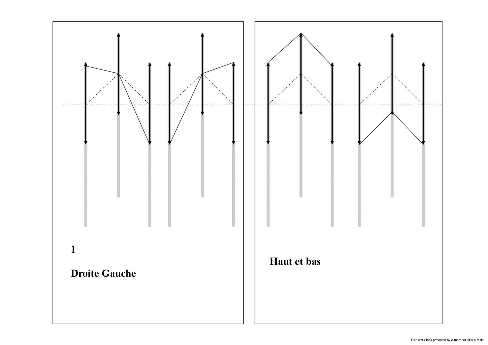

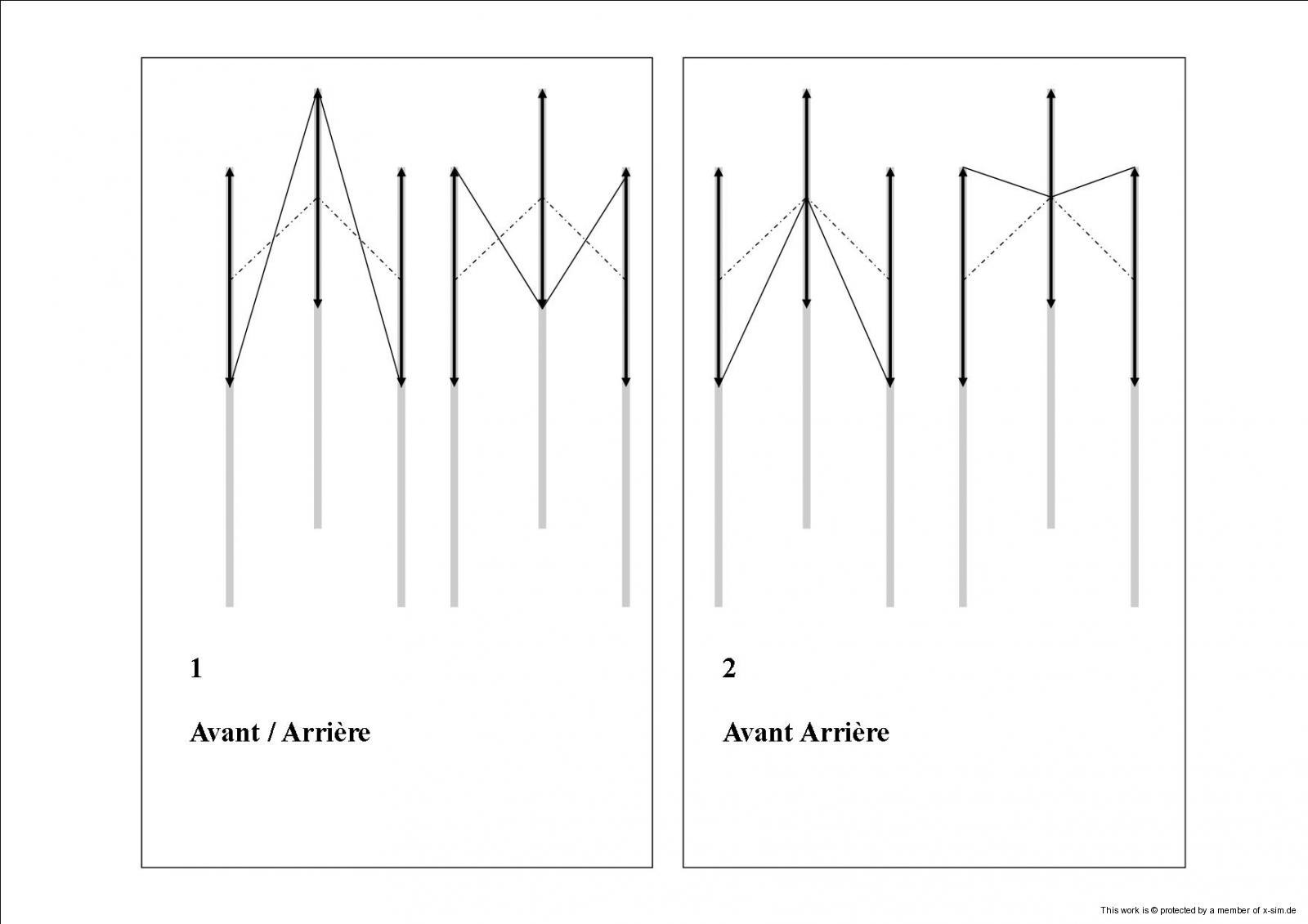

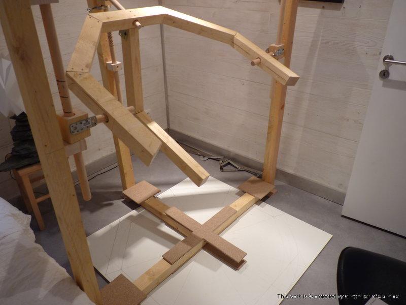

Postby Riton » Fri 7. Dec 2012, 14:51
hello,
I have a question because I'' ve a doubt about the correct way to determine the position of the axis in the directions:
to be on my axis to position I ask for your opinion:
To direct the cockpit right, left "lateral force"
top, bottom "vertical force"
front, rear "longitudinal force"
1 or 2 ??
781
for this, i think its correct :
correct?
782
