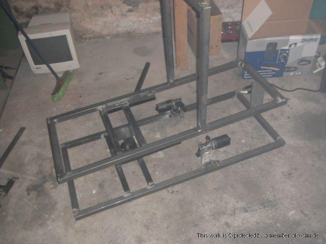

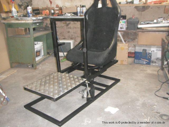

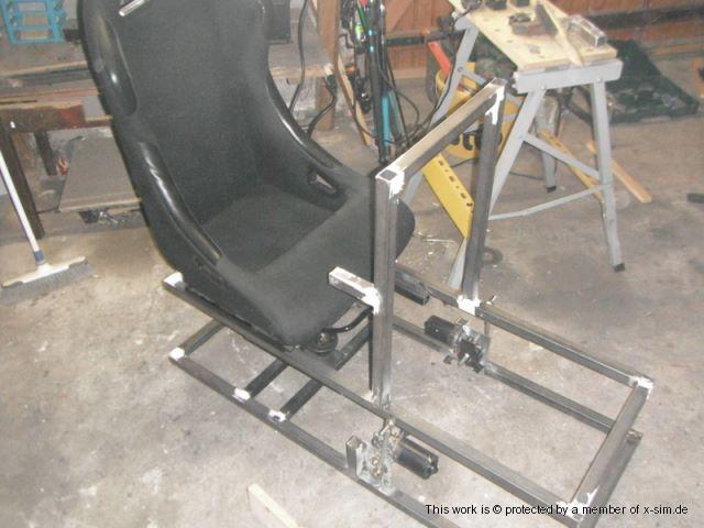

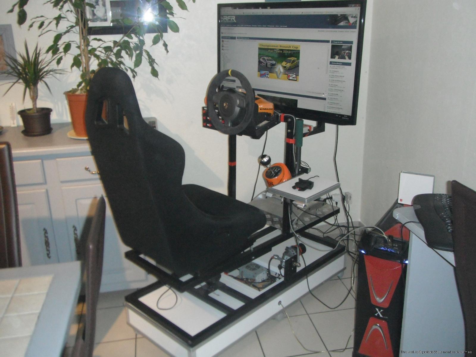

Hello, here is my new 2DOF dynamic simulator
1x VM110
1x sabertooth 2x12
pc power 500 watts
wiper motors
GT3 RS v2 wheel FANATEC
club sports pedals
Samsung 40 inch LED screen
1480
1476
1477
1478
1479
That all works well on GTL GTR2 Race07 Rfactor2 etc.
but I also would like to make it work with netKar Pro is this possible?
Thank you for reading my post.

Hi mate!
very nice Sim-Rig fore sure!
the only thing i would change, are the wipers. if you want to add values like "horizontal".
i also cracked 2 of these, the next 2 are also a littlebit laggy again. I`ve ordered Big Worm Geared Motors with 180W. This should work.
Finally you can say --> when your profile is finished, your wipers are down .... :D
Look at mine: http://www.x-sim.de/forum/viewtopic.php?t=429 (also VIDEO inside)
best regards

Postby arno88 » Mon 29. Apr 2013, 11:39
Hi Mario, I do not encounter any problems at the moment with my engines, by cons when I put my stuff at 100% I have my VM110 card it disconnects randomly.

Postby motiondave » Thu 9. May 2013, 06:19
Wiper motors can last and or be destroyed.
It can depend on several things,
design of frame
balance point
power used
profiles and harshness
the wiper motor in the first place
I have destroyed wipers in the past on frames, but then again, I have had them survive fine.
The thing that has helped me all my wiper frames was a spring of about 3kg tension.
the spring was not used for balance. The frame was properly balance first.
The spring was used to create a light load against the wiper, helping keep the gears meshed without affecting motion.
With wipers, as the gears are soft and not designed for thrashing back and forth, the slight pressure on the gears kept them snug, so when they are being reversed as they do on a sim, they lasted longer.
Now I use big worm gears this is not needed. Just balance the frame and go racing. The big worm gear motors are more than strong enough to survive sim abuse.

Hi Arno,
Congratulations!! ;)
Nice job , very good finishing !!
Super boulot , félicitations :D
