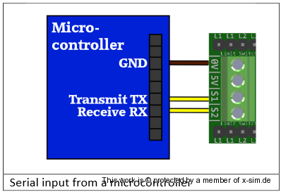

So I can use any USB to UART Converter :)
but I can't find inside the Kangaroo's specs the voltage of RX/TX pins: are they 3.3V level or 5V?...
(the device you linked is voltage configurable :? )
and plug it like this 2860
and so you confirm that I'm not forced to use DLink2 and its piece of software "Delight"...
