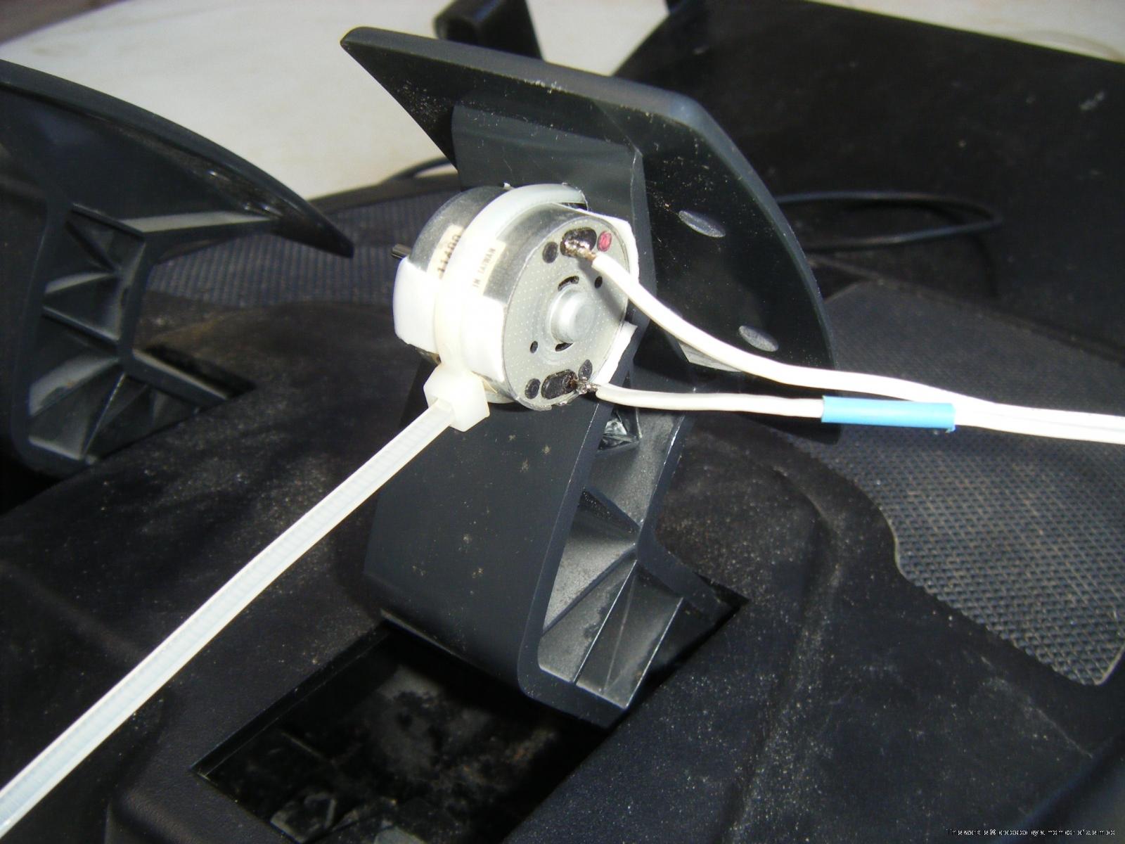

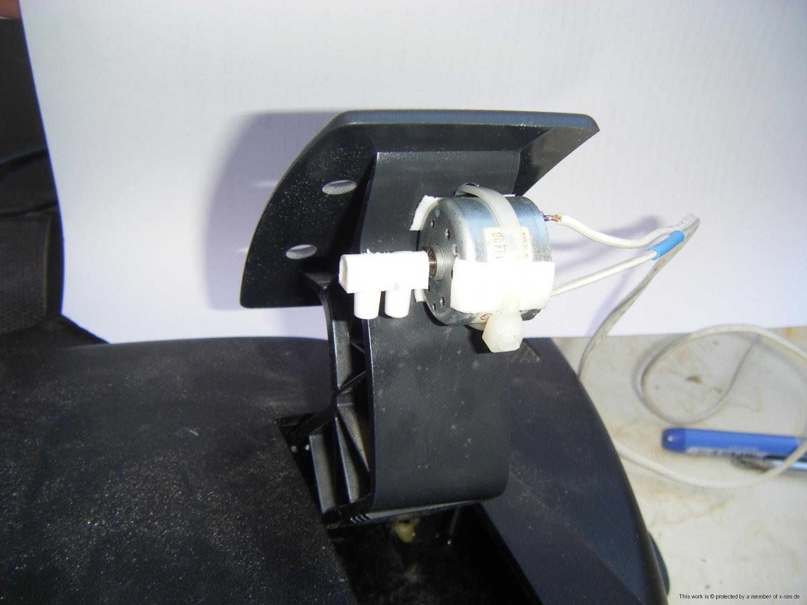

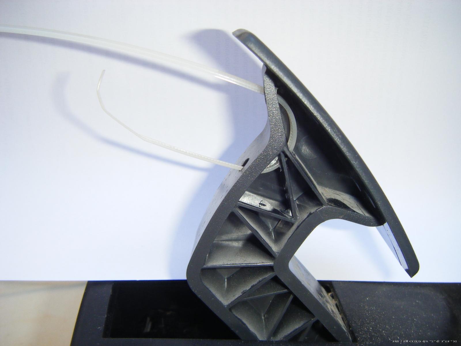

fixing the motor under the brake pedal
2596 2597 2598

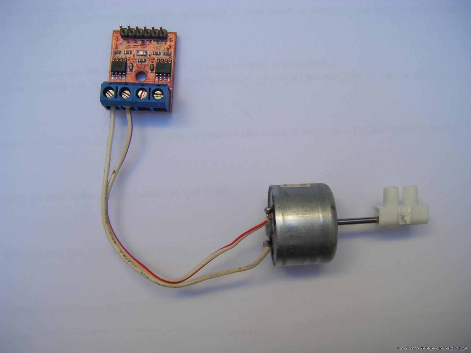

Hbridge to control the motor 2600

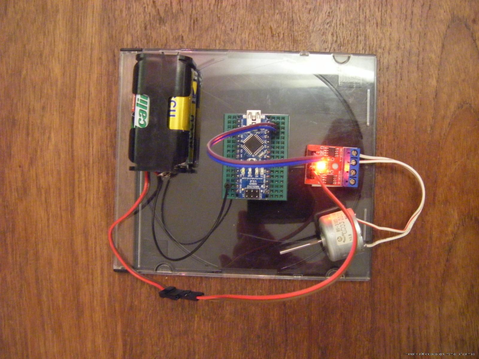

Electronic: arduino Nano, Hbridge, battery 2599
but as I said, motor is maybe not powerful enough or Hbridge not efficient enough:
I wish to try a linear actuator such as solenoid actuator
Does someone has experience on linear solenoid?
Mat
