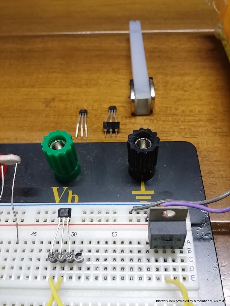

4129
this Picture shows the a1302 on breadboard with regulator.
Two more a1302 resting on the top. Readings are the same.
As long as I know (I dont know much really :) ) quiescente should read half of 5v or half of 5v less the voltage drop. But no almost 3v (2.95v)
Is it normal?
