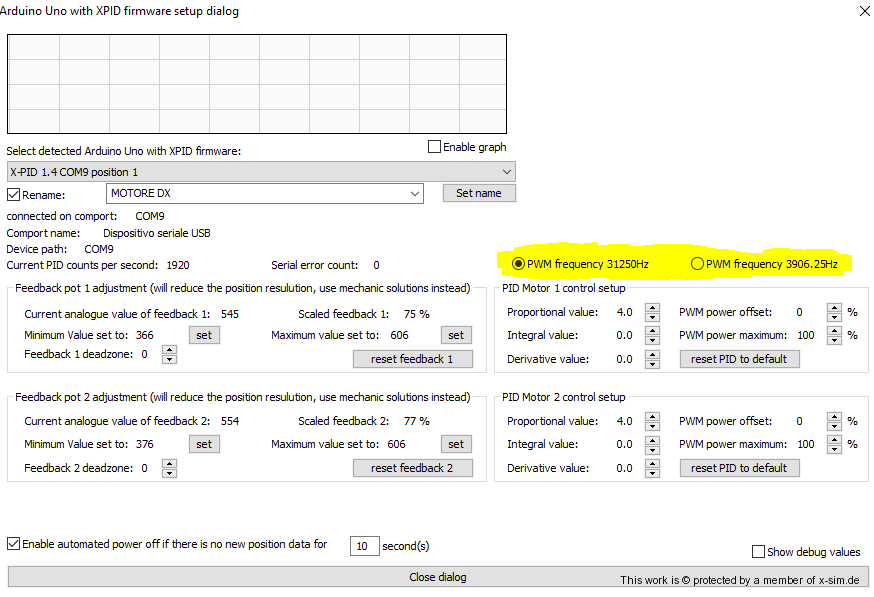

Hello sirnoname, which button? You mean this?
4240

Yep, the small arduinos are limited with frequencies. Bigger ones can do more accurate switchings.
Re: Arduino Open Source X-PID firmware incl.360°option
Postby kevin123 » Tue 20. Dec 2016, 12:14
Thank you for your reply and sorry for the delay.
so the problem is one that Arduino is limited, even though the code would change the frequency not the would manage the appropriate way, I understand you correctly?
What would you recommend me to solve the noise problem in the engines, arduino mega?
