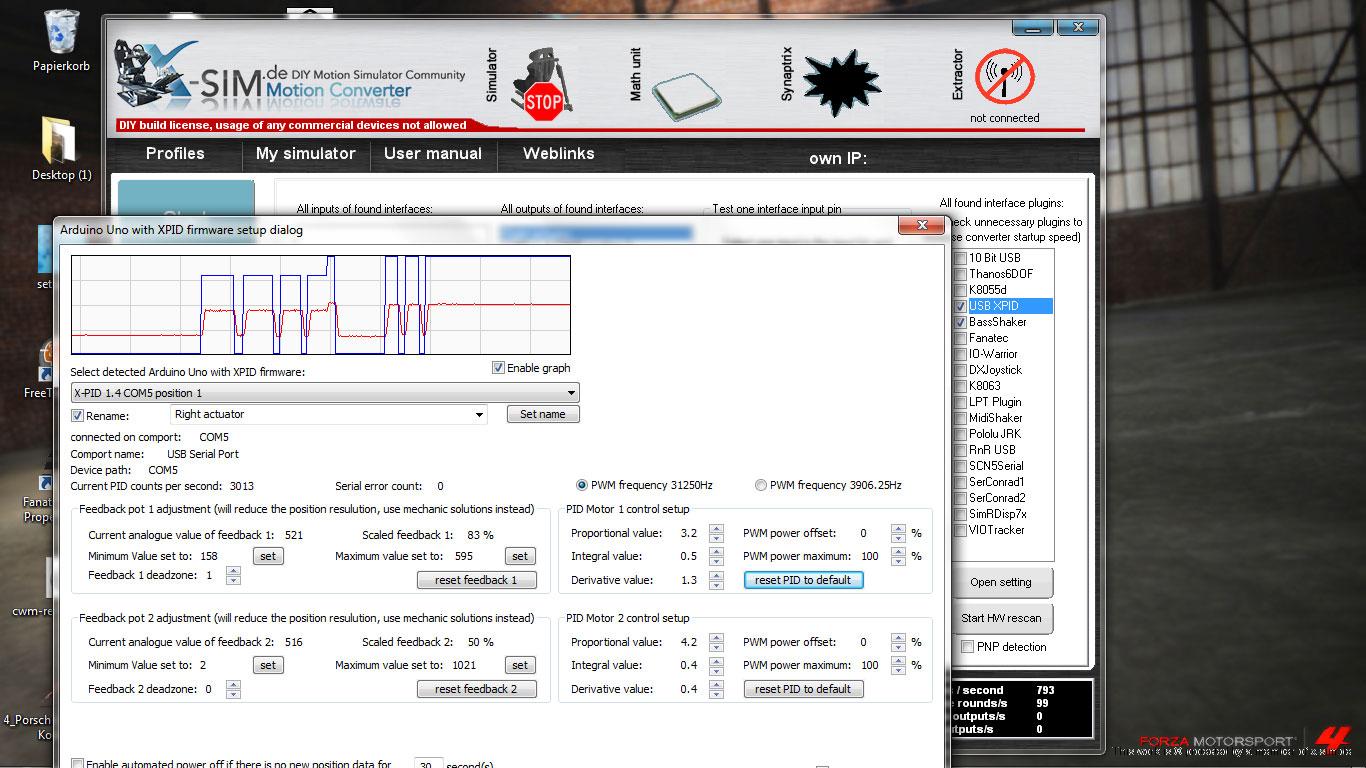

Postby Tombo » Sun 11. Aug 2013, 15:39
Hi,
i'm using arduino Nano with sirs Firmware. When i put a vaalue in the send output box my motor will move and stop at this position and is making a grinding noise. The pot signal gets very rough at this point so it's sendind left and right values all the time. So should i use an isolator? Can i use the sparkfun in my project?
