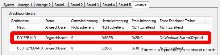

Re: DIY Steering Wheel Base
Postby dennisnojack » Mon 18. Aug 2014, 14:27
3136
Postby suckiden » Fri 31. Oct 2014, 00:04
is this project still alive, I am very interested and would love to see some results ;)
