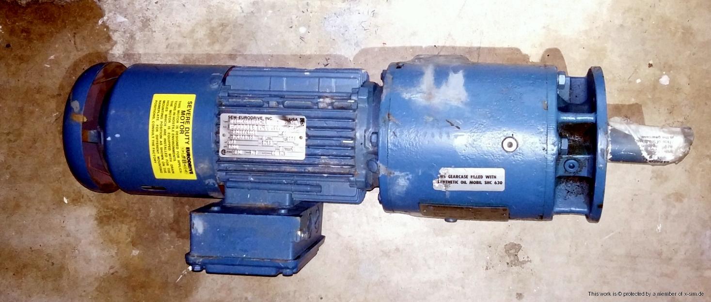

Not to revive this thread which has been dead for a while, but I finally purchased the motors earlier this year.
I came upon an auction, and I after considerations, jumped on it.
Work has been crazy and I am not very much at home unfortunately...
Nevertheless, I now have 7 (1 spare) SEW 0.75HP motors, with Helical gearboxes.
The gearboxes are 50:1 ratio, but I can slow them down a bit without affecting too much the output I will need.
I have over 150Nm per gearbox output. :D That should be enough, even slowed down.
They are all identical, and quite long at 25" from the back to the output flange.
The motors came without flanges, so I am going to have to build those first.
I intend to strip the motors and gearboxes, sandblast them and powder-coat them in Red, or Black.
I have a lot of work in front of me, but that should be fun.
