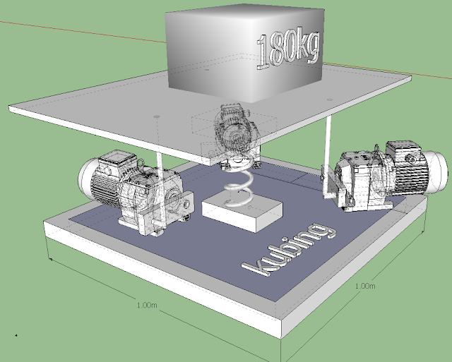

Hi guys,
After 3 years with wiper motors now i'm looking forward to re-design my sim and controller. After a lot of research and reading i decide to use gearmotor for my new sim. The question is How big the motor required to lift about 180-200kg weight at 60-80RPM? now i'm working on electronic part to make sure they are compatible with VFD. I use Siemens MICROMASTER Vector 6SE3212-1BA40 with 0.5hp induction motor for testing purpose. Please give me a suggestion :D

Thanks for the info and link. Due to compensate the pid loop refresh time i realy need a fast motor. My controller update the sensor reading at 1khz. Is there anyone use this motor SEW R27DR63L4? What is the model of your motor guys? 40 rpm 0.5hp?

Postby vicpopo » Sat 29. Sep 2012, 17:45
Hi Kubing ,
In this post you can watch a SEW R37DR63L4 with the specicifications:
http://www.x-sim.de/forum/viewtopic.php?f=39&t=132&start=160#p2011
In the other post for the simulator I made for my friend that are 2 SEW RF27DT71D4 0,37 kW with 38 rpm at 50Hz.
http://www.x-sim.de/forum/viewtopic.php?f=37&t=293#p2058
For simulator 2dof with 2 motors which a universal joint under the seat I know that 2 SEW R27DR63S4 0,12 kW gear ratio 100 (12 rpm at 50 Hz) are enough !!
In your case that is a 3 dof with lifting but with 0,37 kW or 0,5 kW . With 0,37 kW that is 3 times more that the 2dof with 0,12kW
I can't at this moment better help you as this post ( projects not yet finished!!)
The most difficult point is to choose the right gear ratio.The question is how many turns need the motor for running as well for our application.
For an half turn output gear shaft the motor make 50 turns with a gear ratio of 100 and so high is the gear ratio so high is the torque!!
If I can finish the 2 dof simulator I will have a good comparaison .I know that Riton has a simulator with 14 rpm at the output shaft.

Postby kubing » Sat 29. Sep 2012, 18:19
Thanks vicpopo and friends, tonight i've learn something from you guys. 0.5hp is our power range here. So i want to order next 2 driver for the motor. I better fast before its gone. 0.37kw x 3 with counter weight spring from bottom of the platform should be enough right? What is the rate of your driver?

Postby Riton » Sat 29. Sep 2012, 23:58
I have a 16 Rpm.0.55kw
