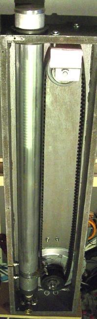

Introducing 6DOF diy motion platform for soaring flight sim CONDOR.
Using motors from old household vacuum cleaners on 100V DC (PWM)
3 bicycle pumps for wight compensation.
Navigation by XCSOAR on PDA.
See website:djippes.nl/hi6sim/index.html

Congratulations Douwe! You have found some new solutions!
motors from old household vacuum cleaners :o and many many other things, I got lost on your website!

This also looks a great idea, using an air cylinder to help support the weight, and not to complicated to build
2523
well done !!
