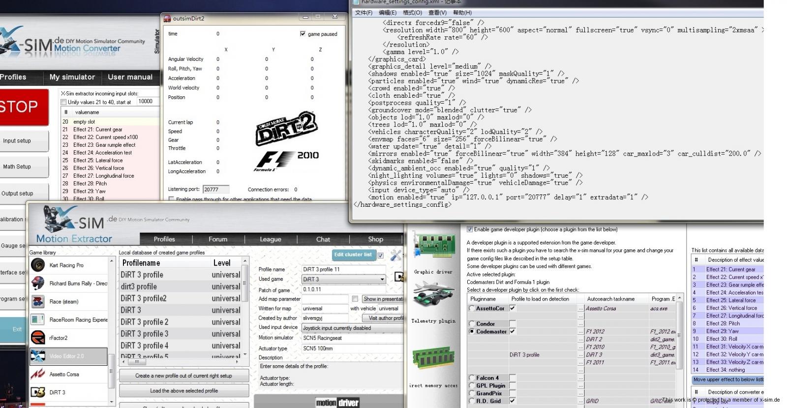

Thanks Sirnoname,I tried again.But still not work.
This screenshot as follow,Please help,Thanks again!
2052

Postby sirnoname » Fri 30. Aug 2013, 18:13
Seems all ok.
There are two hardware configs, one in the windows appdata folder, one in the game folder. You have to verify the one in the appdata.
Check your firewall.
In worst case, delete game, remove the appdata folder and reinstall it.
