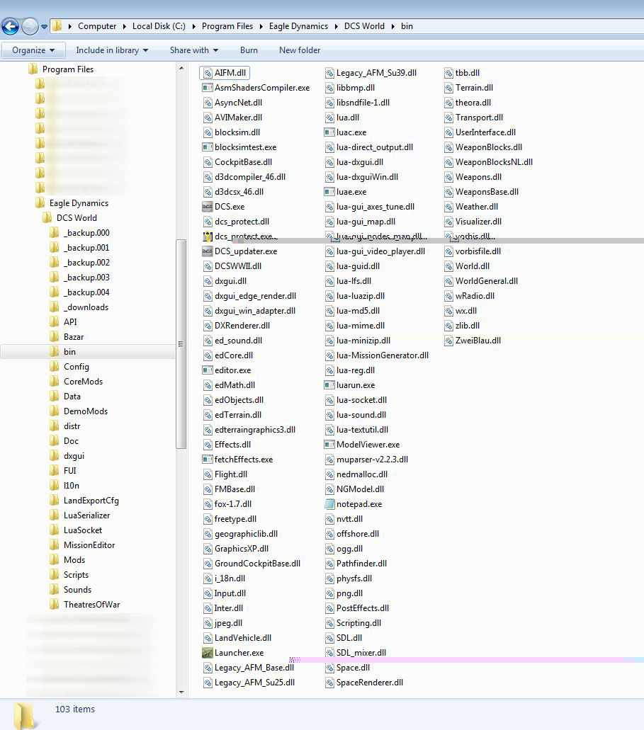

Postby laurivs » Mon 23. Mar 2015, 01:50
And this is how the non-steam DCS folder structures look:
