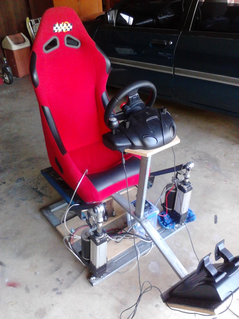

I have 2 sims currently, big worm gear motor and experimental brick actuator sim.
I have had to make different profiles for each sim and each game raced on it.
My foot motor sim is currently being used by a buddy of mine and he is having to make new profiles to suit him. Same sim, different user.
On race 07, the vertical is different between motor and actuator, mainly because of design of frame, not actual device moving me.
Without going off on too much a tangent. I found big motors set right feel the same as actuators despite being on different frames to actuators.
Obviously I will put big motors eventually on actuator frame to properly compare.
You can see the differences in frame design, so different profiles will have to be written.
I think there needs to be proper discussion for sure on this about profile making, as it is a LOOOOONNNGGG discussion to talk about.
But as said, profiles shared do help, but individual fine tuning is needed.

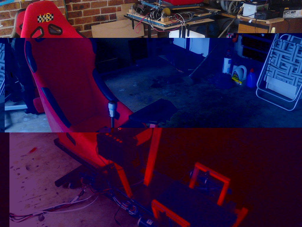

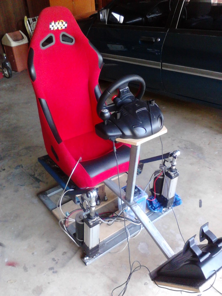

sorry to slightly hijack the thread, but pictures explain more........ ;)
