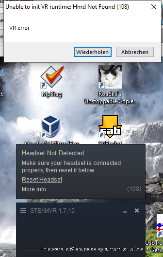

i am waiting for hardware parts so i used the time to get the software running. after several hours rfactor2, assetto corsa and competizione these programs send data to the extractor. i flashed an arduino nano with latest xpid.ino
then i tried to use the games with rift.
asetto corsa is runnig fine <- native occulus support
rfactor 2 has no native support for occulus i have to use the openvr interface.

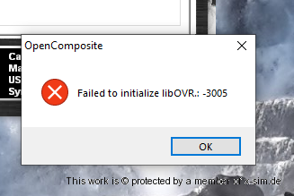

a) i used original openvr_api.dll -> steamvr is needed i get an error no vr headset found
b) usually i use a special version of opencomposite openvr api. i get an error too .
extractor and XSimRF2Plugin_64.dll dont like openvr / steamvr.
is there a walkaround ?

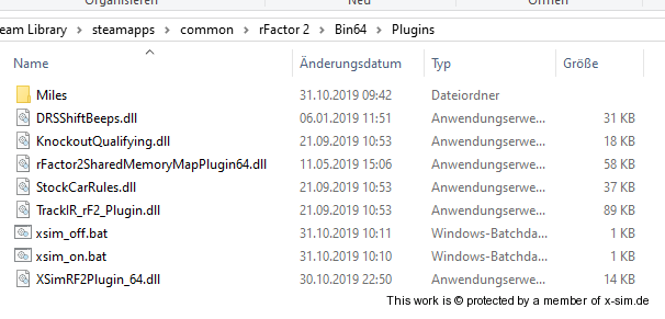

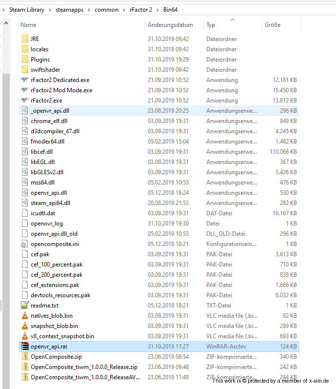

Postby JensGo » Fri 1. Nov 2019, 16:44
RF2 must like any plugin in its folder.
What is happening exactly.
i start extractor, converter is loaded automatically. i choose rfactor2 in extractor programm and press start button
rf2 is starting ---- rf2 launcher is ready,
when i start single or multiplayer mode i get an error and am again at the launcher
4771477247734774
i removed rFactor2SharedMemoryMapPlugin64.dll and DRSShiftBeeps.dll to check if there are problems with xsim plugin . i did not help.
when i deactivate the vr support and use single screen. xsim is working.
